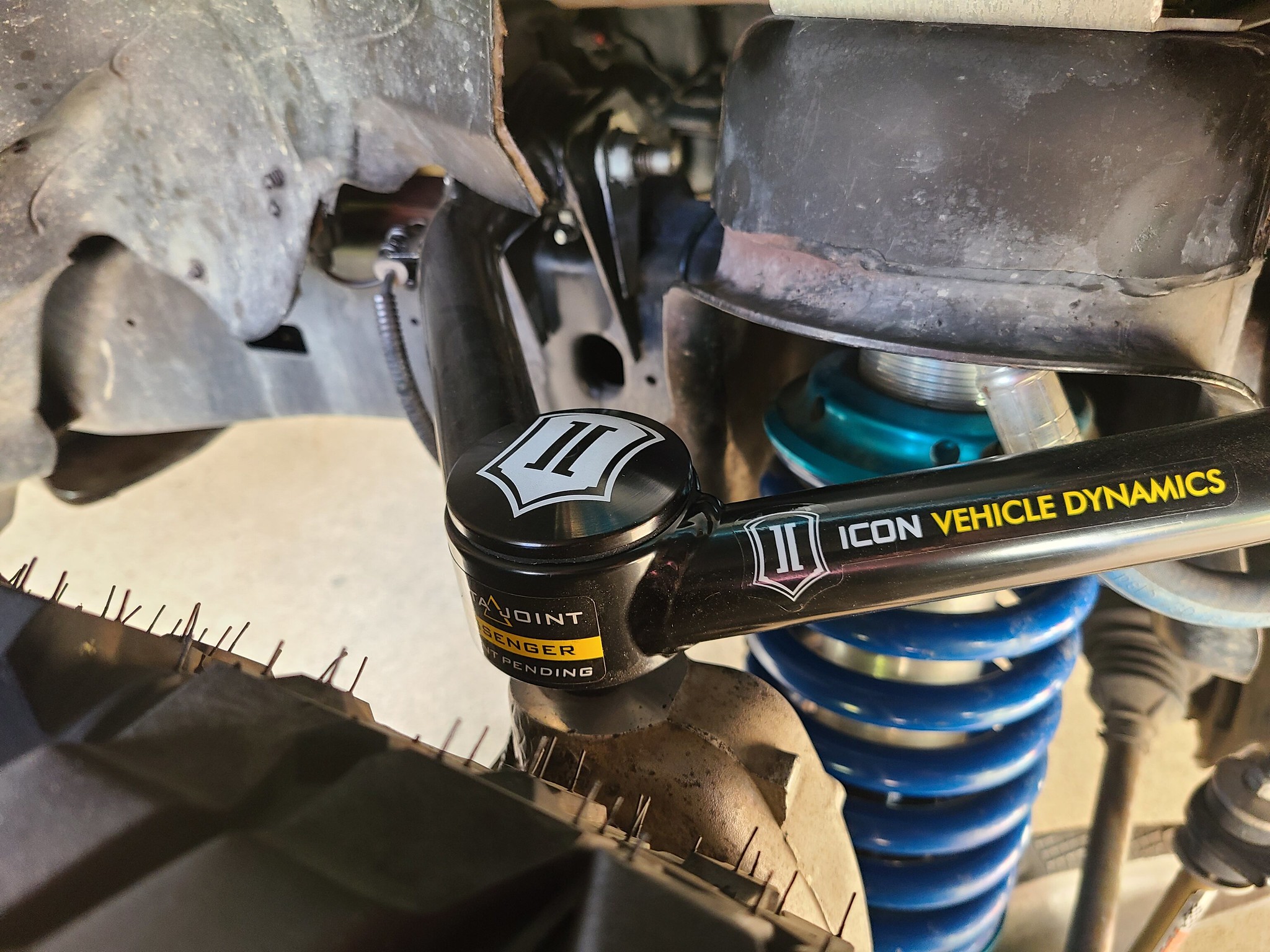

Check your PM. You may still need to wait the same, but you should be able to get them at a better price, and Icon will ship it to you. I got lucky when i bought mine back in Jan this year and the dude got me a set right away, got it 3 days after after i ordered them straight from Icon in Riverside,CA
Got the Icons caps as well even though they're not needed (separate order from Amazon :), https://www.amazon.com/191011-Tubul...con+191011&qid=1618968747&s=automotive&sr=1-1)
20210122_101259 by RAM RSM, on Flickr
