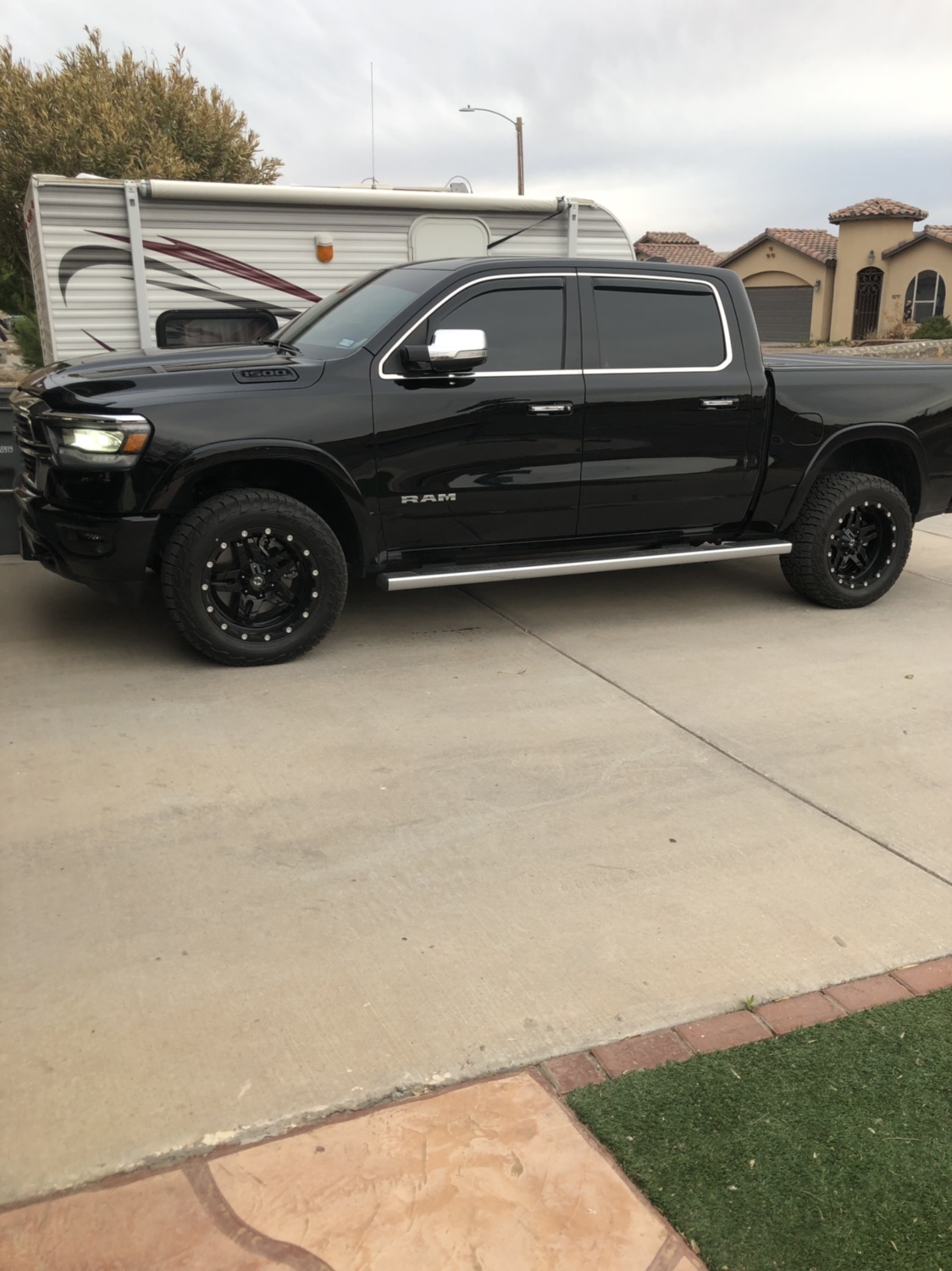

Can you show us pictures of your setup?
Also off topic how do you like the Backflip and how much was your ceramic tint?
skol
Mar 14, 2019
115
40
I like the Bakflip a lot. I got it off amazon. My son plays baseball and football. Much easier to leave all his gear in the bed and have it secured. The ceramic tint was $250. Living in El Paso I figured Id try it out due to the summer heat.
