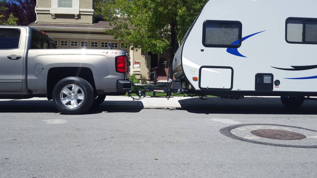

I have an E2 Round Bar WDH, and I love it. I really love the fact that I don't need an extra component for sway control, and I can pull the bars off to get tighter maneuvering, which I've never needed to do.
That's a pic of it on my last truck. I've also towed that trailer with my wife's 2018 Kia Sorento, and the hitch made the Kia ride far better than I expected.
