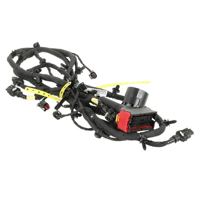

I am a newbie when it comes to this type of stuff so please be patient with me. Okay so I went through everything and I just want to make sure this is correct. Since I have the 2022 Ram 1500 Laramie Southwest with Park Sense front and rear and the 12” screen and already have the bypass up software upgrade for the parallel and perpendicular parking I need the following below to make it work properly.
1. New 12” screen with Lane Assist, Hazards, and Park Assist buttons - 1 (68526524AC)
2. Rear Fascia wiring to replace the old one with just the regular Park Sense - 1 (68360453AD)
3. Decoupler rings - 2 (68271824AA)
4. Park Assist Sensors to go on the Valance both sides - 2 (6MK25TZZAA)
5. Rear Valiance Left Outer - 1 (68404409AB)
6. Rear Valiance Right Outer - 1 (68404408AB)
7. Park Assist Sensors to replace the front bumper ones - 2 (5VY68TZZAA)
8. Parking Assist Module - 1 (68464880AE)
If this is all the right parts and everything I need my only questions would be which 2 front Sensors do I switch out? And where does the Parking Assist Module go? Does it just switch out from the same place where all the wires went to the old Park Sense Module on driver side under the panel?
In advance thank you so very much!!!!
You will also need the rear wiring harness that allows you to hook up the extra 2 sensors. The parktronics module is in the driver's side kick panel. And yes, you just replace it. If I remember right, it is the two front outer sensors.
Alright I think I got everything I just can’t find these dang rear wiring harness to hook up the extra two sensors in the back. You wouldn’t happen to have a part number or know where to go to find one? I’ve searched and searched everywhere.
68360453AD, WIRING. REAR FASCIA. [Rear Bumper Module], [Parallel and Perp Park Assist w/Stop], [Remote Proximity Keyless Entry].
