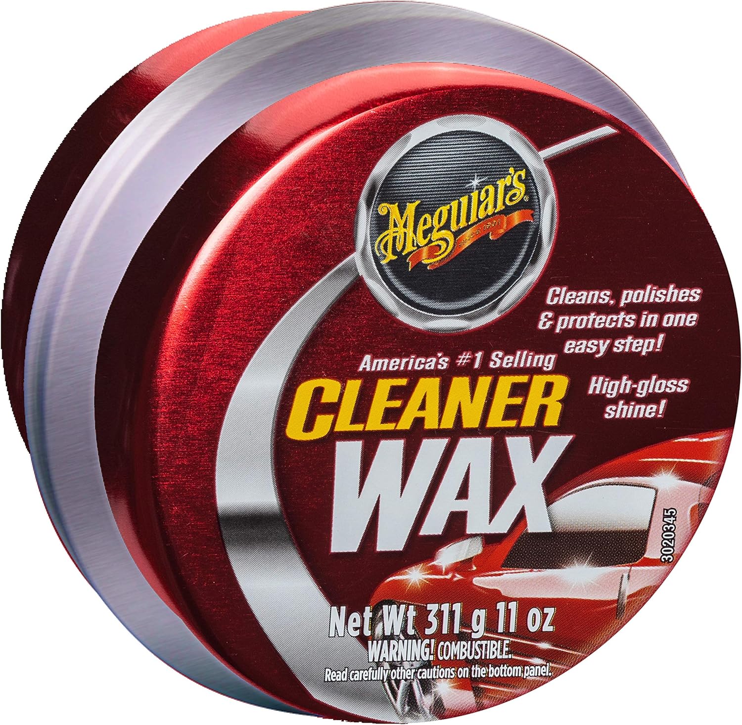

If it's pretty light-moderate, and looks it in the photos, my go to is Meguiar's Clearer Wax. $5 at Walmart of most other places.
I prefer the paste wax formulation for this, but honestly liquid works just as well. Use a clean microfiber towel and liberally rub it on each mark, use some elbow grease, it takes about 20-30 seconds of constant rubbing, but sometimes more, but if it's paint transfer or a light scuff on the clearcoat, it will go away with this method most of the time.

This stuff? If so, I have some out in the garage and will give that a try. Hoping to work from least aggressive.
Yup, that's it. It's a cleaner wax with no abrasion I believe, it's primarily a filler of micro scratches and a surface cleaner, but unlike most cleaners, it leaves a wax instead of stripping it. It's honestly the lazy-man's all purpose wax, polish, cleaner, scratch remover. If you check out the Amazon reviews of the link you posted, it's a very well reviewed product by a large user base.
I use it to spot remove minor scuffs and minor surface scratches, I've had the same tin for about 10 years and just recently used it to remove some scratches on our Toyota, it still worked great. Just make sure to use a fresh mirofiber or a very clean one so you don't actually make more scratches by rubbing the surface. Remember it will take some elbow grease, just a few seconds won't cut it, but I usually get it done with 20-30 seconds of rubbing.
That did the trick!
Man, I've had this on my shelf for probably about 10 years as well, and probably haven't used it in close to that long.
Appreciate the suggestion!

Absolutely, I knew it would work well for you. The only thing it can't do is a very deep scratch, but it does a descent job in cleaning those up at least. I mostly use quick-spray ceramic waxes these days since it only takes a few minutes and works on all exterior surfaces, but that's only for protection. When you need to take out a minor scuff or scratch, these classic cleaner waxes still come in really handy.
Also works well on non-car stuff, like the top of my snowboards in cleaning up snow stained surfaces and leaving a nice protective shine.
