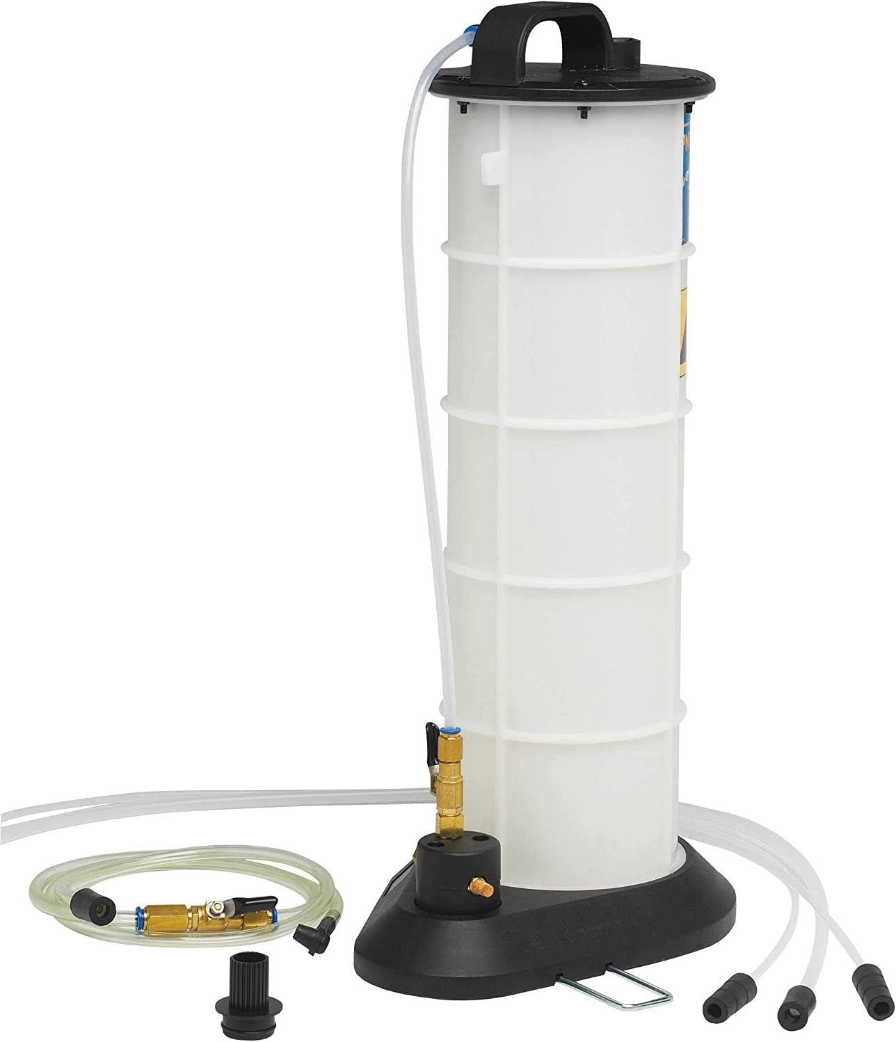

Has anyone here with the 3.6 personally used an oil etractor like the EWK? My concern is that all/most of the oil is actually extracted. I’m trying to confirm the hose will get to the bottom of the pan and not be obstructed by a baffle, etc. TIA.
I have a Mityvac PneumatiVac (air compressor powered) pneumatic fluid evacuator. It has 3 foot hoses that you stick down the dipstick tube to get into the sump.
I haven't used it on the truck but I have used it on my wifes Jaguar XF which is the preferred way to change the oil and it siphoned all the oil out. Its slow though.
On my truck, I'd simply crawl under and remove the sump plug bolt, the jaguar has a splash shield with about 7 million attachment bolts, its easier to not have to lift that car, remove those bolts then the splash shield then drain the oil then reverse. I simply plug the extractor hose into the oil fill siphon tube, connect the air hose and walk away. 30-40 min later its drained then I just change the top mount filter and pour in the new oil.
If the 5.7 had a top mount filter like the V6's do, Id use the extractoer and do something else while its working
