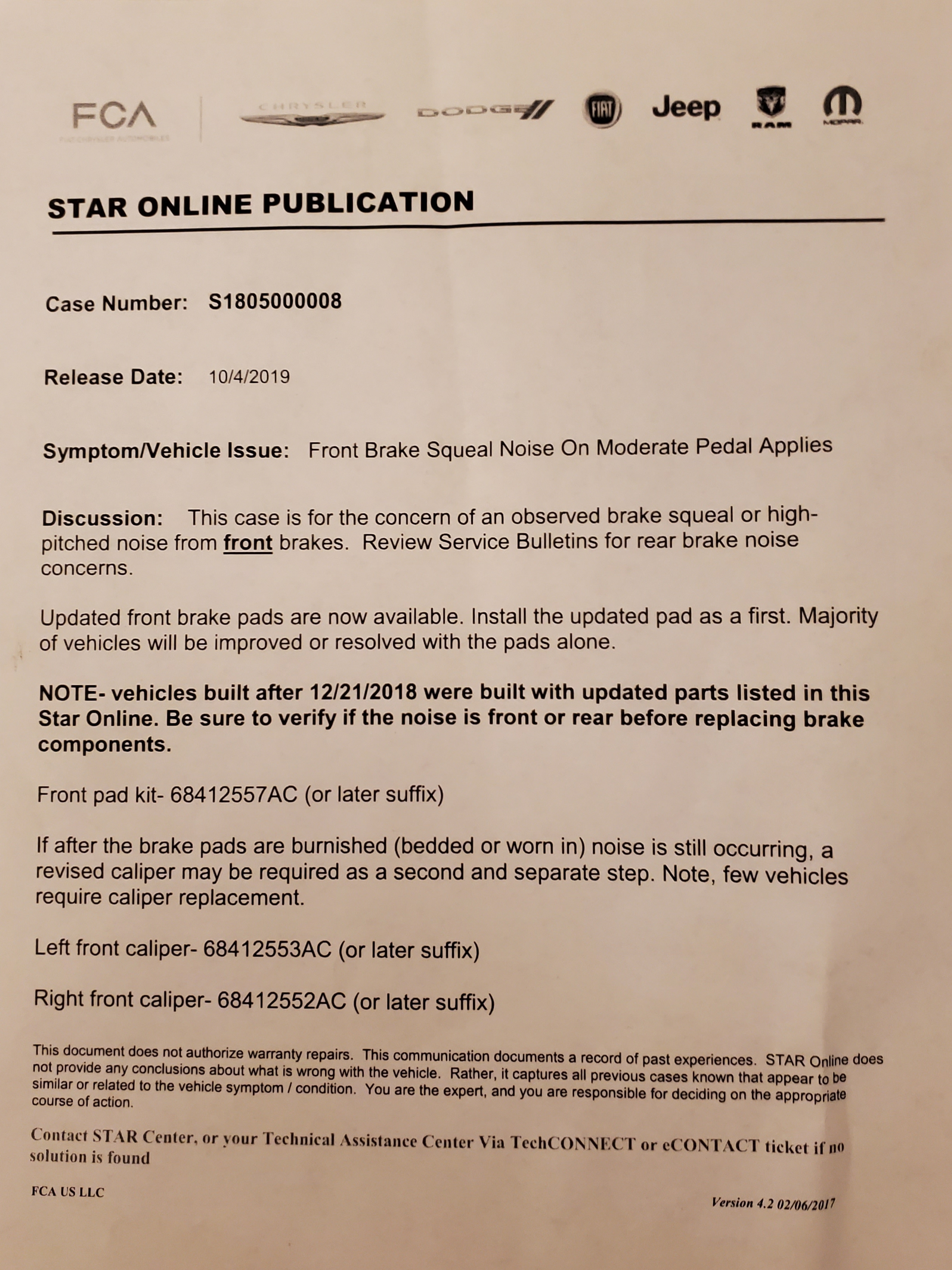

I know this started off with running board topic, but if it's anything like my noise I hear, could be what neurobit said.
I've had the Case number done on my front brakes already. The brakes don't squeal like they used to, it just a chirp or rattle sound. Over small bumps, it now when I give it a quick press on the brake I can make it do it every time after accelerating.
Stopped off at the service center and spoke with guy I always do. Afterwards he went to pull the Case number and made sure they had the calipers. No appts for 3 weeks but he said drop it off to him next Tuesday for the day and he would get them replaced! That's service.
Here is the star number in case anyone needs it.
