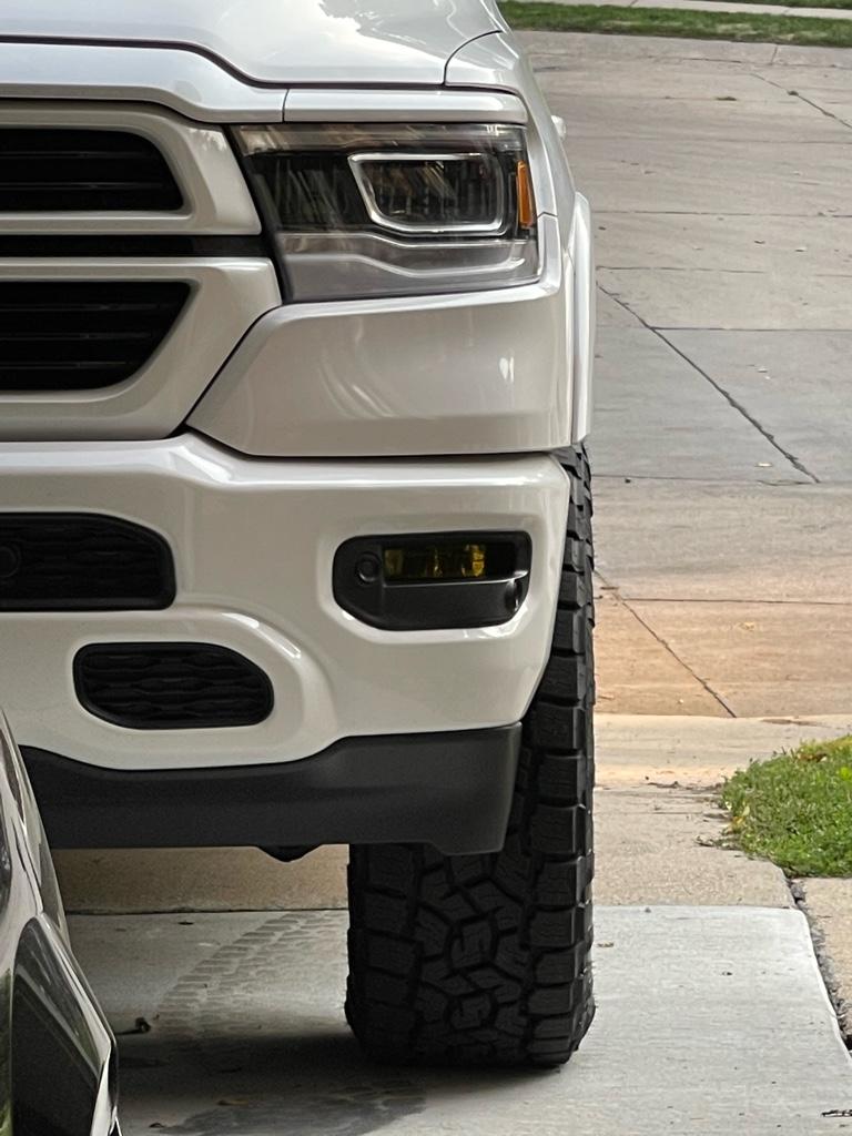

Little update. Put on a set of Ridge Grapplers LT295/65/R20 (35.12x11.77) yesterday. Haven't put but a few miles on them so far. Should see 320 miles in the next 4 days with the work commute. Bilstein 6112's at #8 up front and ORP Springs in the rear. About 19K miles on the Bilsteins and ORP Springs.
