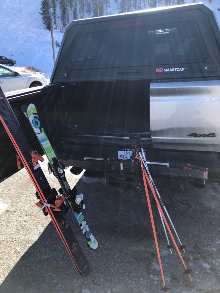

I don't know if that's true. The MFT has a lower bar that connects to the pivot points on the bed, just like the regular tailgate. The swing out option latches to that lower bar. The upper sections latch onto the same latch points as a regular tailgate.
I looked at one last week and it appears that the entire MFT system can be installed on any regular width bed. You can see the lower section, and the side section in this pic.
