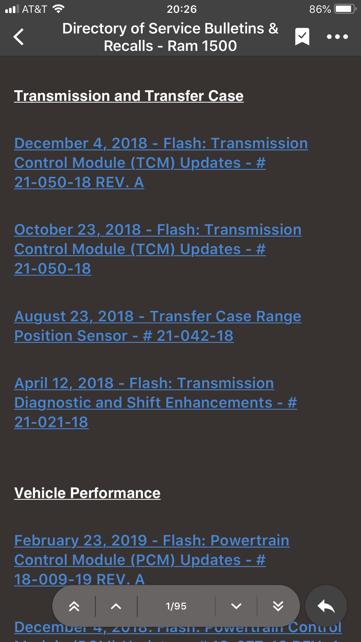

There are TSBs for the transmission.
Several updates.
Take it in.

Can you say more on this TSB. I've searched and can't find anything.
SynAckuL
Jan 5, 2019
138
123
Thanks for the information. Two questions:
1) My build date is outside of those ranges and/or my engine does not match. Can I safely assume that the TSBs do not relate to my problem then, or are there cases where the TSB should still be applied?
2) Is there a way to see what TSBs/updates have been applied to a particular vehicle, outside of going to the dealer?

1) bring it in and tell them your issues.
2) not to my knowledge
They automatically check for updates when brought in for service.
