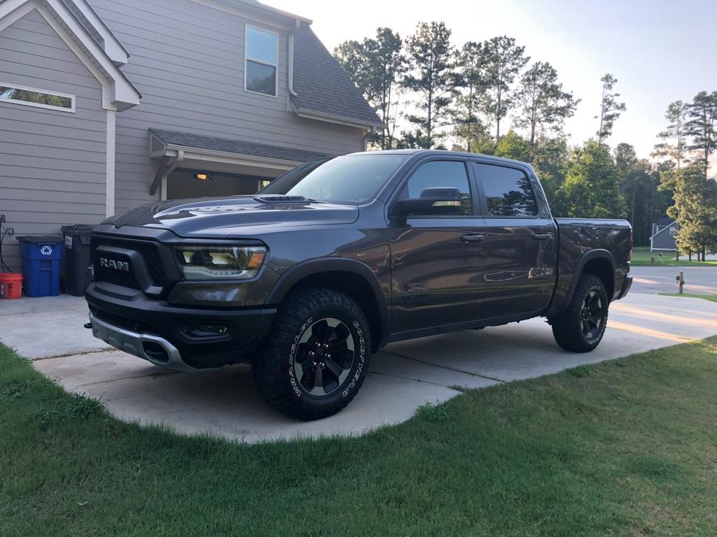

Hey y’all, long time listener, first time caller. Before I posted this question I scrounged the forums, YouTube and basically reached the end of the internet looking for my answer. I think I found it but, I want to make sure I’m not missing or overlooking anything.
I live in Georgia and own a 2019 Rebel with coil suspension. I’m an avid mountain biker and go into the Blue Ridge Mountains rather often. Many of our trailheads are pretty remote. The extent of my off-roading is forest service roads and the occasional rutted out trail. Maybe a few bigger rocks here and there.
I’d like to lift my truck to fit 35/12.5R18’s. The local off-road shop recommended a 3.5” Readylift, another shop recommended the BDS 4” (I can only find that for air suspension?), and the local dealer went with the Falcon. All solid options and honestly, I’d rather go with the Falcon because I do tow occasionally. However, my gut says to go with the Fabtech Dirt Logic.
I don’t mind the more expensive options because I’m a big believer in but once, cry once. But, I also wonder for my needs if those options are overkill. The truck is perfectly capable in its stock form but, I just can’t leave well enough alone!
So, I put the question to the brain trust, what do y’all think I should get? Thanks!
