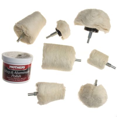

How do I keep them shining, because soap and water isn't doing the job. Do I purchase a polisher or a adapter for my drill? I also picked up some white diamond and mothers wheel polish.

I bought them new and don't think there was a coating on them. I've been watching some videos on youtube on how they sand and polish forged wheels and it doesn't seem too bad.
you shouldn’t need to sand anything unless there is extreme oxidation. It’s worth trying mother’s first, preferably with some drill polishing pads like trooper mentioned. I remember setting aside 4 hours every Saturday for polishing the Weld wheels on my first vehicle (an s-10). It was pretty miserable since all I used was an old t-shirt and mothers polish.
I went through this and my experience is there is no easy wipe on/off to keep them shining. Luckily getting a buffer with some buffer wheels and polishing compounds makes it easy. I even used sandpaper to take so.e scratches out then stepped it with the buffing wheels.
You can try to coat them, but with the heat and iron it won't really keep the shine. It takes some elbow grease, but nothing looks as good as fresh polished wheels. Screenshot_20221224_191105_Photos.jpg Screenshot_20221224_191143_Photos.jpg
