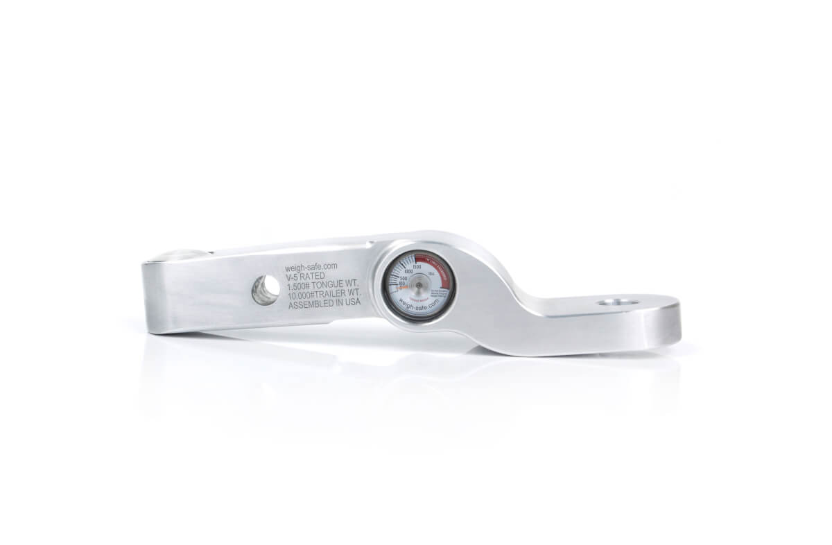

I am moving from a 2500 to a 1500 (on order...) and as I peruse the forums, I have become aware that tongue weight is critical for these smaller trucks. Has anyone used the receiver hitches on the market that have a scale integrated into them? I am curious as to the accuracy of these units. Any recommendations?
The max trailer I plan to tow is about 6K. I would like to be able to know the tongue weight and load the trailer for best results.

I was about to purchase one but then started looking at reviews. Tons of reviews that state the load gauge fails after a short while. Even the warranty is very short on it.
Ended up sticking with a dumb hitch.

Better to get an eTrailer or Shureline hitch weight scale if your concerned about tounge weight. I have the eTrailer and was worth the investment. Even with my non-standard hitch (ProPride/Hensley) I can still measure hitch weight using the tounge jack.
The weight safe hitches are good, but a dynamic load is going to eventually cause issues with the hydraulics

I purchased one of these Weigh Safe Hitches.
The price difference between the $!00 and $125 versions is if it comes with Ball Already.
I have a 2 5/15 SS ball to go on mine so i got the cheaper version. I also have a 2" SS Ball.

I’ve used the Weigh Safe 6” drop hitch with scale for well over a year and I love it, the scale is pretty accurate from what I’ve found, it is a bit pricy but well worth it to me, it’s saved me a few times from being way over payload.

It's an interesting concept, but it looks like they made no provision to lock out the gauge once you've weighed. Seems to me that bouncing around while driving will be very hard on the gauge and possibly cause pretty quick failure. My thought was that you could use one of these while loading, but swap in a solid hitch for the drive.

Yeah that’s a good point, I don’t know how many miles I’ve driven with the hitch, probably only a few thousand last year, still seems pretty accurate. If you want a scale for just a reading I think something like this might be of interest!
