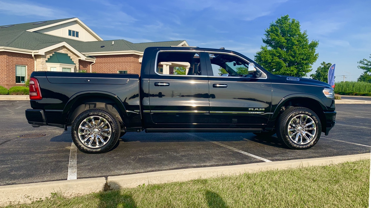

Never been a big fan of huge wheels and my limited came with pimp daddy 22’s and street tires. I haven’t quite found any aftermarket rims that i like as these days most rims are black or black with accents which won’t look good with all my trucks chrome. So, I either pony up almost $400 a wheel plus tires for the dodge wheel I like or I can grab a set of GMC take offs for about $600.
Has anyone had any experience doing this...? Any foreseeable issues ? Looks ? Towing problems ?
1st pic is my rig with 22’s. (For sale by the way)
2nd pic are the wheels I want.
3rd pic are the wheels from a 2019 GMC.
Any input is appreciated.....

That GMC Wheel looks like the OE Performance 176. A set of the OEP wheels will cost you around $1350; so $600 for the GMC wheels isn't so bad. You just want to make sure bolt pattern is correct and offset is to your liking. You can do an offset comparison at Tiresize.com. You will probably need to get concentric rings as well.

GMC used to use a larger positive offset, +27 versus +19 for most of the ram wheels. They are going to bring the tire further into the wheel wells by 5/16" and narrow the gap between your upper ball joint and tire sidewall. Something to keep in mind when choosing tires. you might want to check the offset on the GMC wheels and confirm. There should be a a stamp in the casting that will say ET+27 or something along those lines. Gm may have changed their offset for the 2019 trucks but those wheels look identical to the ones that came on my 2015 GMC.
Thank you.... I did the comparison already. The tire is a little taller but skinnier. If I like them I’ll probably get a wider tire....
I’ll go look again but I was told they were a 18mm offset. If I go for it I’ll post a test fit pic. Thanks all for the info.

So this truck has the 22s, is the hub size still the same as the other trucks? And is it smaller than the GM hub size?
Because if the ram has a larger hub than the GMC, and the GMC wheel is hub centric for that size, then it won’t work? You can use the rings to bring the wheel size down to match a smaller hub on the truck but you can’t go the other way?
Edit: looks like the gmc is 78.1 (at least the older ones) and ram is 77.8 so you should be fine. Unless for some reason the 22” wheel trucks have a larger hub size.
18mm makes sense Gm moved the upper control arm up on the 2019s so they probably pushed the wheels out to clear the upper ball joint. The previous trucks had the upper ball joint much lower below the the lip of the rim so they could away with a lot of positive offset

Wow.... great deal. Good for you, I think they're the nicest wheel of the bunch.
On another note, talked to the shop today and they confirmed it's not worth the hassle. Turns out wheels would be $800 and i would still need hub rings to make it right. AND the offset is indeed +28mm. That's going the opposite direction of where I want to be. Back to the drawing board....
