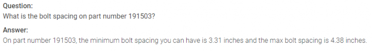

The bushing fit the sway bar just fine, but the bolt holes were not spaced far enough apart. I am going to see if they fit my dads Silverado before returning them to Amazon. Those can have 32mm, 34mm or 36mm sway bars tho.
Sascwatch
Feb 17, 2020
1,052
587
Looks like the prothane bushing is the way to go.
