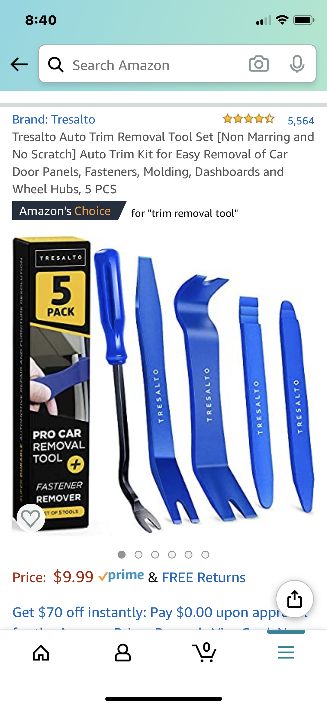

How do you remove the whole piece ram letters and the backing piece. I want to make something to completely remove the ram letters
These were very helpful with the badge work I did
