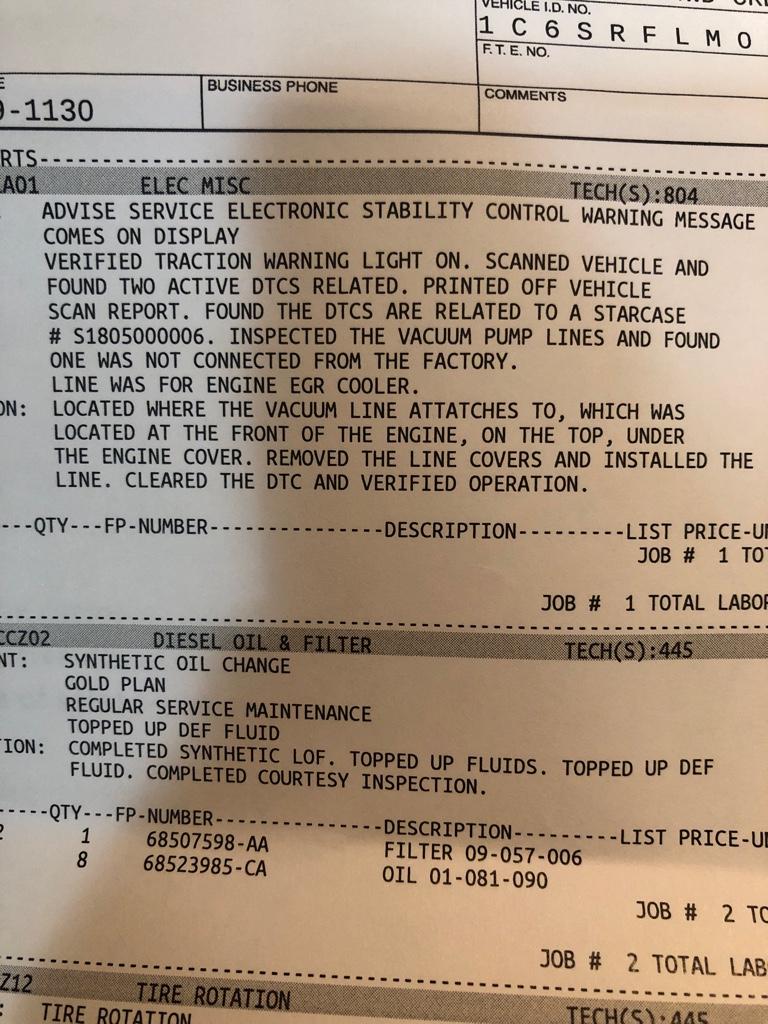

I had this with no lift and it turned out to be a star case where a vacuum line was not connected to the front of the engine.

Mine was fine for the first few thousand miles too, then the Service ESC came on. Solution above.
