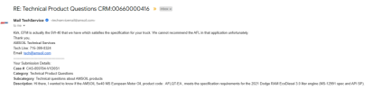

Hey guys, thanks for all the feedback. I emailed AMSOIL's tech support team and they provided the following info :1745509588987.png
Hopefully this clarifies some things for a lot of us on AMSOIL products. Take it as you want. The oil they are mentioning in the email is their 5w40 FS European Motor Oil.
