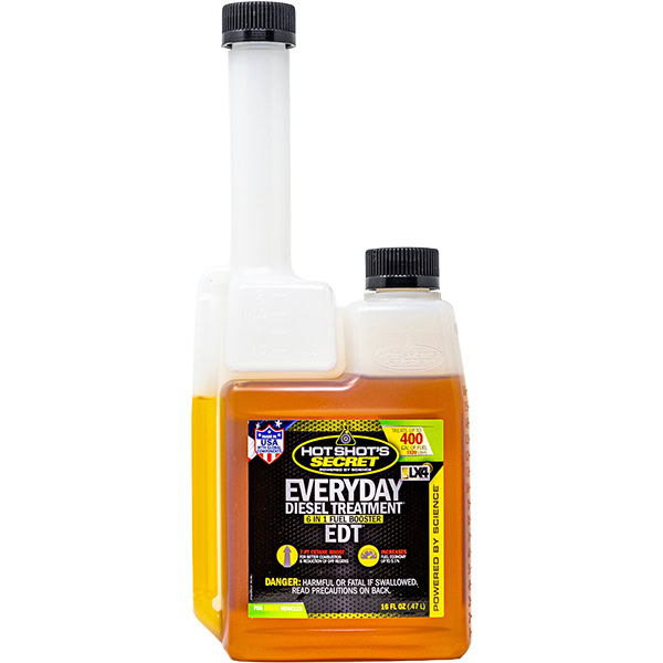

just ordered my self some thx for input can i get a picture of item to confirm its the right one 😂🤣

Hopefully, I am not violating forum rules, this is the link to the product on their website different bottle sizes look a little different. Just make sure it says "Everyday" on it. You do not want the "Extreme" that is a once an oil change kind of treatment to clean the injectors.

ok got it lol thx you can remove it if it does violate anything. i purchased the right one :)
