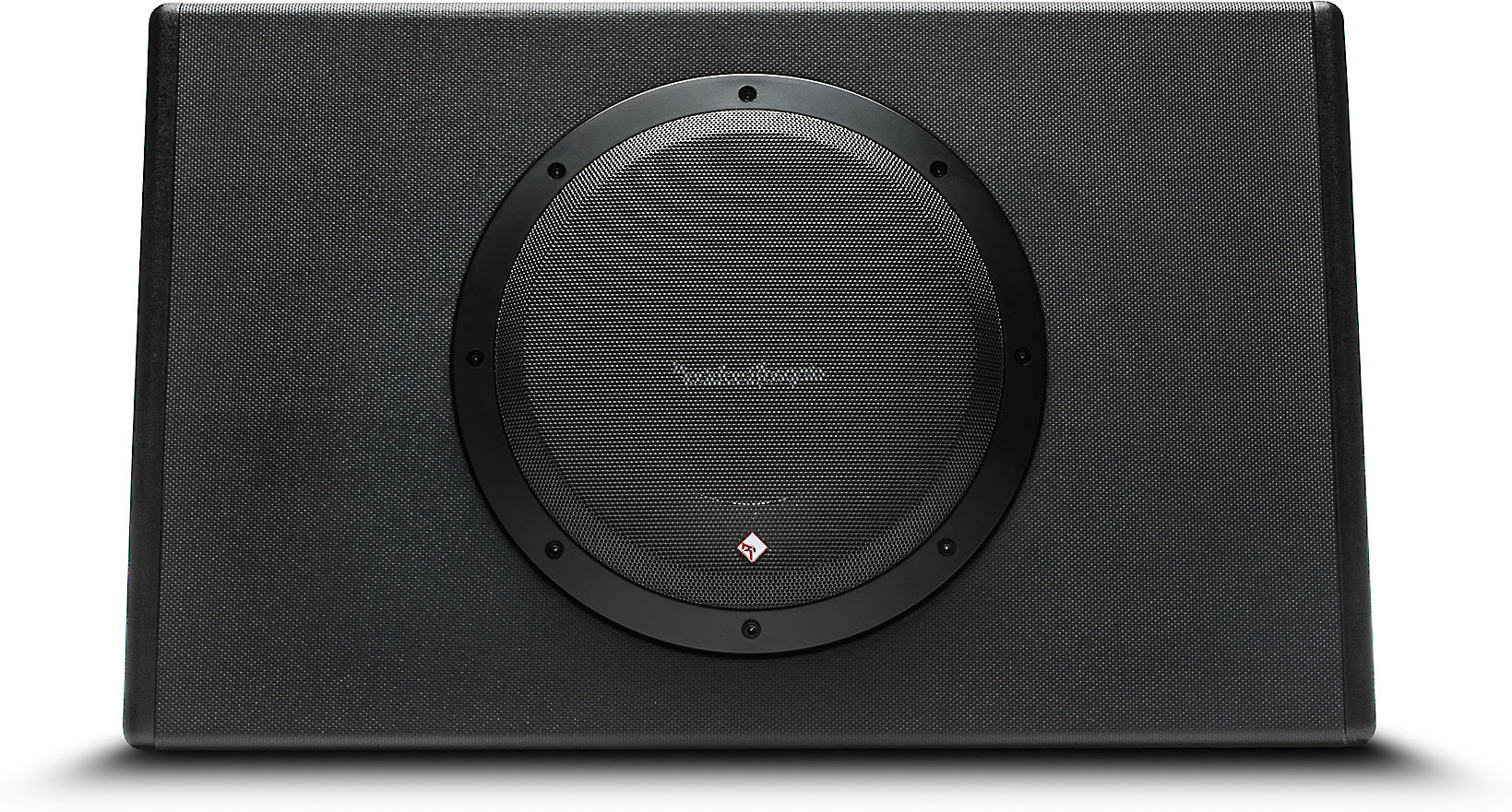

i took my out.you can buy the underseat kind.it has and amp built in them.and they can fit behind the seat.some work.but if you want to get the sound and space you want...

I think the only way is to get this
and then get a powered sub in a box
is the easiest and hassle free way.
