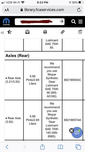

FCA has updated the gear oil recommendation from the information printed in the owner's manual, but only for 3.21/3.55 rear axles. Previously, there was a special gear oil (MS-A0160) for the 3.21/3.55 C235 rear axles on 2017+ Rams which was part #68340460AA. The FCA Tech Authority site now lists part #68218655AC for the 3.21/3.55 rear axles plus 5 oz of friction modifier. Part #68218655AC is FCA's universal 75W-90 gear oil which is "For use in all FCA US LLC corporate axles" and is spec MS-9763.
The FCA Tech Authority site lists oil capacity as 5.68 pints plus 5 oz of friction modifier for 3.21/3.55 differentials equipped with a mechanical LSD. By volume, this is 5.5% of friction modifier.

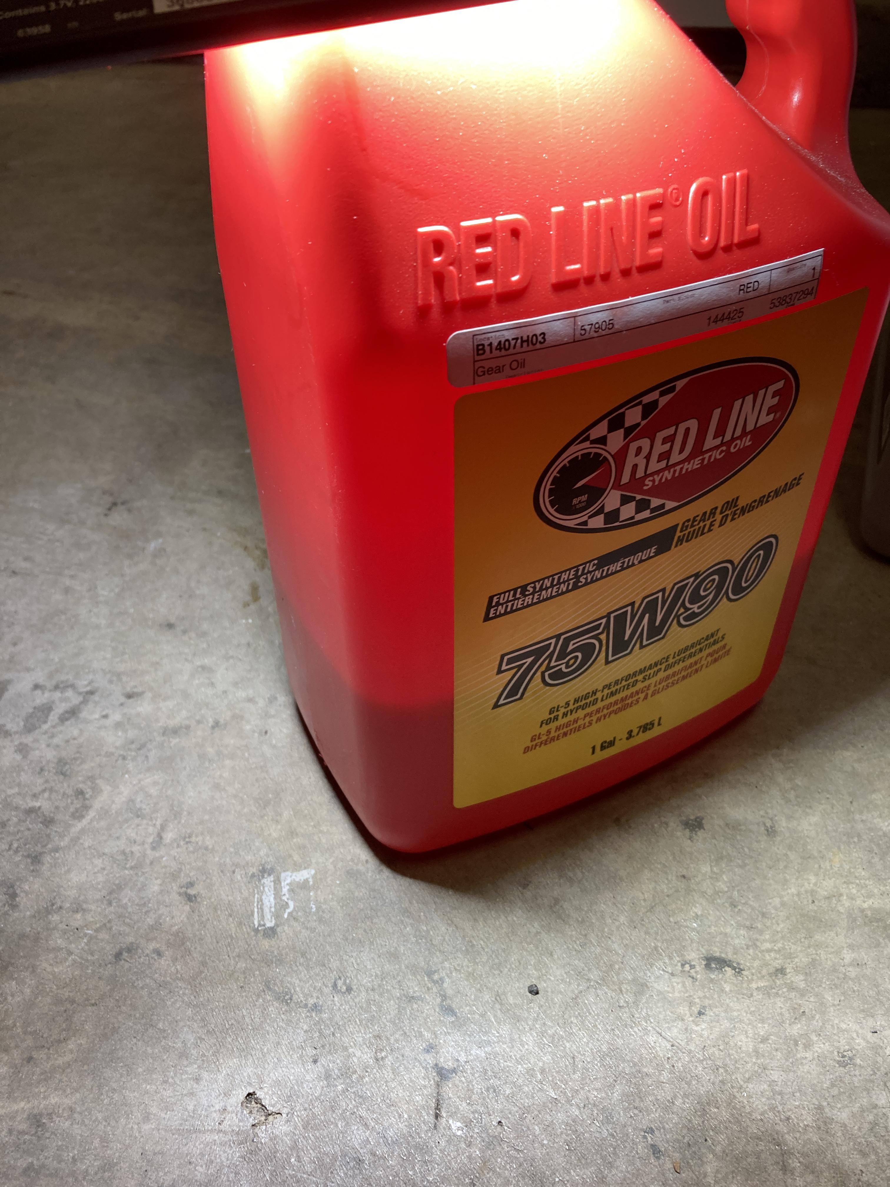

I contacted Redline's Tech Dept and was advised that their 75W-90 contains 5% of friction modifier by volume. Amsoil and Mobil 1 declined to provide any specific information on the quantity of friction modifier in their gear oils. Redline's 75W-90 is suitable for use in applications requiring a FCA MS-9763 spec gear oil.

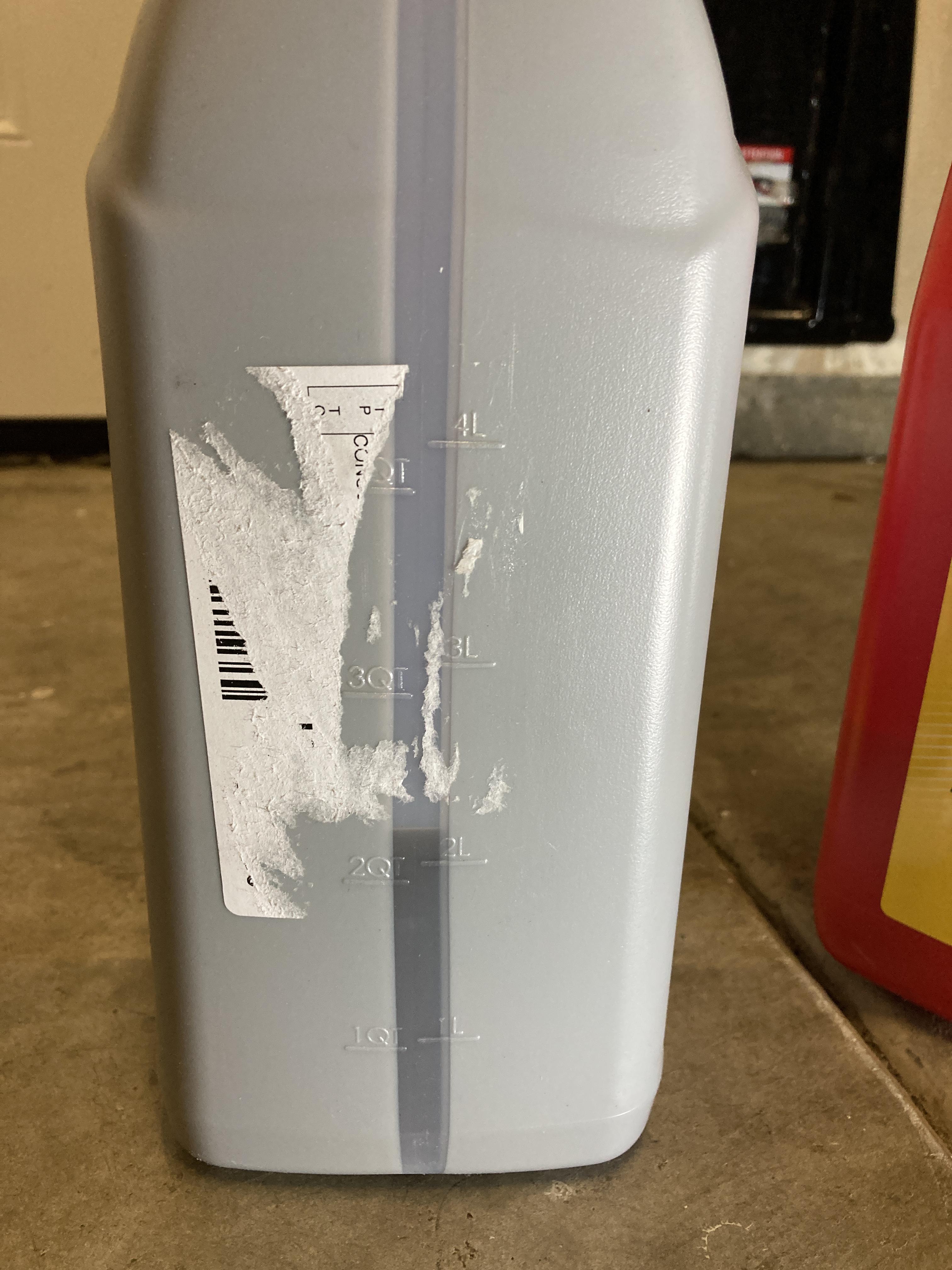

I used approx 2.5 qt of Redline 75W-90 for the refill. I drained about 2.2 qt from the rear differential. So far, I have not felt any chatter on turns after 60 miles of driving, but I will update the thread if I do.

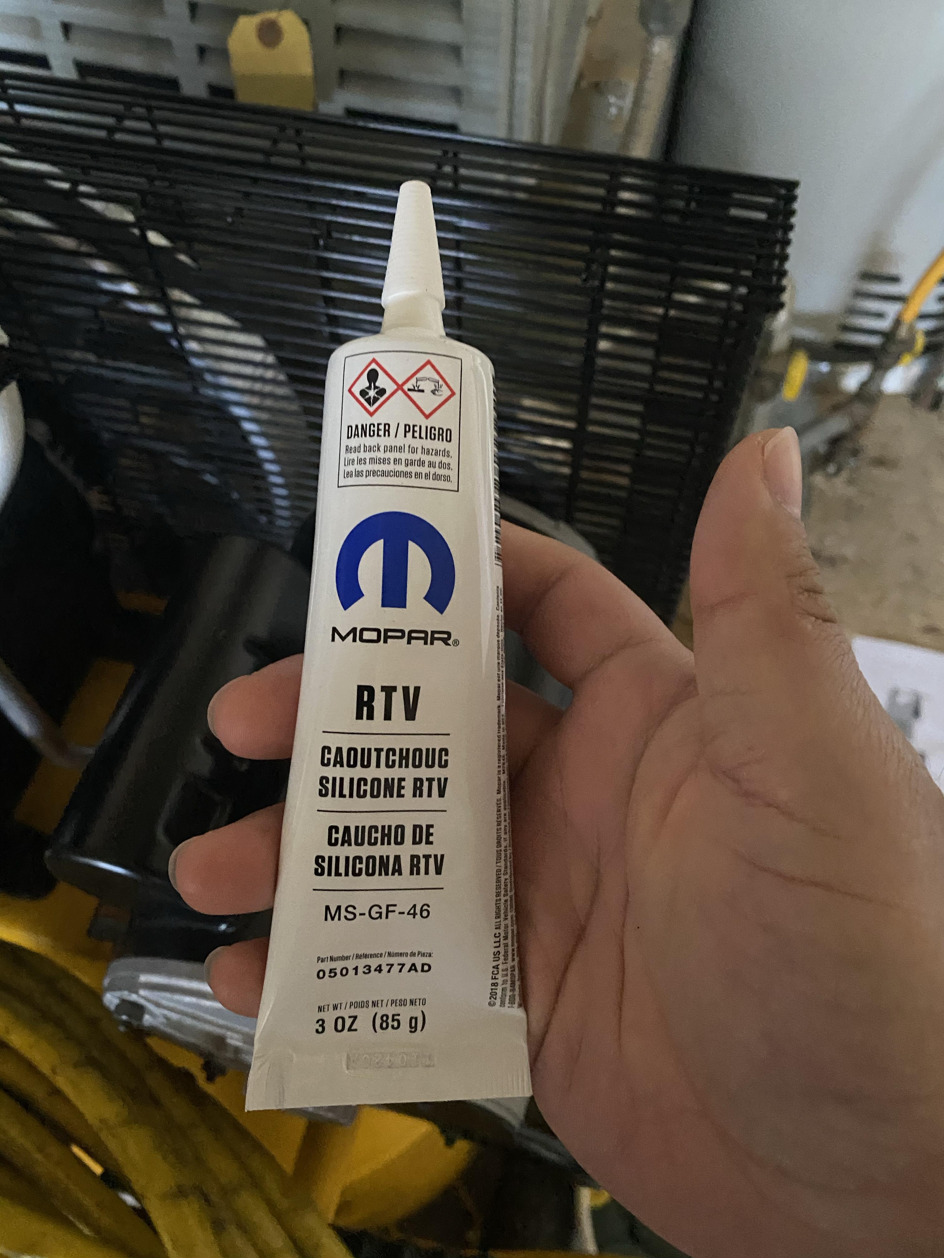

If you can find that special gasket maker, use it ^^^^
If not, I've been using the Permatex black for the past 25 years and I've never had a single leak or issue.
Same here, used permatex black or the ultra blue on my diff many times
