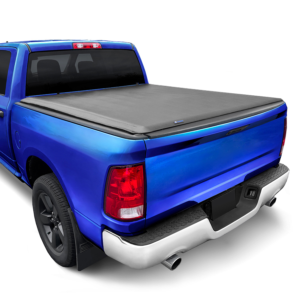

I finally returned the Rough Country tri-fold to the reseller and he didn't argue to refund it and cover the return shipping. Since Rough Country themselves confirm that this product is not compatible it's just the common sense.
Instead I just placed the order from the well reputed brand, TYGER AUTO, for an hard aluminium tri-fold cover PN# TG-BC5D1044 specifically for the 2019-2020 RAM 5th Gen, from Amazon Canada (not from a marketplace seller) and I had the most unbelievable deal, thanks to Amazon's lightning deal.... the MSRP for this cover in Canada is 1108$ CAD and I pay 475$ CAD!! Ship & Sold by Amazon Canada, no mistake, no fake! Yes, it's near of 60% OFF! :oops::oops::oops:
It's not a super low profile aluminium cover like the BAK Flip, but in Canada the BAK Flip sells for nearly 1500$ CAD... so for a third of this price I can't imagine a better deal for a hard aluminium cover!
