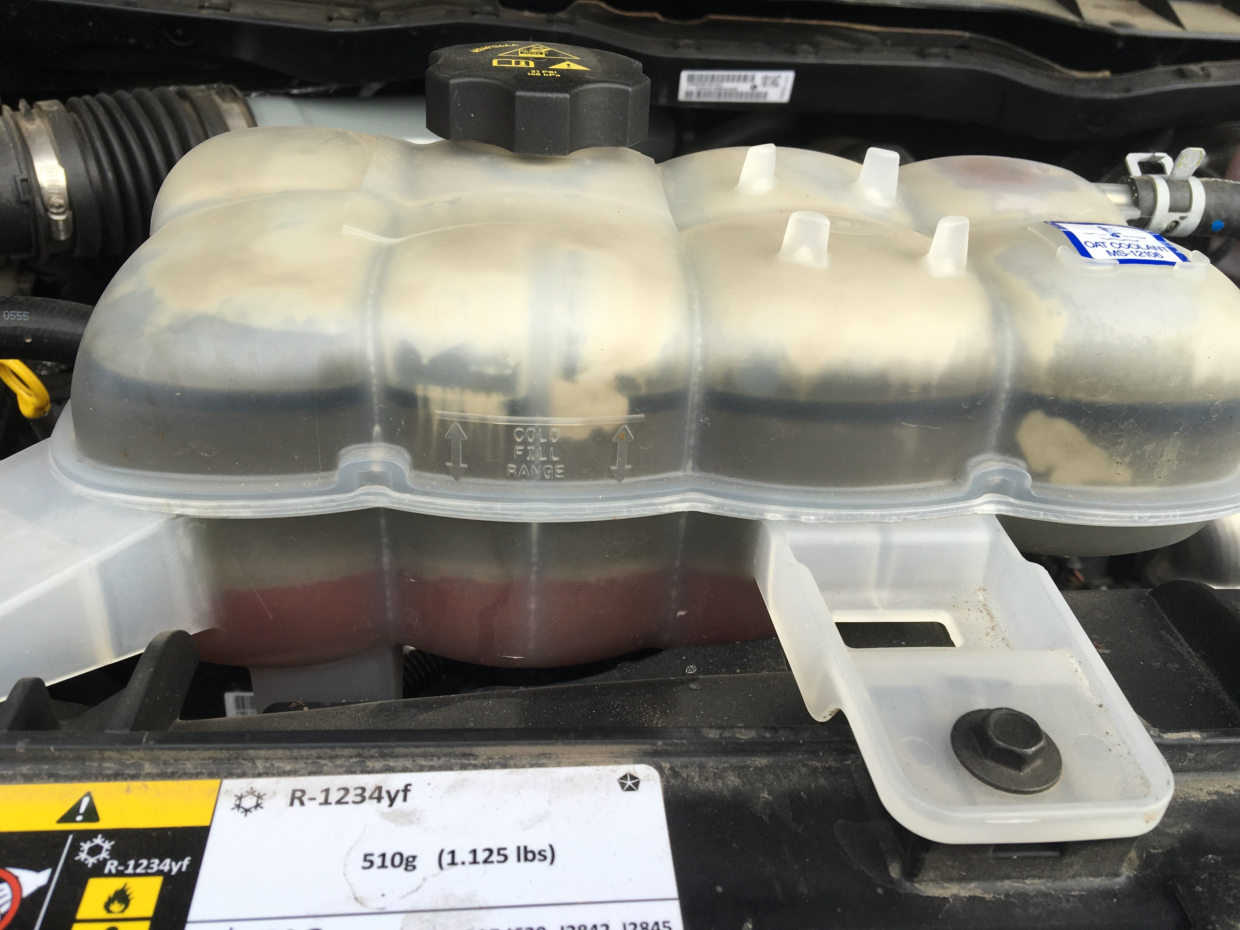

I picked up my new 2020 ecodiesel a few days ago. When I was at the dealer I popped the hood and saw that the antifreeze was a purple color, the truck had 60 miles on it. I just drove it about 200 miles and popped the hood and the color changed to a pink. My question is this right? With all the new coolants out there I am not sure if this is the color after running it or I have an issue like oil or something leaking into the coolant. I did send an email to the dealer and will follow-up with a call on Monday when they are open but thought I would try here to see if I indeed have an issue. Pic attached

Just checked mine. Same deal so I'm guessing it's normal.

Thanks, that is reassuring - I'll assume it starts as the purple and then fades to the pink with use, still curious what the dealer will stay. All temps are correct or similar to my last engine and I now have 400 miles on with no leaks or changes so that is still a good thing. I will admit I do love the new engine over my 2016 Eco Diesel, Too early for definitive results and still in the break-in period but so far I am getting 4-5 MPG more than the previous model (though I do not have all my accessories on it yet). Definitely a new look under the hood, time will tell if they truly improve it over the previous generation.

An update from the dealership - That is a normal outcome. Heat cycles and how the engine circulates the fluid will cause the color to change. Lets me sleep a little better though it will bring to question do you add OAT orange or OAT purple (MOPAR?). A decision for a different time and hopefully not one I will have to make.

Yep, this question has been asked by people for the last six years...it's completely normal. Now lets hope the bad oil coolers are behind us and we never see black coolant again
