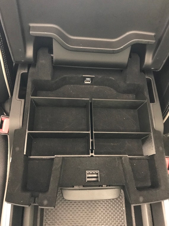

Center console organizer: (Holy crap, you could fit a toddler inside the organizer, but damn stuff tends to slide around)
All components are made w/ 1/4" ABS plastic. You can buy sheets online. I pre-sand them then use superglue to attach the pieces together. Once a section is fully fabbed up, I laid plastic epoxy into the corners for strength. After a night of curing, a few coats of Plasti-dip coat the whole thing.
The Upper console Lid has dividers for pens/tools/measuring tape...things I grab multiple times per day.
The lower console has 2 sections. When installed, they wedge each other in place, along with a tissue box. The lower section holds secondary items.
Like many others, I made a simple under-seat organizer. A piece of 1x10 pine was easy to shape, and then wrapped with Auto-carpet off of Amazon.
Lastly, the phone holder is a combination of ProClip mount modified to hold a Pitaka wireless Qi magnetic holder. The wire is run behind the radio bezel, and connects to an Anker USB-c Charger in plug in the lower console.

If you have access to a saw, it costs about $40. $10 for a 1x10x10' pine from Home Depot, and $30 for pre-stick auto carpet (Often used for subwoofer boxes) from Amazon.
I spent some time with cardboard blanks getting the angle and heights right, before cutting the wood.
