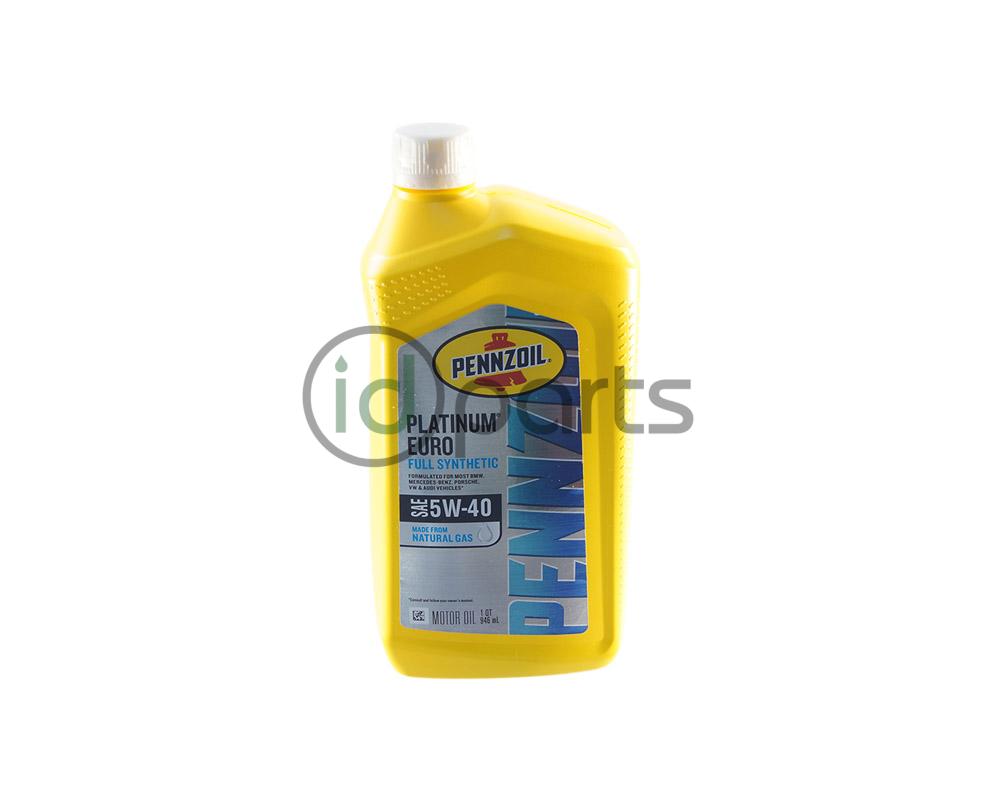

Here's a copy & paste from supplier IDparts.com
"The 2020+ oil filter is not removable from the filter cap requiring the whole assembly to be replaced at each oil change. This is because the oil filter cap has an integrated oil bypass valve."
This is the oil & filter I purchased:
