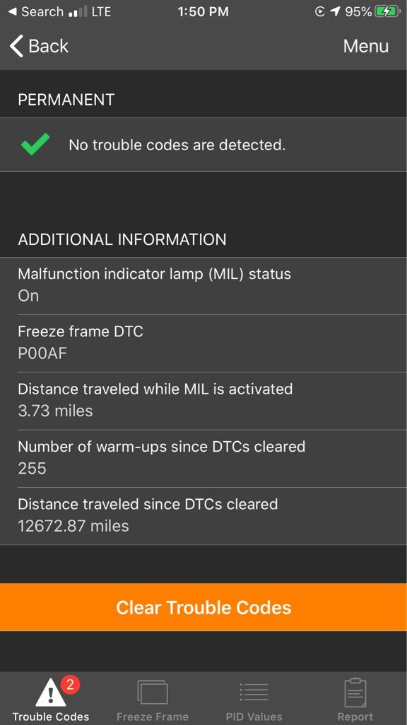

Had an issue today pulling my camper home, dashboard lit up saying service electronic throttle control, it stopped making boost and I could barely cruise at 30 mph. Once I got to a rest stop I pulled the code and it was code “P00AF Turbocharger/Supercharger Boost Control A Module Performance”
I pulled the top engine shroud and made sure all turbo piping was tight down to and up from intercooler didn’t find anything suspicious.
I then cleared the code and drove it another 250 miles without issue.
Going to call dealer Monday to see about bringing it in.
When I reset it it said it moved the code to permanent on my OBD fusion app so hopefully the dealer can get some info from it.

Spoke to the dealer today, they stated that they would just reset it like I already did and see if it happens again so no point in bringing it in at this time.
I will update if it does happen again and I get it to the dealer.
