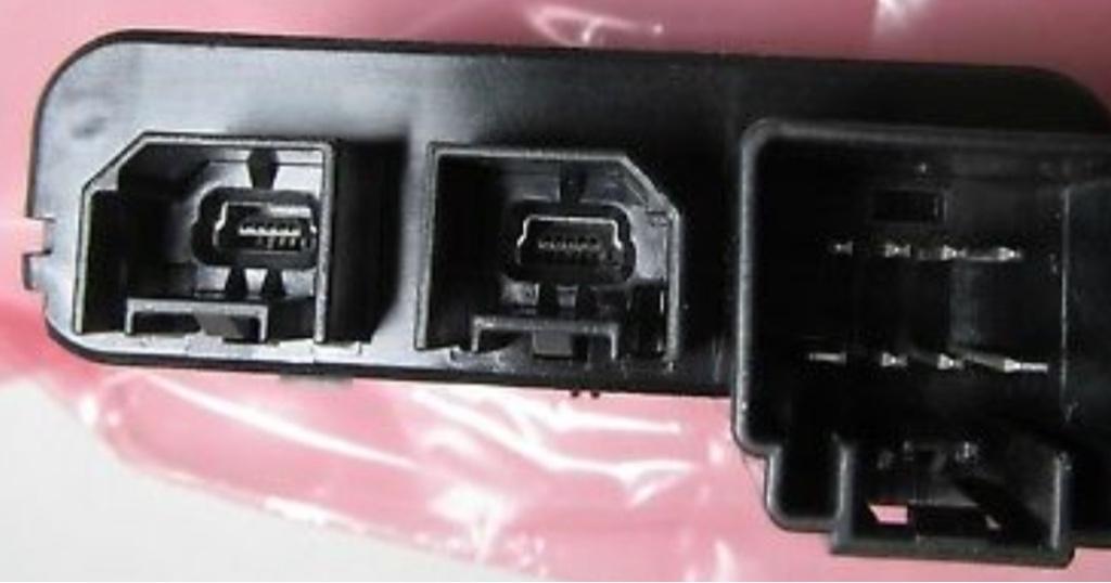

I was looking online and it appears the connectors on the back of the Media Hub are standard Mini USB-B connectors. Does anyone know if it’s possible to just bypass the media hub and plug directly into the Head Unit for CarPlay since the media hub quits working when sitting in temps more than 95° and Ram fails to acknowledge or address it. So people who live in warm climates just don’t get to use it the summer, I guess.

??? It may not be a Mini USB-B and could be proprietary but the shape looks the same.

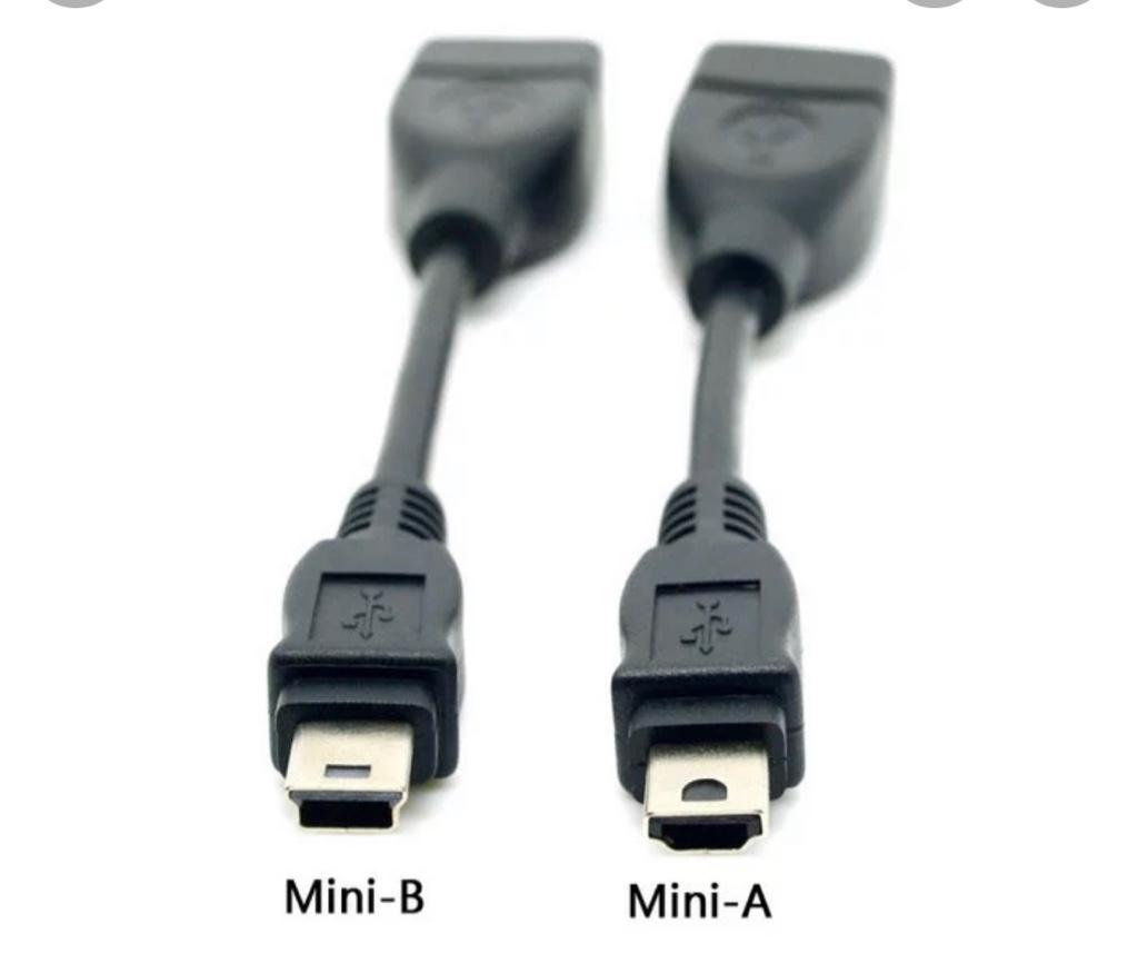

The picture you shared looks like a female USB mini.
You could try plugging directly in unless the media hub is chipped and thus the head unit rejects your connection.
You are correct that the connections on the back of the radio and the media hub are mini usb-b connections. You can bypass the media hub, and plug an iPhone directly into the back of the radio, but all it will do is charge the phone. To use CarPlay, the media hub must be used because it contains the drivers to launch CarPlay.
