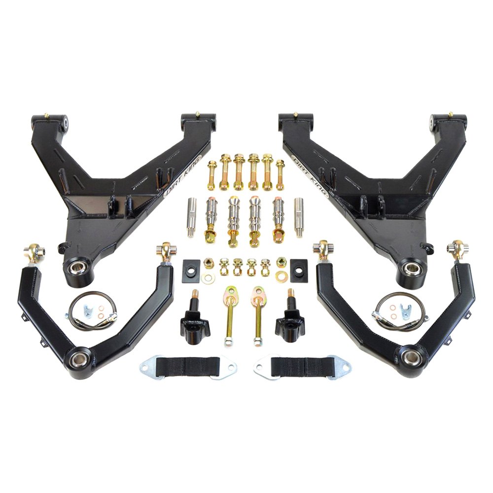

Dirt King makes a front kit.
blownout1500
Sep 17, 2018
260
287
Dirtking’s kits are for 4th gens only (2019 in that link is just Classic/4th gen body style).
Available kits for 4th gens:
Dirtking makes a bolt-on 4wd/2wd Prerunner kit (Coilovers only) and also a 2wd-only Race kit w/ weld-on shock relocate bracket (coilovers & bypasses).
Kibbetech makes a 4wd/2wd Race kit w/ weld-on shock relocate bracket (coilovers & bypasses).
KORE made a 4wd Prerunner kit (Coilovers only) that they licensed to Prefix for their Minotaur conversions, but that’s no longer available (from either KORE or Prefix).
For 5th Gens:
Both Camburg and Bajakits have UCA’s in the works as of the last couple of weeks. I’m guessing that means King has OEM replacement coilovers in the pipeline on a similar timeframe.
Dirtking has said that a 5th gen Prerunner kit is something they’d like to tackle in the coming year, but no nothing firm.
Kibbetech is waiting on receipt of the 5th gen CAD model to check frame dims to see if there are enough similarities to potentially fit their current (4th gen) race kit on the 5th gens.
Its possible that one of these companies is working with FCA on the TRX suspension. We haven’t seen any evidence of wider long travel geometry in any of the leaked TRX test mule photos. If KORE or Dirtking is contracted to prototype TRX suspension components independently from FCA, I’m just hoping Mopar will sell them to us as aftermarket upgrades
For 5th Gens:
