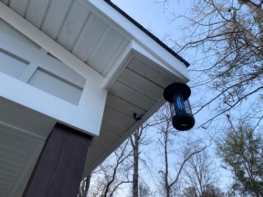

Smart minds think alike. I installed a soffit plug for Christmas lights and a bug zapper on both the house and shop.
I used a smart outlet so one side is powered on all the time and the other switches via Alexa smart home routines.
