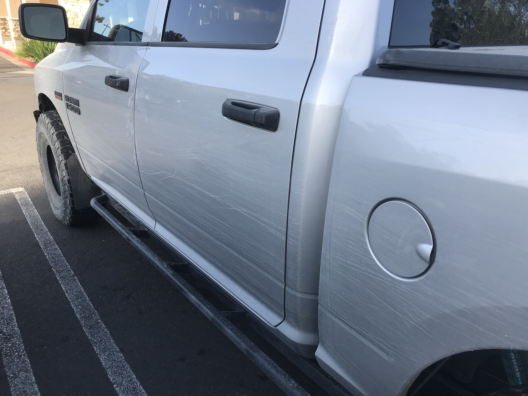

Took the Rebel off-roading this weekend, and it's a big truck I took in some places that weren't quite that big. Got some branch scrapes along the sides. Nothing terrible, but they're visible. Anyone had any luck with fillers or swirl removers for stuff like this?

I have tried those in the past for my off-road pinstriping. They are a patch at best to temp fill the scratch so you don't see it.
I've had some luck with fine or medium cut cleaners followed with polish and wax. The rub is that you are basically sanding down your clearcoat to smooth it out.
I had to take my truck to a body shop for a tire blowout and they replaced a quarter panel. That left one great looking body panel and the rest had scratches from off-roading. The shop offered me a reasonable price for their paint guy to clean the finish to get rid of the scratches on that side since they already had it. I asked about the other side and they gave me a good deal to do the other side during the holidays. They told me work is pretty scarce around Christmas-time so I brought my truck back a couple of months later for them the "buff out" the other side.
I would never have thought to check with some local body shops for that kind of work if I didn't have the blowout. If I get to the point that scratches bother me on this truck I am going to go that route again. It was top notch work.
I'd recommend finding out who the recommended shops are around you and call a few and see what they say. Never hurts.

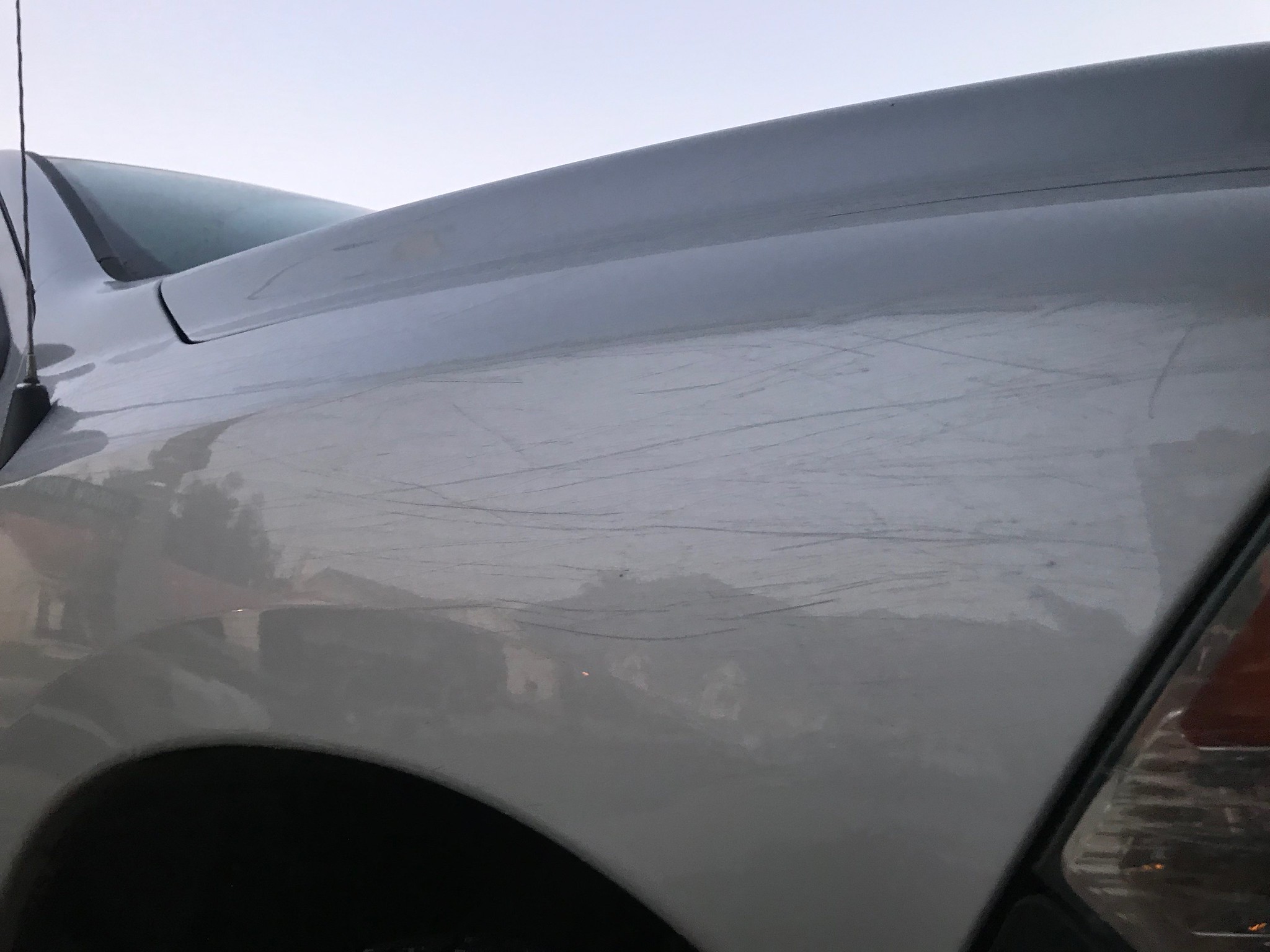

They only hurt the 1st few times you go offroad and get them, You can wax them but next time wheeling you'll get them again.
Offroad more often and wear your pinstripes with pride :) they clean out nicely with just water and soap, i stop bothering trying to get them out in full long, looonnggggggg time ago.

After a twice a month bath she cleans up nicely
Untitled by RAM RSM, on Flickr

I had some forest pin stripes that were caused by some smaller alder trees growing up along a Forest Service Road. I have had really good luck using Griot's Garage Complete Compound.

I don't think ceramic would prevent them, but it adds a layer that could/and did make them easier to buff out - if they are not down to the paint.
I got some nice forest striping on my Granite Crystal all down the passenger side, and they buffed out nicely, paint still looks brand new.

I just cleaned up mine. I used a fine cut compound and microfiber towels. Took out 95% of them and the other 5% you have to know where to look.

best thing is just have someone buff them out. I’ll do 3-4 off road trips before I decide to get them off
