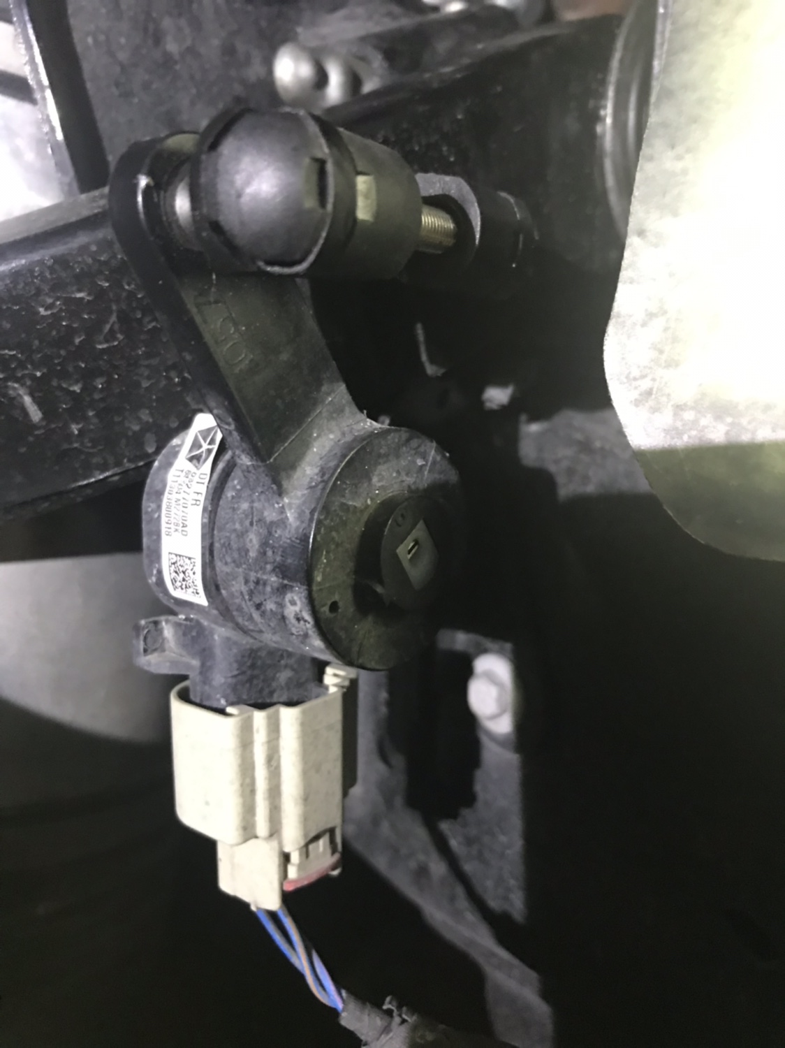

Ouch! Found the problem! Has anyone snapped the sensor mount? Better yet, does anyone know if there are any tricks to replacing it? It was the front right that broke at the bolt attachment point.

I just ordered another one for $66. It installs with a single torx. Have not installed it because my rubber band setup actually works just fine, lol.

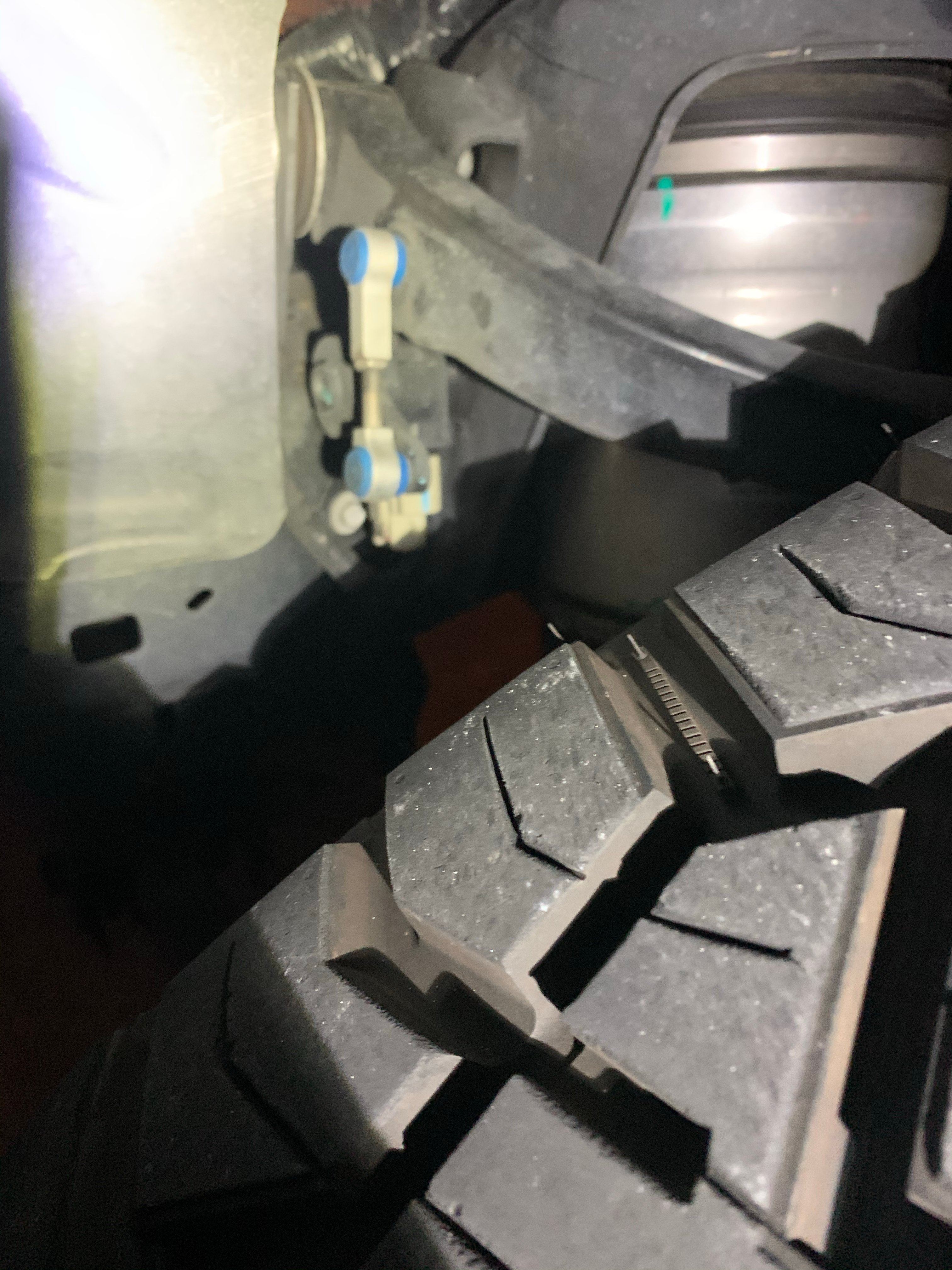

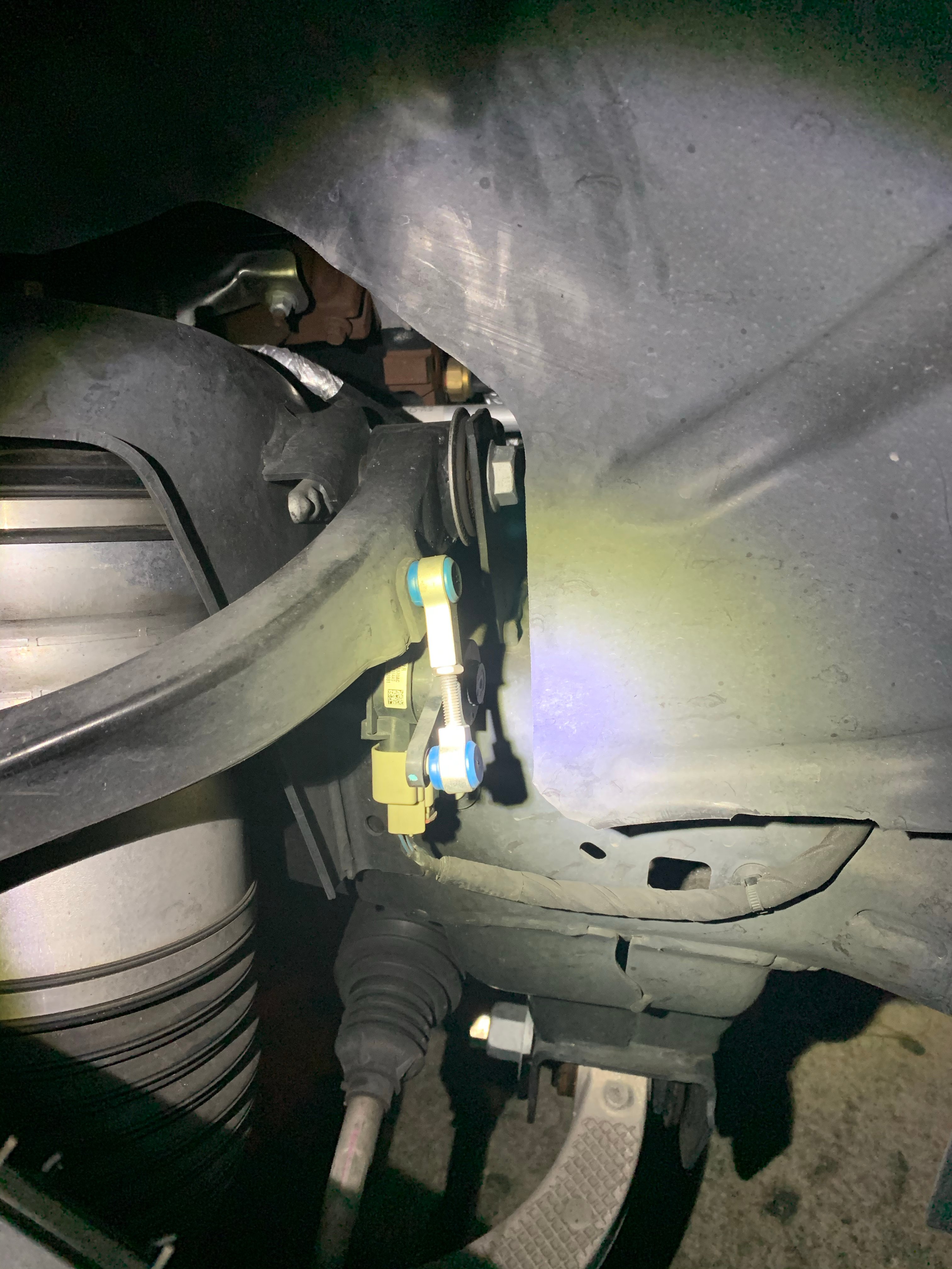

You’ll also get errors if you’ve adjusted the arms too short. It will keep trying to inflate but never get full enough. Give the sensors a good wiggle- they might be partially connected.

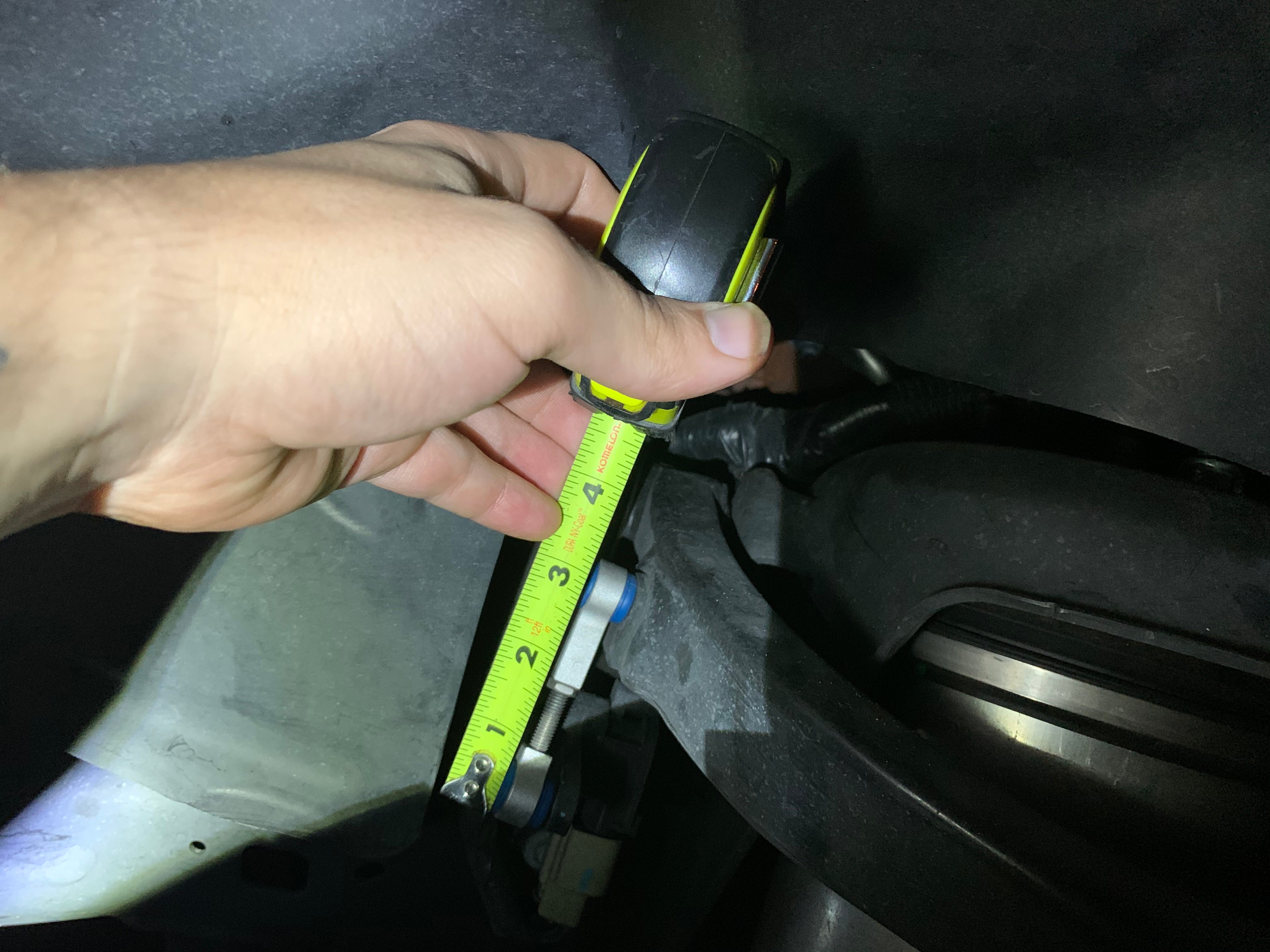

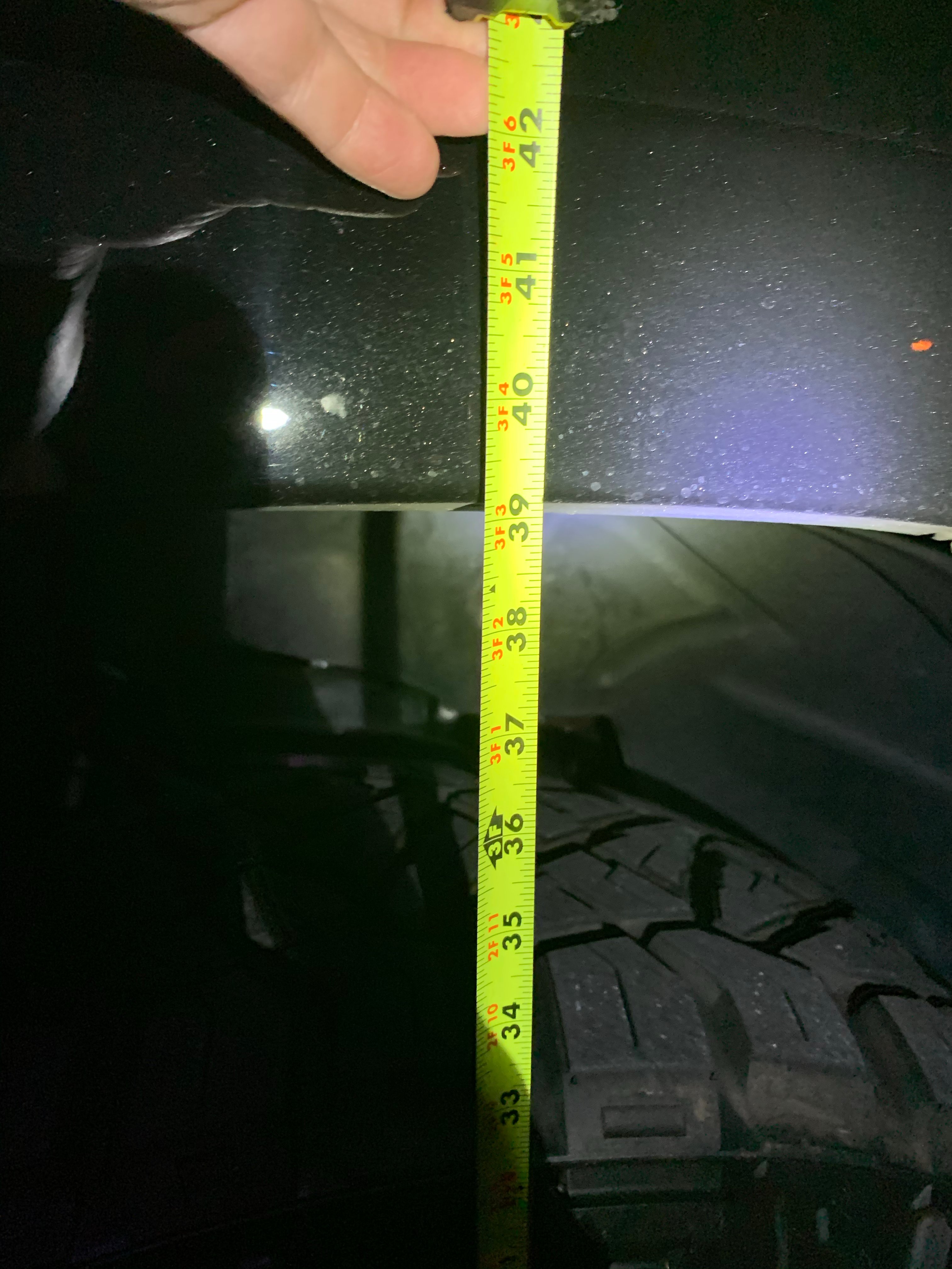

Yea I have revel links I’m thinking they may need to be adjusted my front is at just under 39.5in and my rear is at 40.5

The shop that installed the spacers put the links on I don’t think they adjusted them now that I measured the front to rear height. Does lengthening them raise the truck or lower the truck?

That’s the measurement of front and back heights in normal mode and then what my links are at aswell
My front was at 40.5” after the level, so you definitely aren’t maxed out on height. Shorten the front links a little and see if it helps. You are basically at factory ride height, so the bags might be under inflated with the spacers.
You can remove the links, just make sure to support the sensor arm before you do any pulling. Don’t want to snap it.
