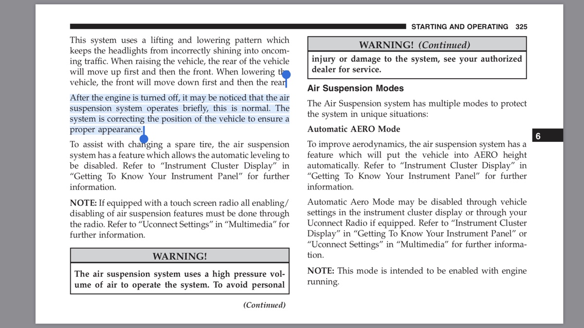

2019 Limited 5.7 w/air suspension. Truck adjusts height when parked on level ground. Noticed this at home when I pull it out of the garage into the drive. Within a few minutes it hums(air compressor?) and makes a small downward height adjustment; lasts a couple seconds. My drive and garage are level. This happens wherever I park. Just wondering if this is normal? Has anyone seen this and reason it would do this?

It’s constantly adjusting for what it’s programming thinks is best. Open the tailgate and the tail will drop some (at least most of the time). I think it gathers data while driving then makes small tweaks when you stop moving.

I believe a tech posted up the air suspension adjustment routine; it's something like 3 level checks after shutoff. Also when you interact with the truck and you have the key nearby, it will auto-level. I believe 2hrs or so after shutoff it stops any auto-correction

Completely normal as stated above. Mine does the same thing; my driveway is not level and it makes the truck articulate to be level.
