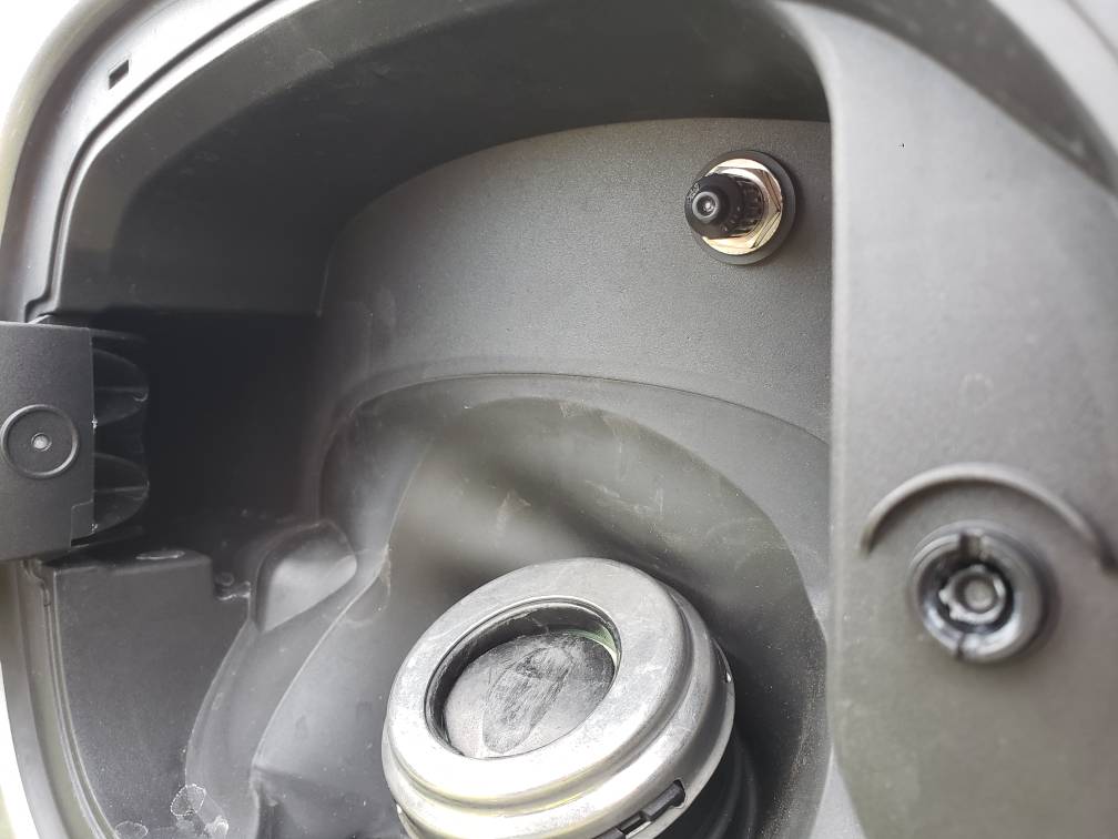

swarggs
Nov 20, 2018
194
166
Pennsylvania
I installed these and mounted the valve behind the fuel door.
Sent from my SM-G960U1 using Tapatalk
