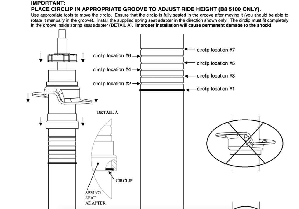

I think you have the spring seat upside down, which is why it's sitting so high. I stole this from another thread but this is how it should look.

Problem fixed! Sits nice and level now. I don't know what I was thinking lol.

Hey guys, I have a question. I put my Bilstein 5100's at the 5th setting, but the truck still has a 1 inch rake. Could I move the it up to the 6th setting? I looked at my UCA angle and it is literally perfectly level.

You shouldn’t be putting them up the 6th on a rebel. Atleast that’s bilsteins recommendation.

Yea I just saw that on there too. Id rather not take the chance.

Probably more to do with over compressing the spring vs uca angle. I used the 4th setting and a 1" spacer in the rear and have about 3/4" rear rake. Before a bit of settling and the rear spacer the 4th clip raised the front 2.25". After a week or so it settled right at 2".
I actually ordered a 1/2 inch spacer from motofab. That should put it within a 1/4 of an inch from the back. I didn't want the 2.5 inch spacer in concerns to a rough ride. So using the bilsteins for 2 inches of the lift, then only having a 1/2 inch spacer should be great.

UPDATE: Installed the 1/2 inch Moto-fab spacers. It sits within a 1/4 of an inch from front to back now. PERFECT. No difference in ride quality. So I did the bilsteins on setting 5 and added 1/2 top mount spacers. G2G.
