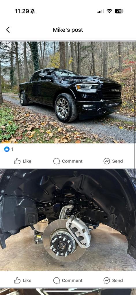

Is anyone running a 13.50 wide tire? I am going to lift my truck with a 6 inch lift and I found a great deal on some Limited wheels with 35x13.50R20 tires. I believe I am going to have to run a spacer since these are Limited wheels with factory offsets.

Stock wheel offset would cause even 12.5 wide to rub. Tire would rub inside against the upper control arm.
At least this is true for stock height and up to 2.5" level/lift. I"m sure the geometry of the 6" lift will move the UCA further away from the tire, but not sure it would be enough to clear a 13.5 wide on stock wheel.
Also, if you go with a 6" lift I'd recommend 37" tall tires anyways.

Do you think a 2 inch spacer would kick the wheel out far enough to run a 13.50 tire?

Yeah I'd say so. Seems like 2" would clear you from the upper control arm setup but not sure how the 13.5 wide would then do on the front and back side of the fenders.

The tires is the reason I am wanting to buy them. Guy is selling a new set of Cooper STT Pro's on limited wheels for $1000. The tires are $500/each if I bought them out right. The only thing I was worried about was the 13.50 wide tire.

Ah dang. Well in that case I'd definitely buy them and then do whatever it took to make it fit.
Might fit as is but might also need spacers. Maybe not 2" spacers but just enough to clear everything. Either way you're saving over $1000 between tires and mount/balance.
What about the guy selling them? How did they fit for him?

Well picked up the wheels and tires today. When I have time, I am going to remove my front wheels and mount them up to see what is needed to clear the UCA. Just wondering how the lift will affect that pitch.
