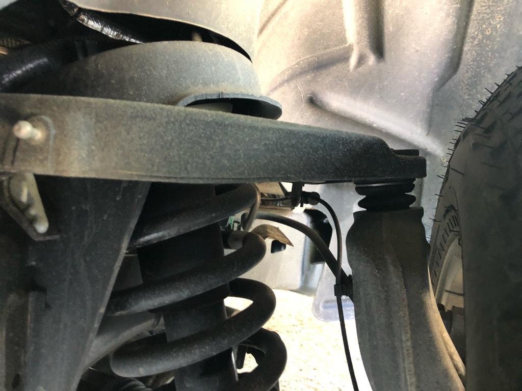

Has anyone put a 305/65r18 on a stock rebel wheel? Will it rub the control arm or can it even be mounted?
I have a set of rebel wheels and a line on a set of this sized tires so i want to know if its possible. Truck will be getting a 2" level kit + mopar ucas.

My only concern would be that width and whether doing so would require a spacer. 66870260-3679-48E1-A98D-AA8EE1112CD0.jpeg

Yeah that’s my problem. I really don’t want to run spacers. They are 1.2” wider so if this space is bigger than 0.6” I’m good haha.

I think your gonna be pushing it. 12 + “ wide tires really need more offset in the wheels or spacers.

I’ve seen so many trucks running 35x12.50 and 33x12.50 tires on stock wheels with no spacers. It’s close but the tire will not rub on the UCA, and that measurement won’t change at any point while driving either.

You might be pushing the limits of rim width running a 12.5" wide tire on the stock Rebel rim

That’s a good point. Stock Rebel rims are 8” wide the stock 20’s are 9” wide

In that case, the tire being too wide for the 18” wheel is a different discussion all together. To OP’s question, it won’t hit the UCA. Tire manufacturers list max rim width, I’d start there if it’s a concern.
