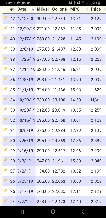

Last several tanks in my 19 LoneStar non-eTorque with 3.21.
They higher ranks are road trips...I mostly just drive back and forth to work through town and grocery store trips.
