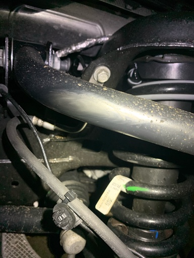

Yesterday I had my ReadyLift 2” Lift with UCAs installed. Also had the 285/55R22 RIDGE Grapplers put on my factory 22s.
I was told by a couple members that they didn’t have any issues with similar equipment.
It looks to me that there is no rub except a rub on the back of the Ready Lift UCA at just shy of full lock. It’s worse in reverse. Couldn’t get a picture today, will add one tomorrow.
My question is... Is there any good way to figure what size spacer I need to eliminate the rub? Any other suggestions?

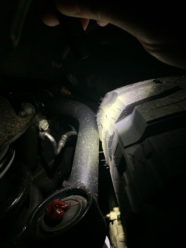

I mis-wrote in my firs post. I bought ridge grapplers! Sorry I went back and forth on which ones to get and went with the ridge grapplers!
Here is a couple pics at full lock and you can tell on both sides of the control arm show some rubbing.
I don’t know of any other way to fix this but spacers. So I’d imagine this thread will take a turn toward a spacer discussion. Just quickly eyeballing it it looks like I shouldn’t have any issues with spacers.
I don’t want to trim the studs so what’s the smallest spacer I can run without having to trim? What’s the stud length?

Minor update to my issue. Alignment helped a decent amount but still have a little rub.
I ordered some 1.25”spacers, hopefully they don’t find a new rub point. I think even a .5” spacer would stop the rub but figure the truck would look good with a little wider stance.
If they don’t work I’ll probably try a narrow spacer just to get the clearance at the control arm and be done with it!
