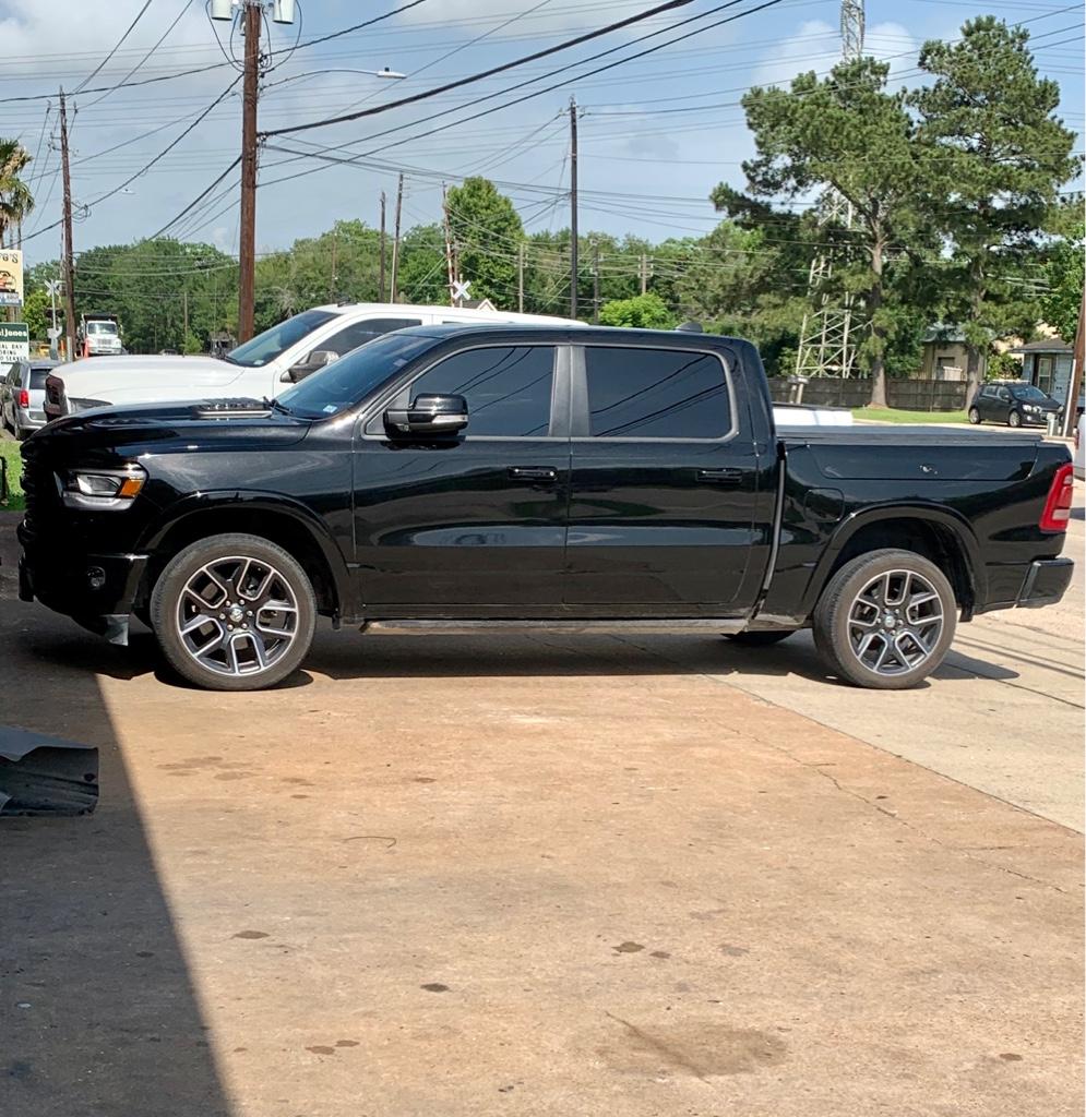

My factory size was 285/45R22 which was 32” and change in diameter.
I’ve been wanting to put a larger, more aggressive tire and a level kit but have been waiting to get my money’s worth out of the OEM Goodyear’s. Pulled the trigger on Friday and was out of the door with everything installed in an hour.

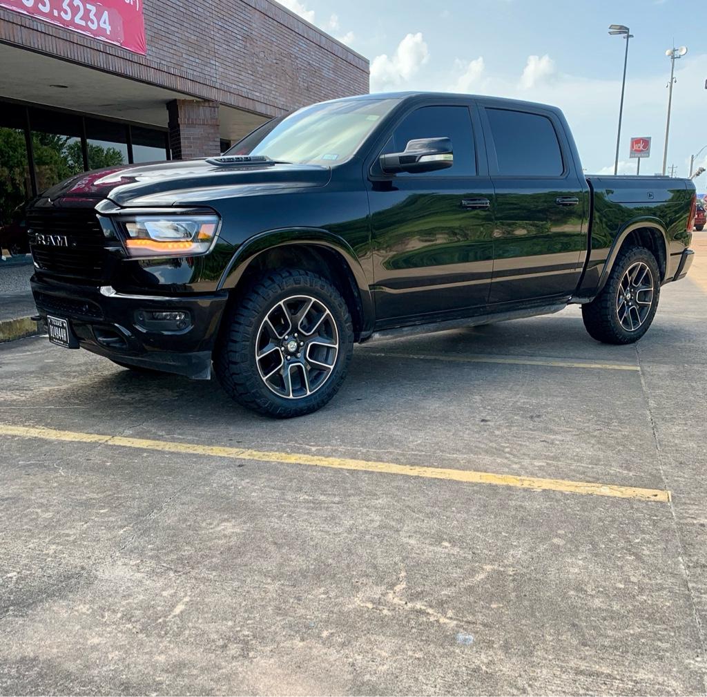

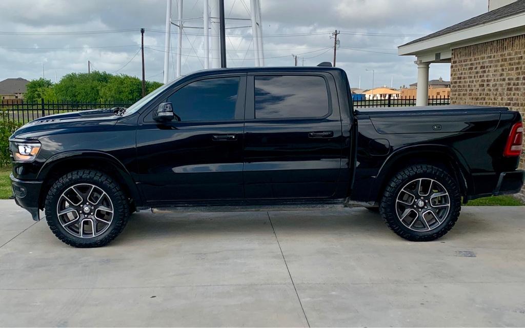

They just added a run of the mill level kit up front, not sure how much to be honest but I like it. The new tires are just over 34”. I looked at 33” tires at first but would’ve gained just under an inch overall and I wanted more sidewall than that. Only minor issue is a bit of rubbing (on the active air dam) when turned almost completely to the left, no rubbing at all turning right.

35’s would’ve had major rubbing/clearance issues without a lift from what I read so I went with 34’s and a level.

I’ll get some pics one of these days, it’s rubbing slightly on a little plastic up front I need to trim a bit. No biggie.

The fuel economy definitely dropped, though I haven’t checked or calculated an exact mpg drop but definitely noticeable. Luckily I have a fuel card for work

I'm running the same size tires and same wheels, stock tires I would avg around 15mpg on the cluster, and now avg around 12mpg. Mostly in city driving.

Personally I wouldnt trim, I'd heatgun it. At least that's what I did for mine here:
285/55r22 Ridge grapplers on no-lift-ram - heatgun'd for tirerubs
Most likely itll rub worse when at-speed & full lock (ie: swinging into a parking space, making a tight moderate speed turn, etc)
Btw...truck looks great! :)(y)
That’s a good idea, thanks for linking your thread. I only have a slight rub when I’m locked out turning left. Nothing turning right so I forget about it but I do need to address it soon.
