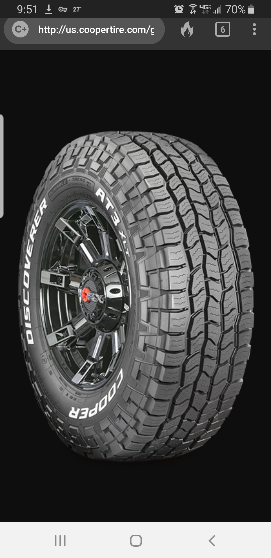

The best AT tire out right now to me as far as looks and performance is the Cooper Discoverer AT3 XLT. They are very quiet. Had them on my Tundra TRD Pro before the Rebel and lots of Tundra guys are running them with good results. I've turned a few F150 boys on to them as well.

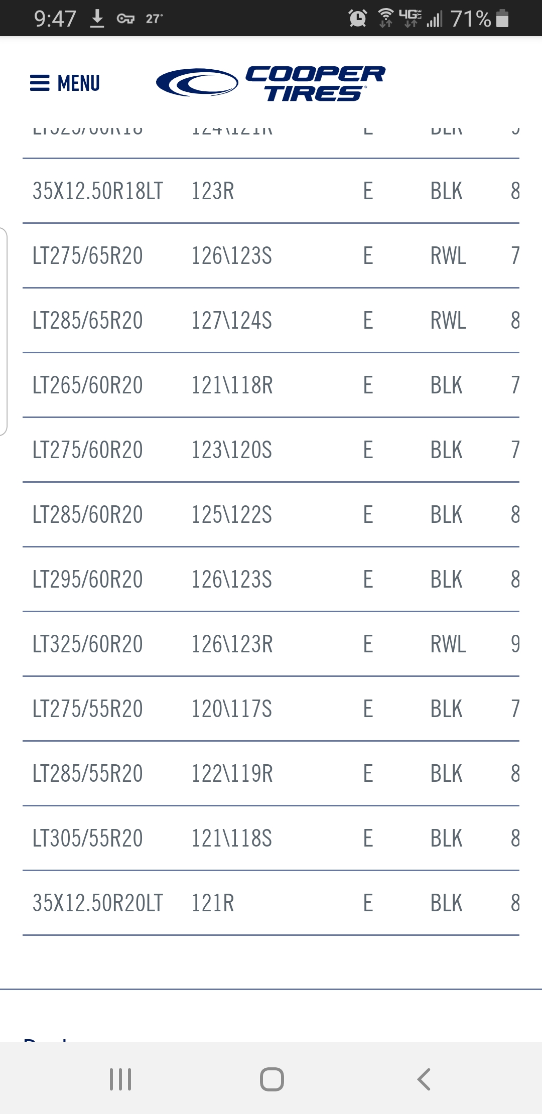

Can not get the coopers over here, they do the 4s sport not the xlt.
