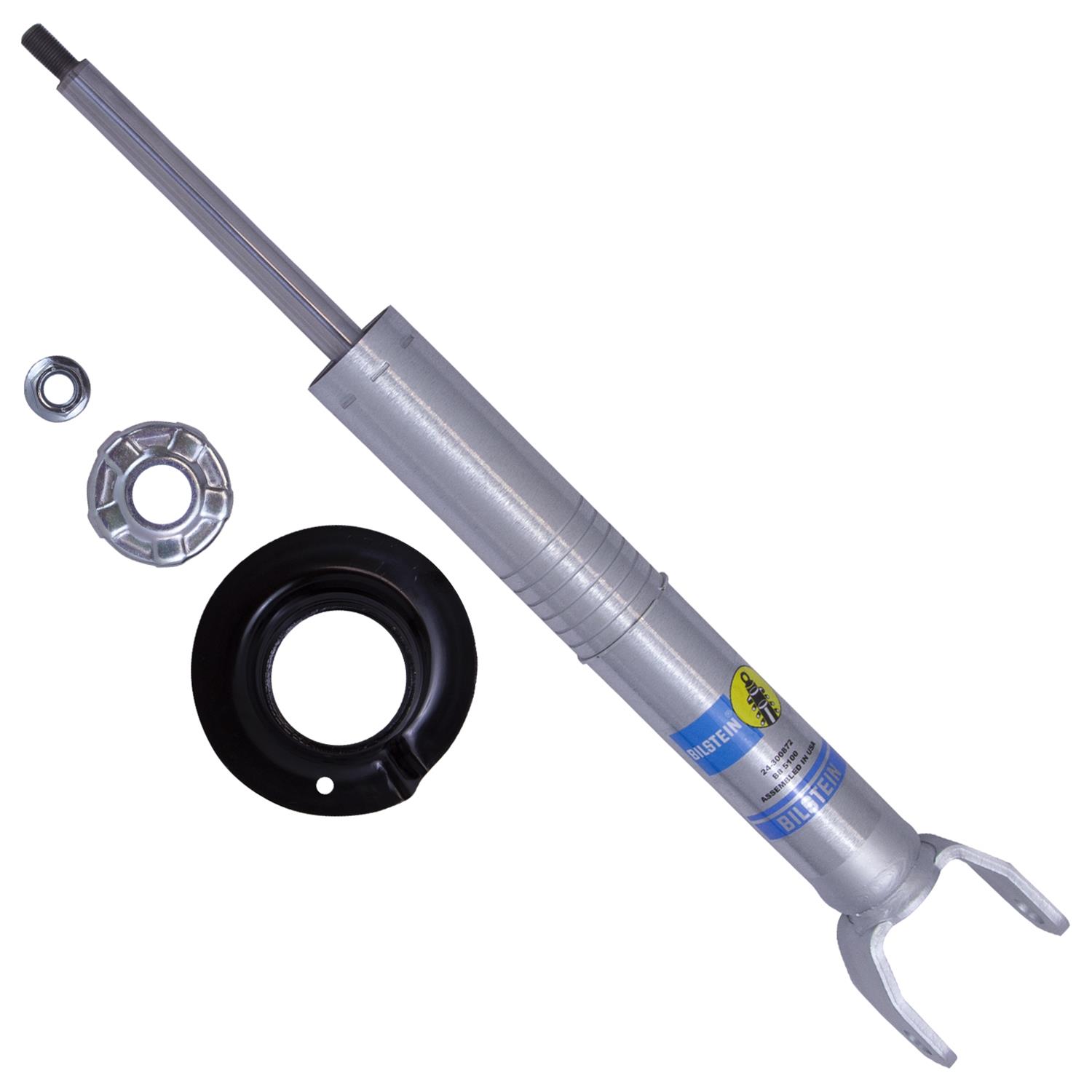

So I’ve gone through most the treads here and can’t quite find what I’m looking for. I’ve got a 21’ 1500 rwd. I’m just looking to level it 2inches. Nothing crazy but I want to do it right. No spacers or anything. What’s the best setup for these trucks with no hassle, no rubbing etc. I’m leaning towards a coil setup with replacing the uca’s. Can anyone here point me in the right direction for the best setup.

Just do Bil 5100’s, and you won’t need UCA’s
This^ I did this. But I ended up finding some used mopar uca and threw them on just for good measure.

Mopar ORP UCA’s can be had on Ebay new for $125
Will the 5100’s retain the factory angle on the ball joints or does it change the angle depending on the height I decide?
They change slightly, but at 2” setting you are fine …. Get the ORP UCA’s if you want “extra” peace of mind

Gotcha ok awesome. Probably a stupid question, do I reuse the factory springs or replace those also?

Does anyone on here have a link for those shocks?

Using Bilsteins is a popular way to level your truck. A bit stiff, but the ride isn't too bad.
