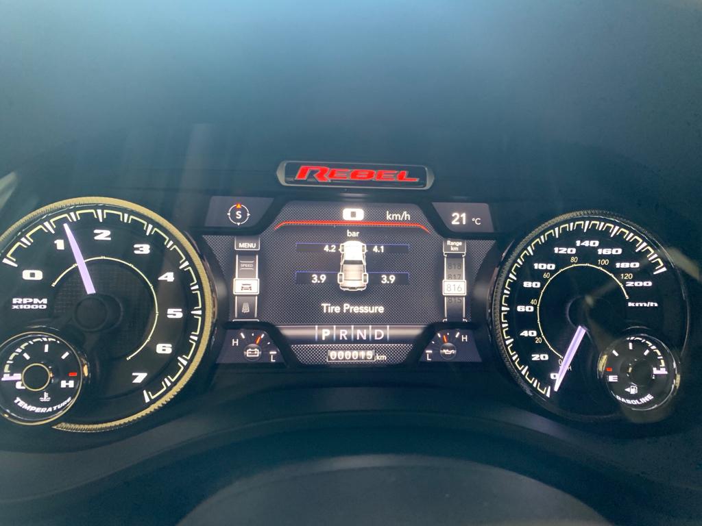

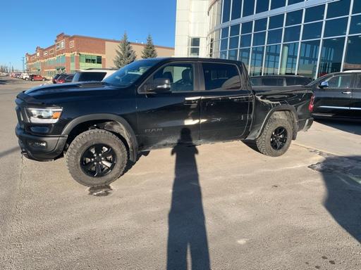

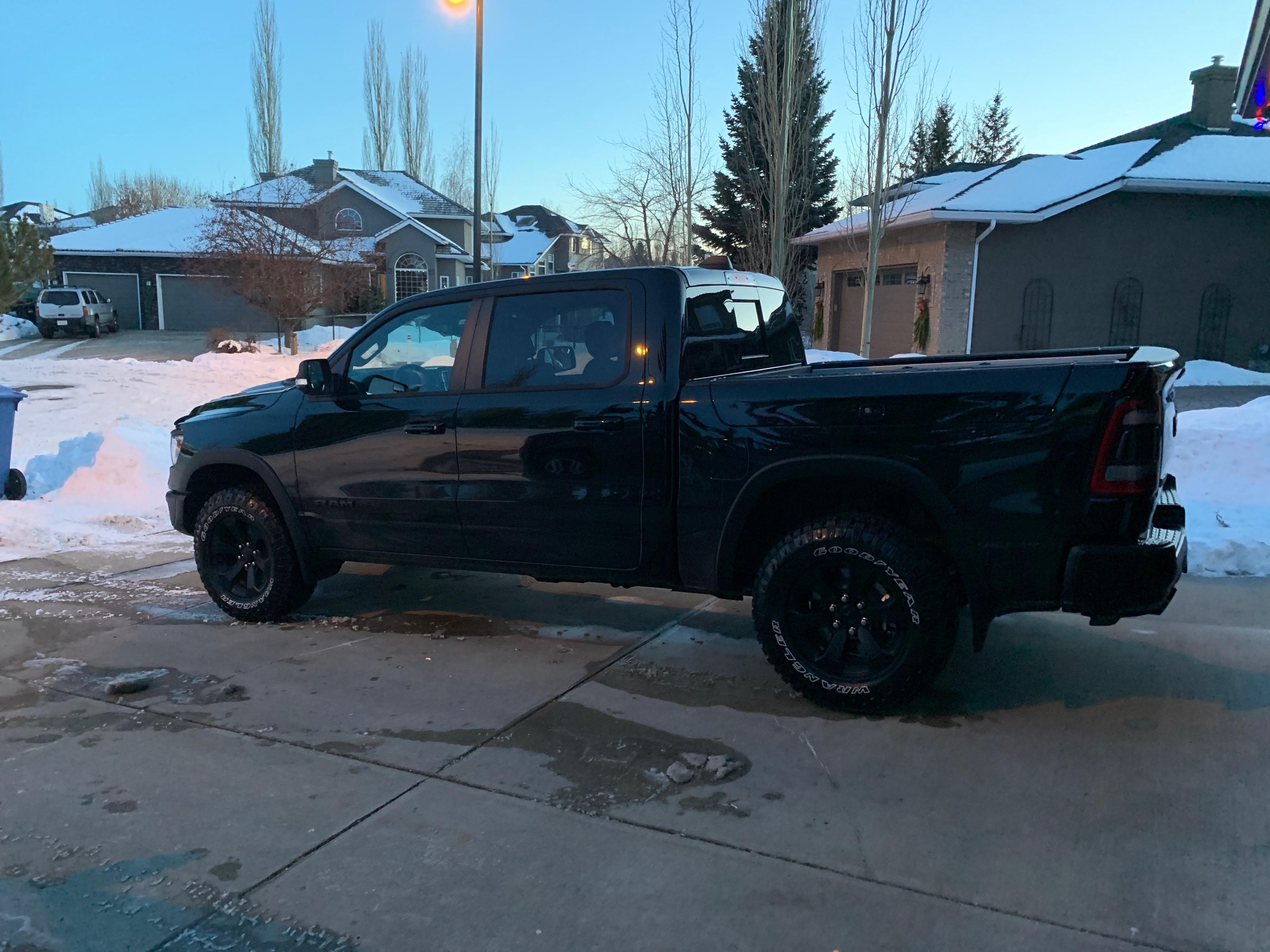

Ordered my replacement for my 2010 Ram 1500 in mid September... picked it up yesterday. 15 km on it.
Won’t be going crazy but a few additions (last truck had a blower that I took out after 9 transmission rebuilds...)

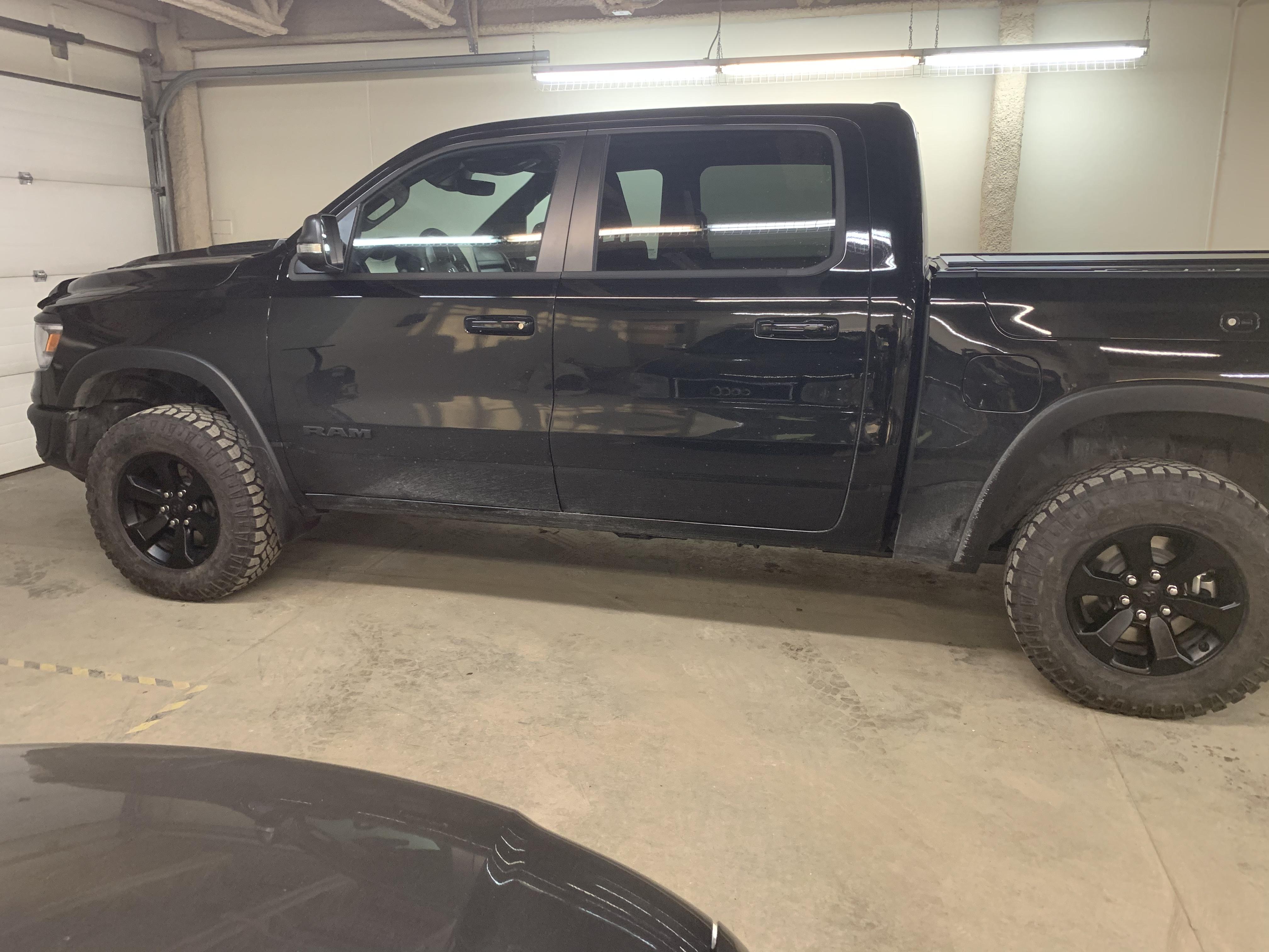

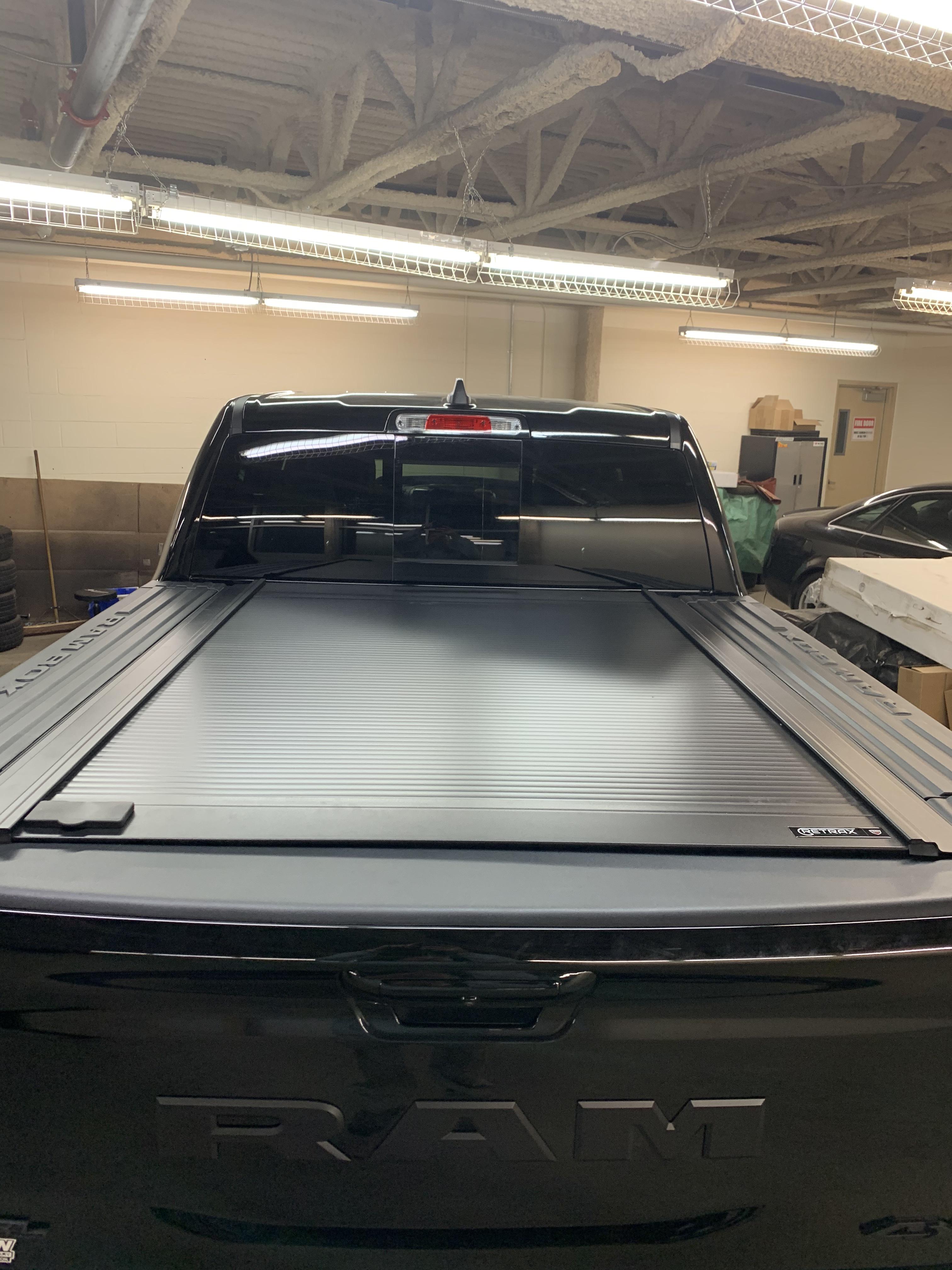

So I had a Retrax Lexan cover on the last one and really like that, installed it today.

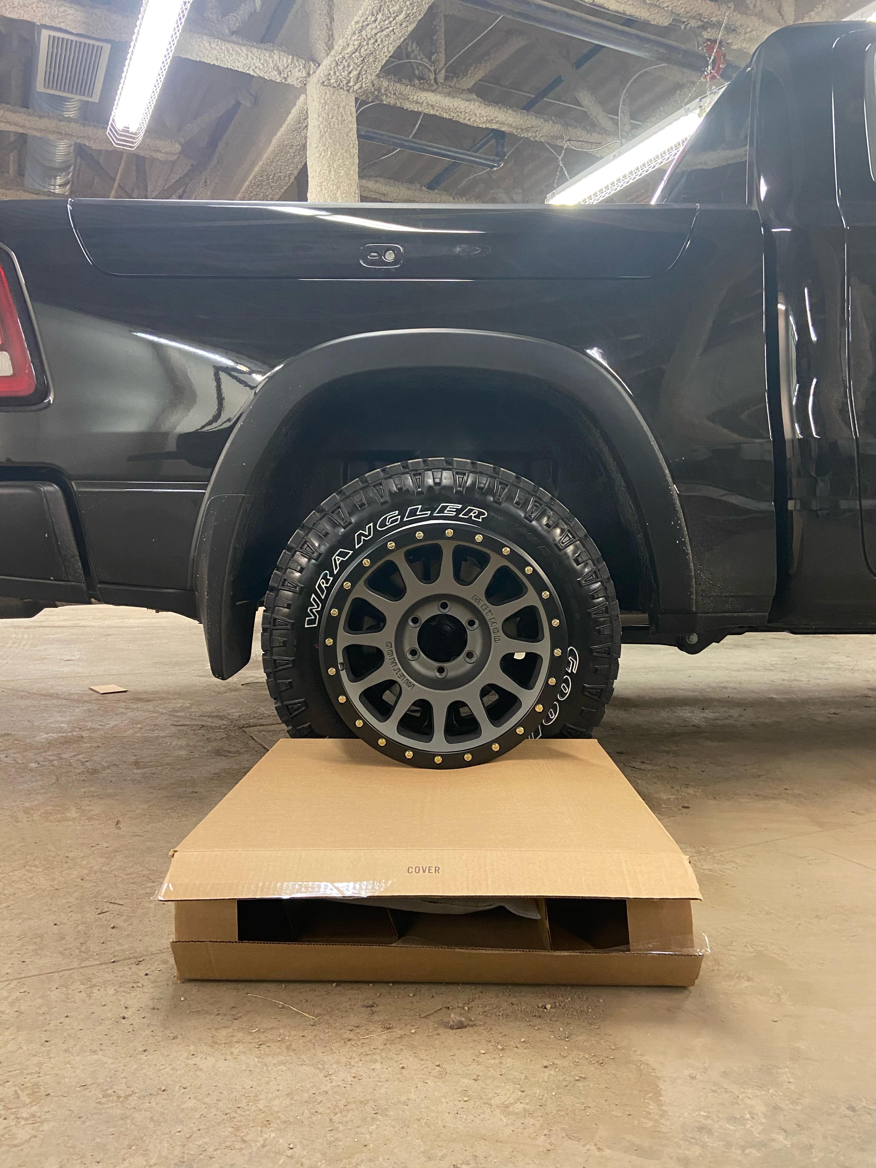

Picked up some Method wheels - I won’t be putting them on until summer as I will run a winter tire.
I had already ordered some Bilstein 6112 / 5160 so I’ll see if I can get them on this weekend.
[I
MG]//uploads.tapatalk-cdn.com/20210109/e67d980cf86a79218b11349ff1e9da3d.jpg[/IMG]

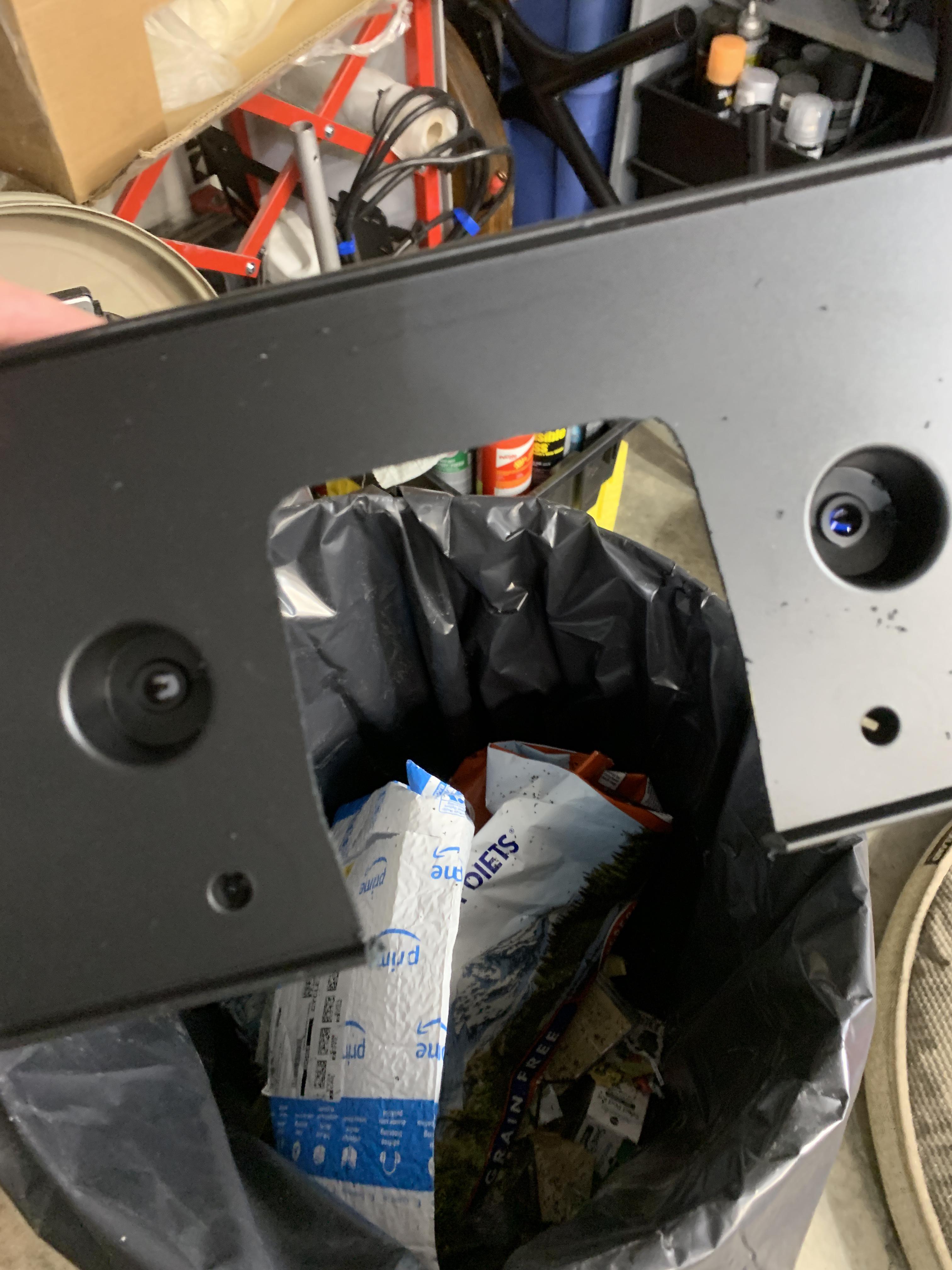

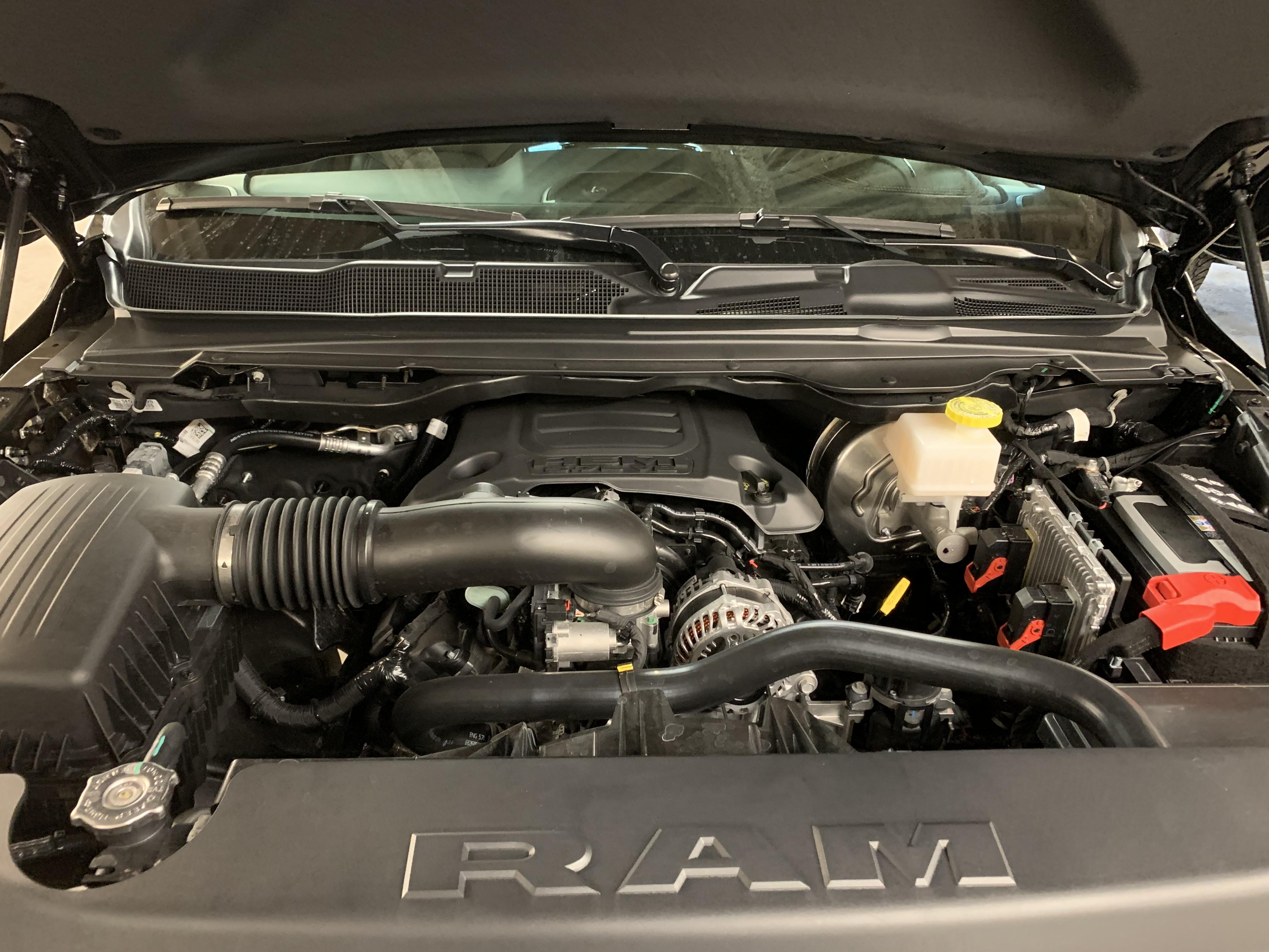

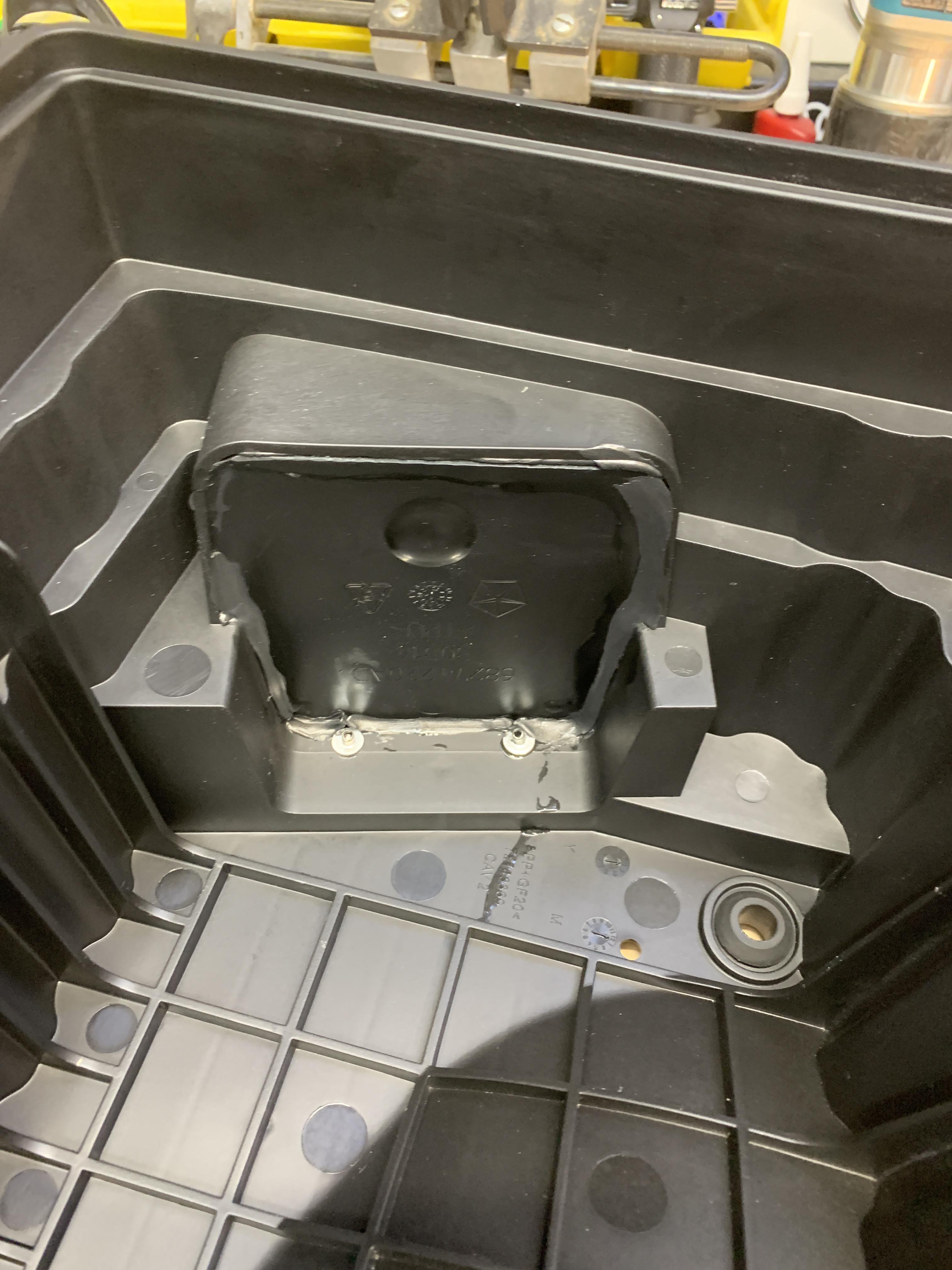

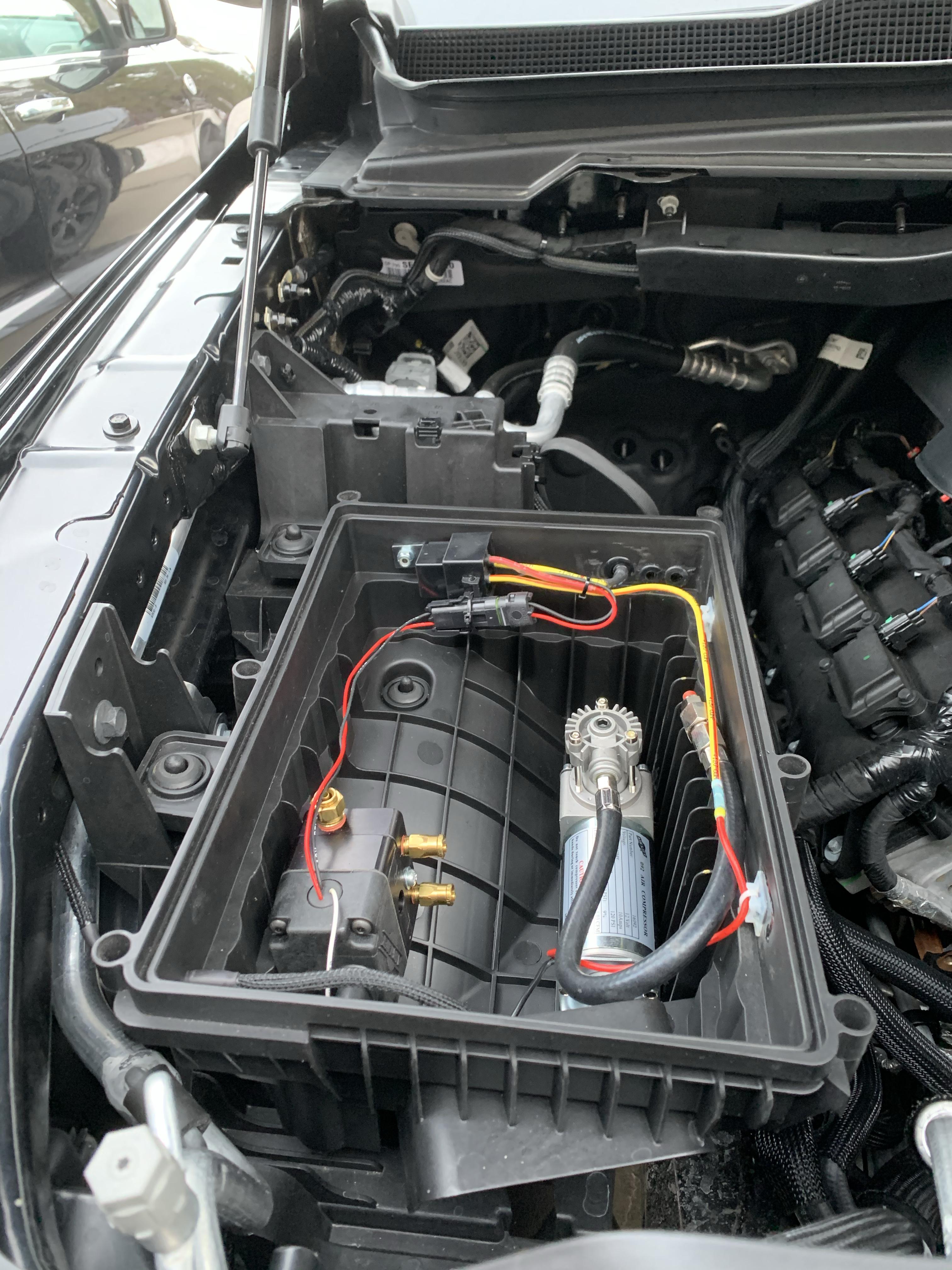

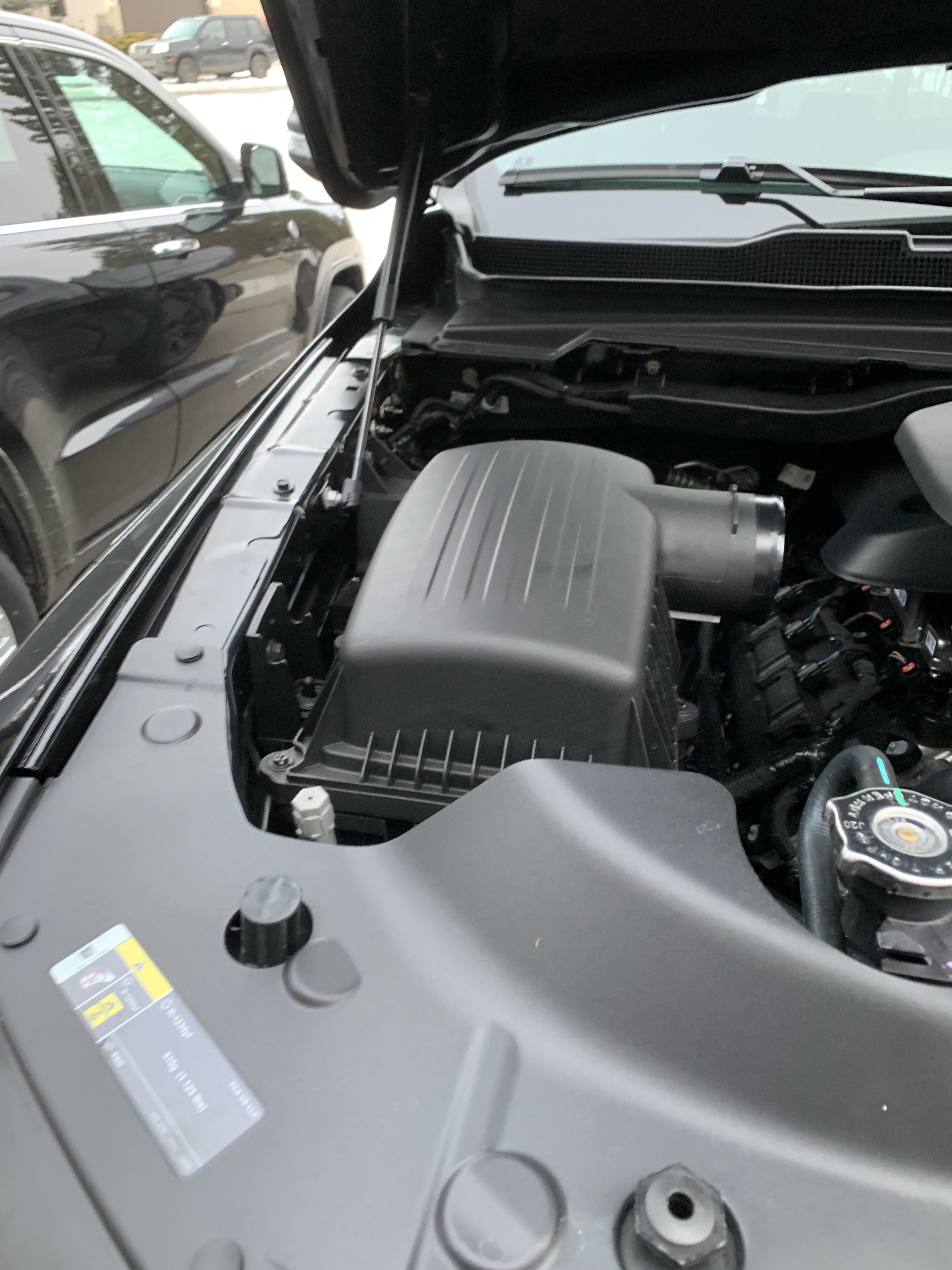

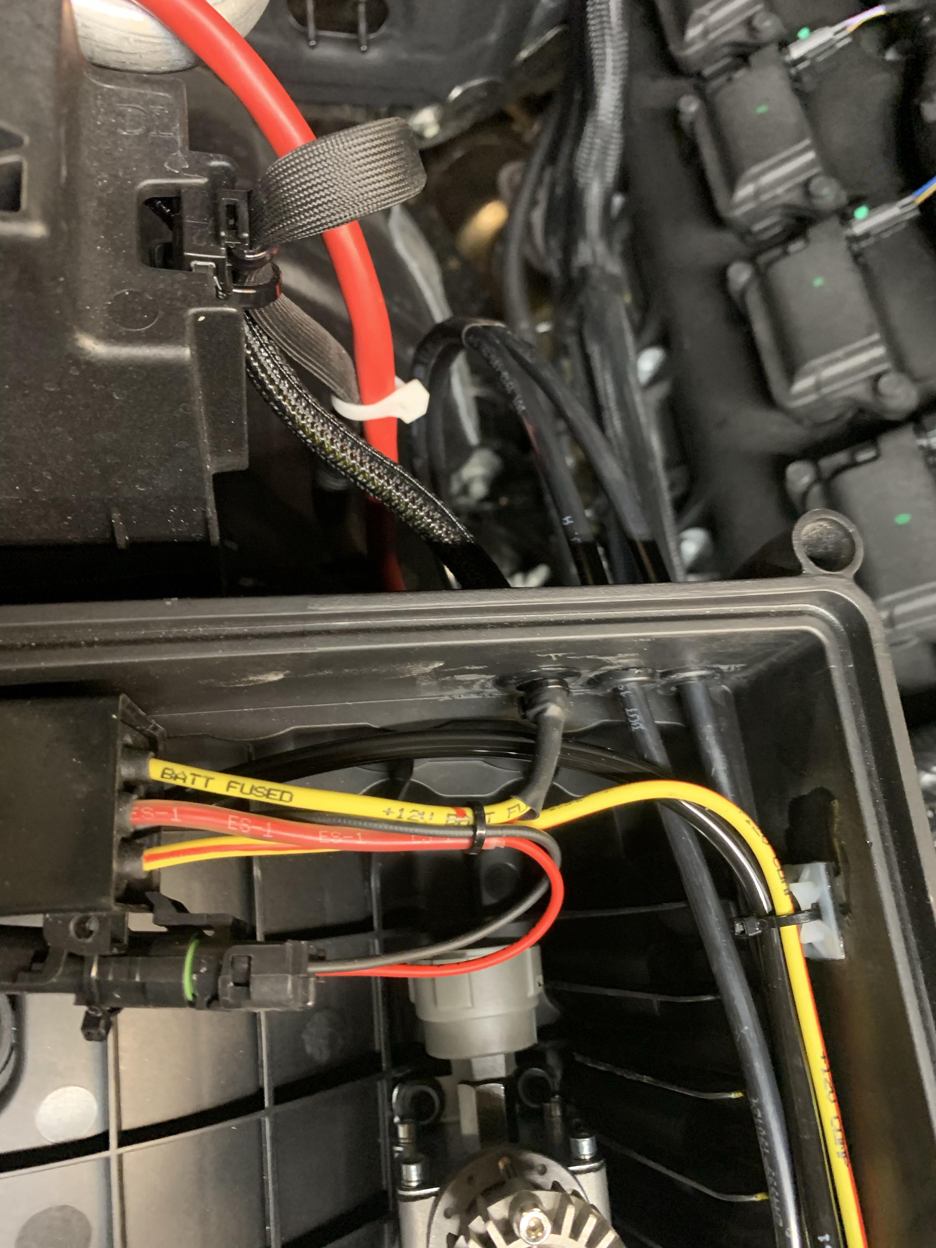

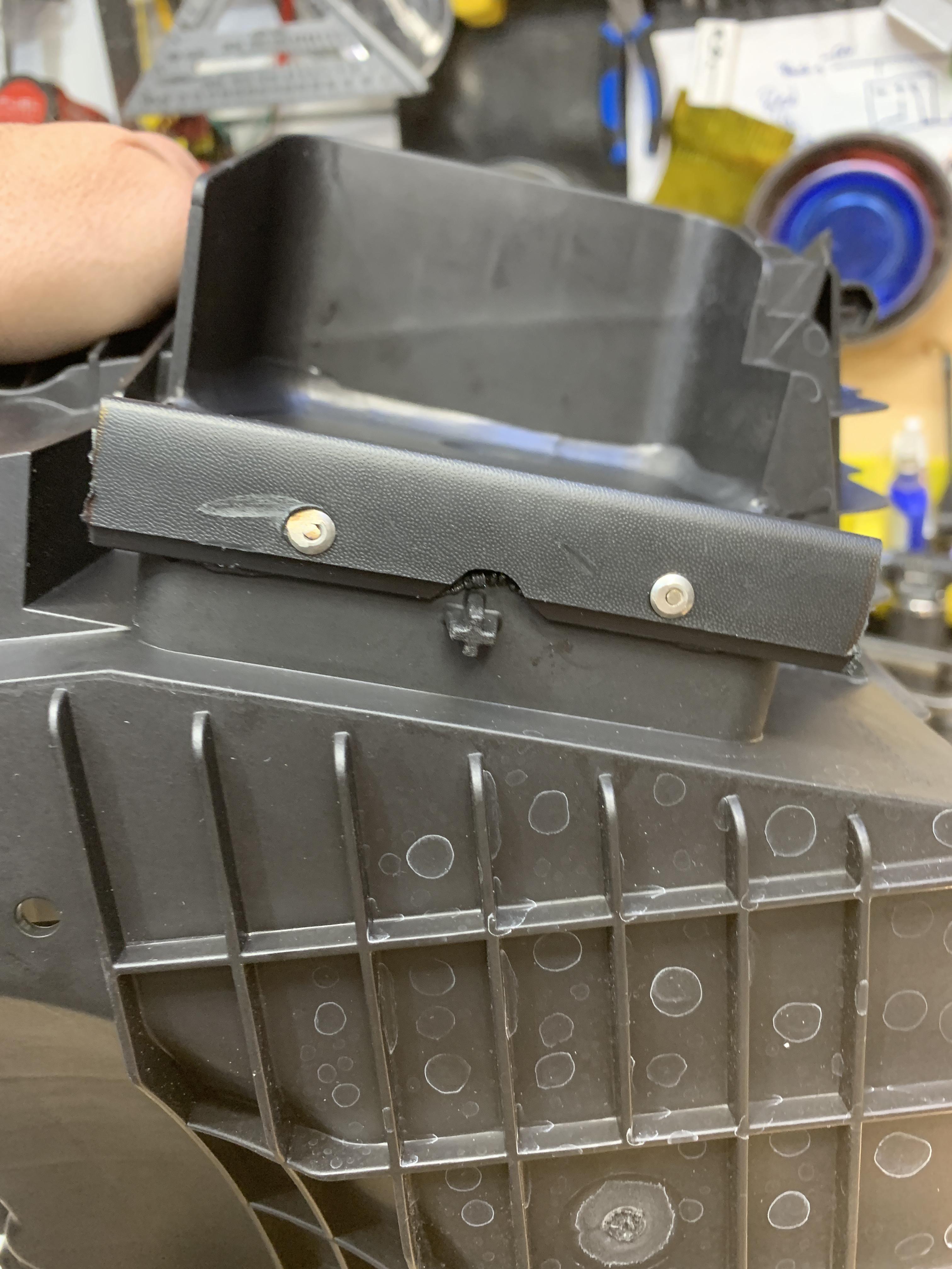

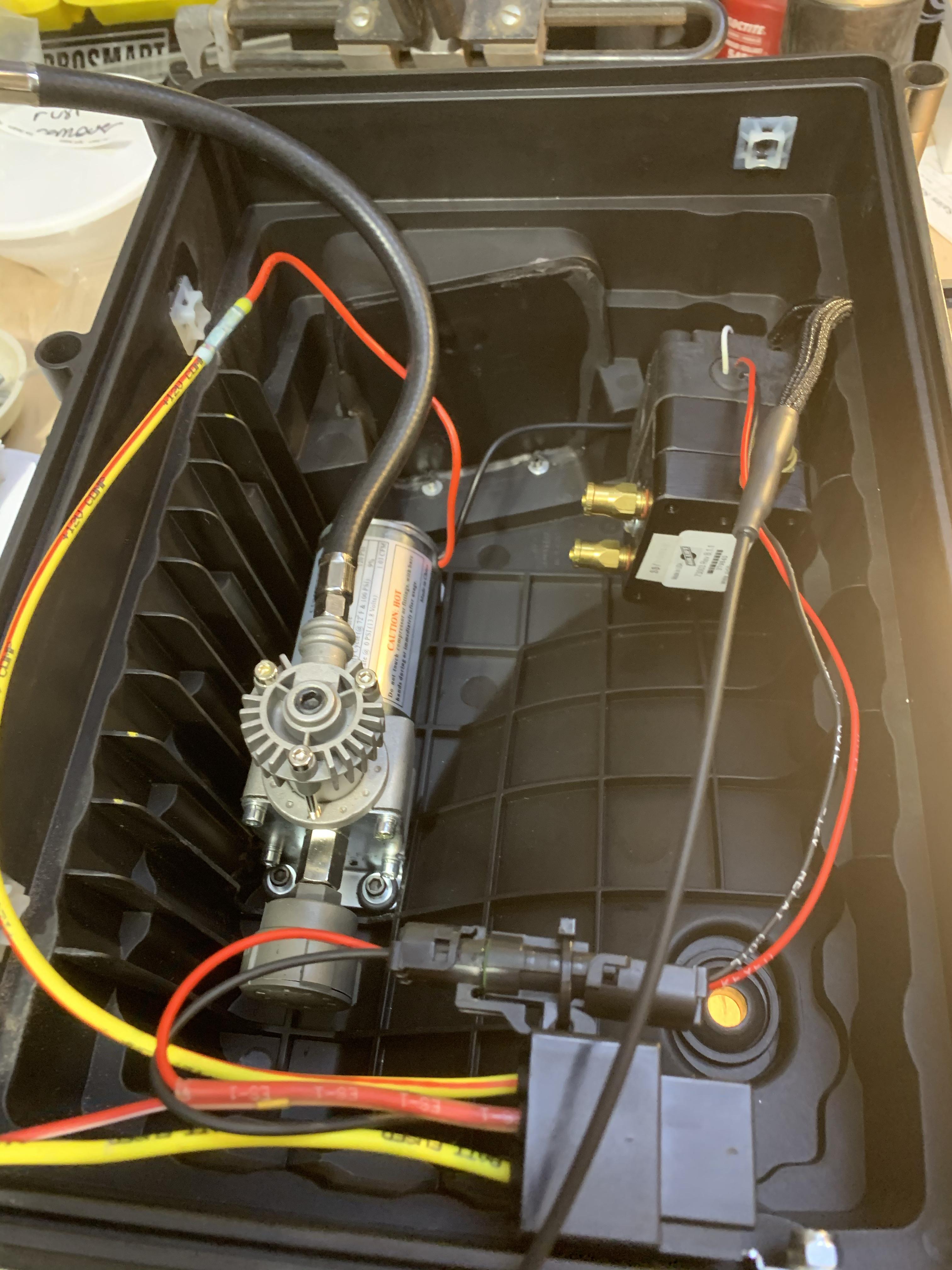

I’ll be putting the Airlift HD 1000’s in when I do my shocks... so in preparation of that I decided to put the compressor and manifold in the old air box.
Used the front license plate bracket to plug front intake hole. Couple of rivers and some silicone to seal it.

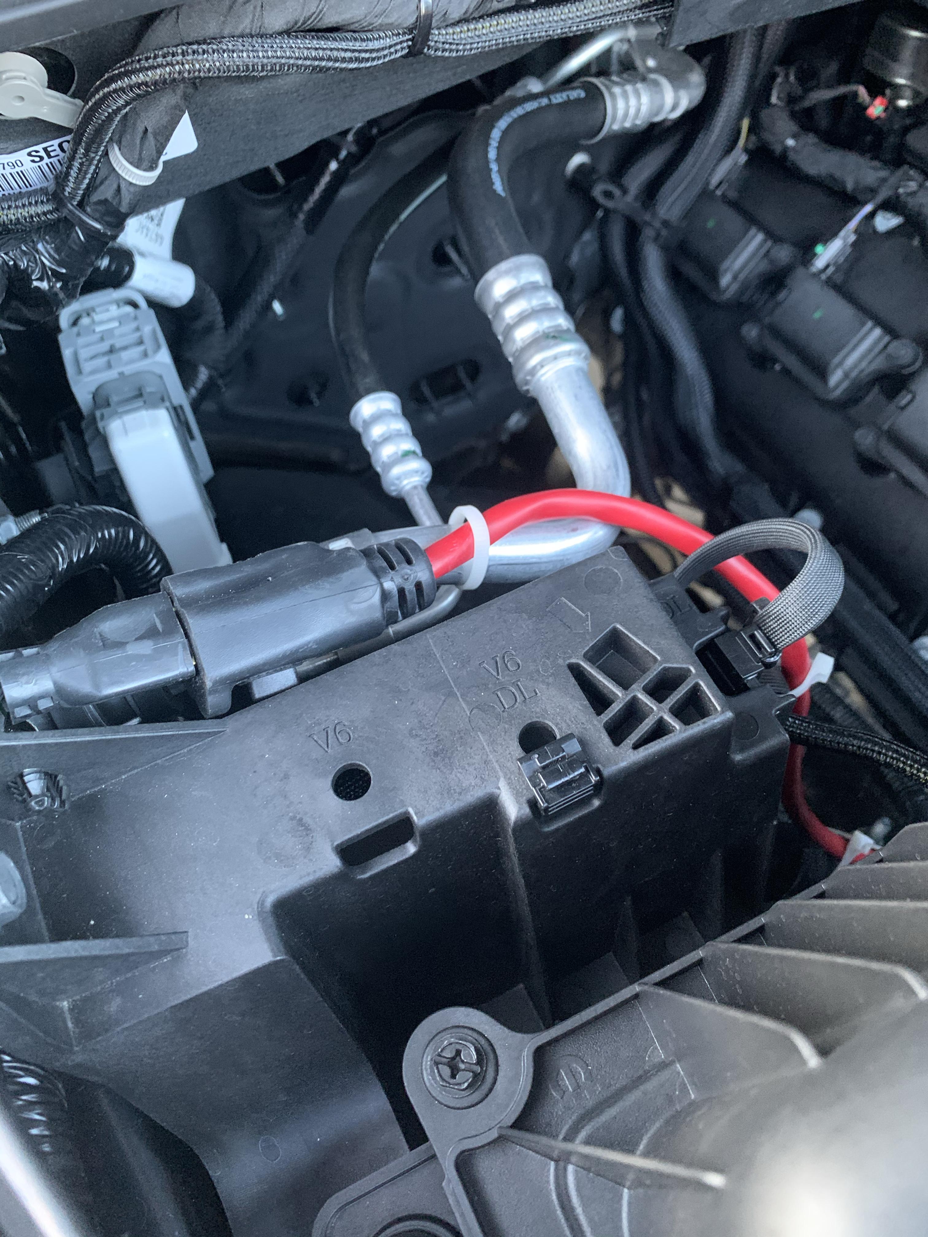

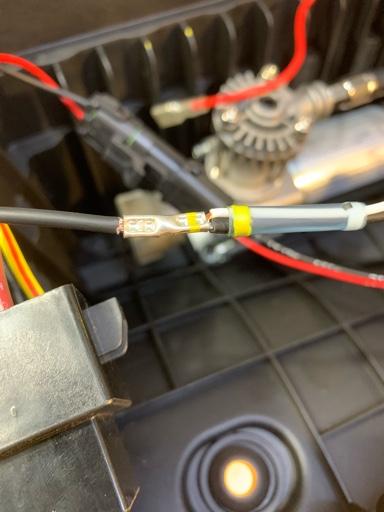

Fished the wire through the loom on the firewall. Used braided nylon around wire and shrink wrap on each end (you have to look closely to see it...

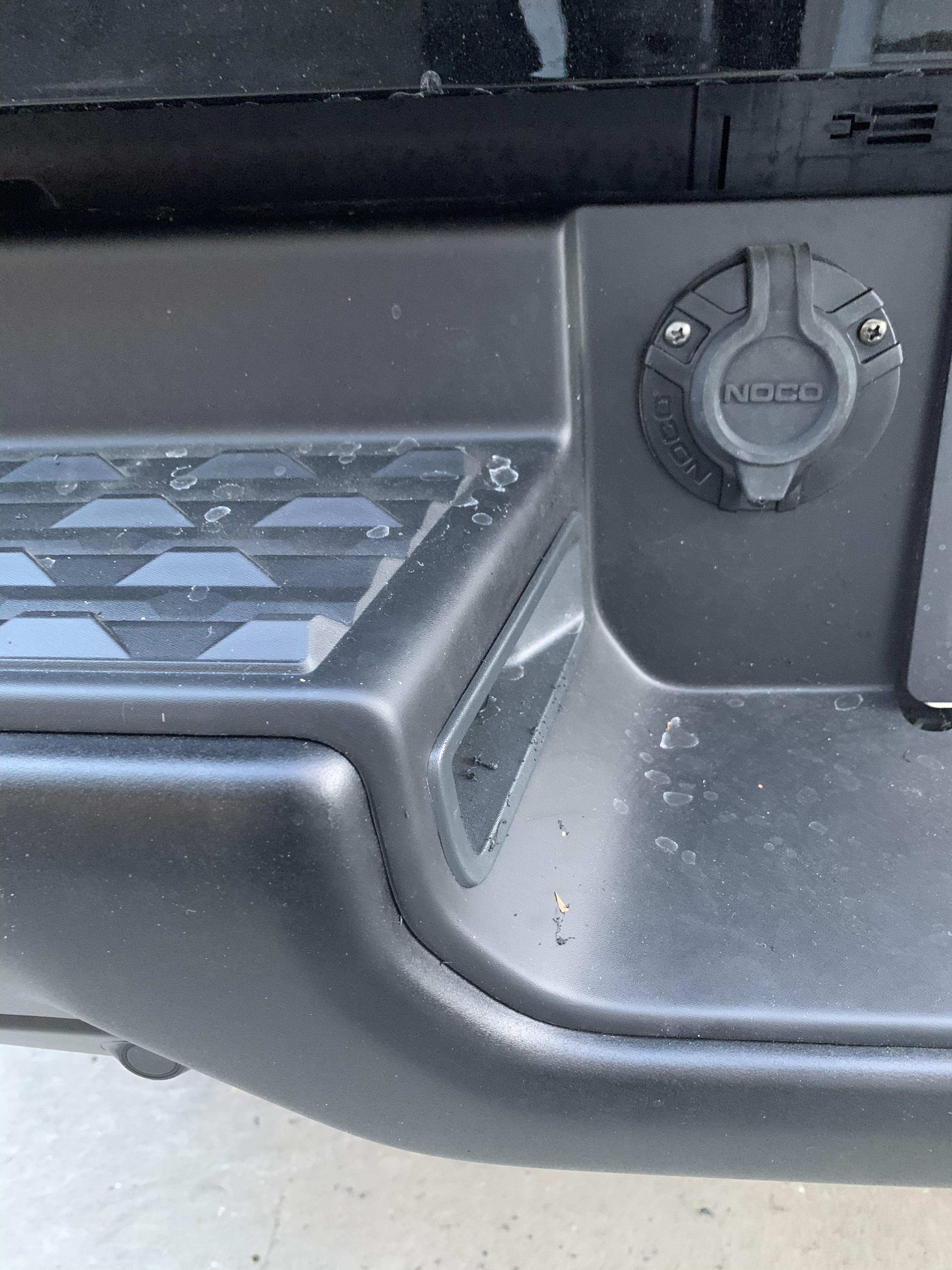

And installed rear block heater plug...
Connectors are all crimped and the heat shrink.

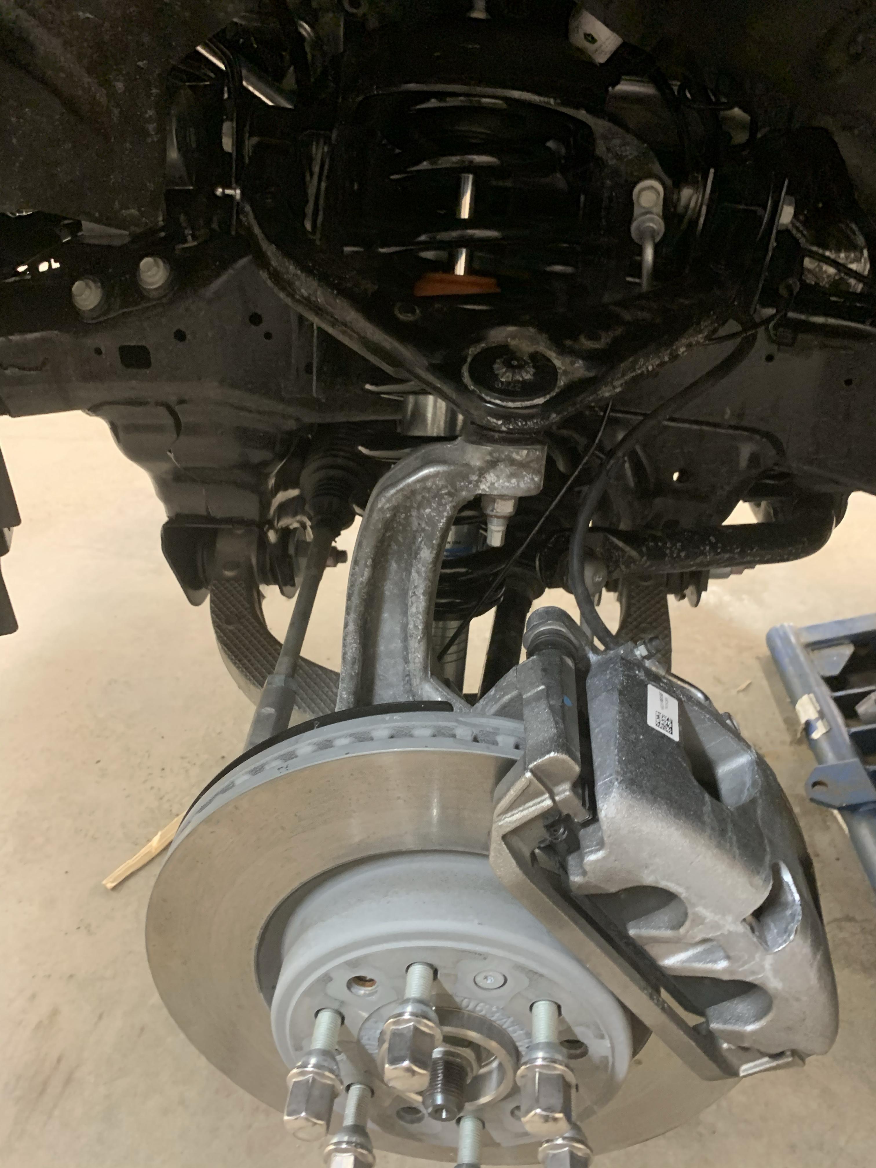

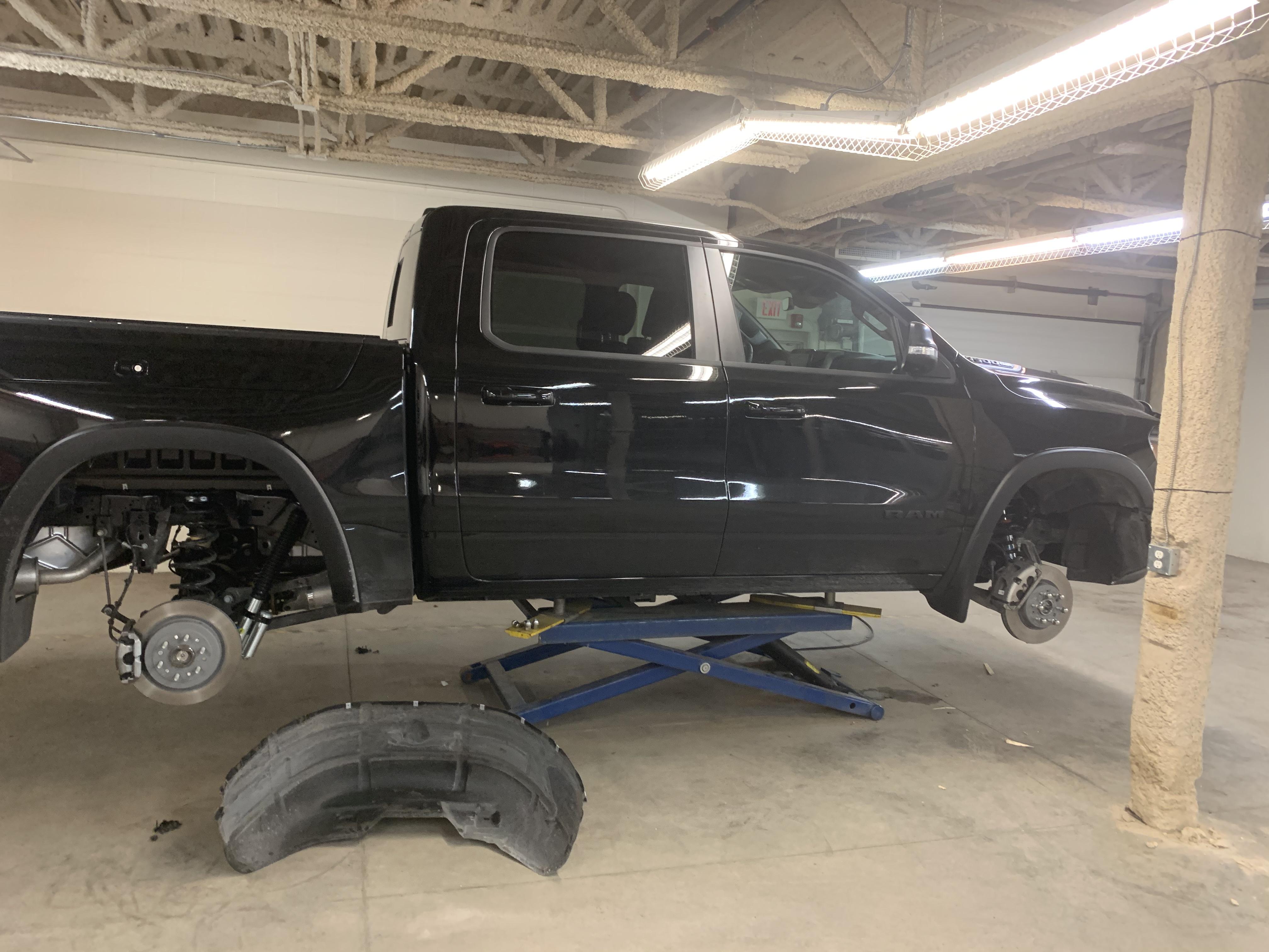

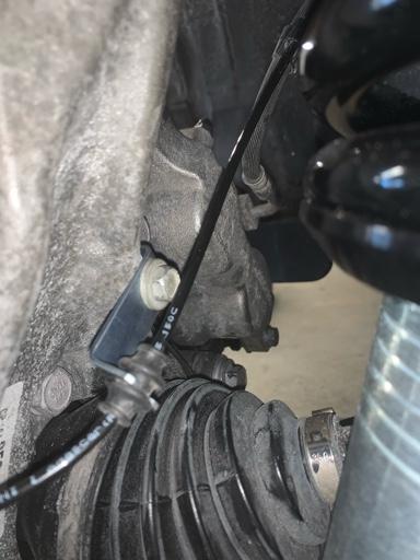

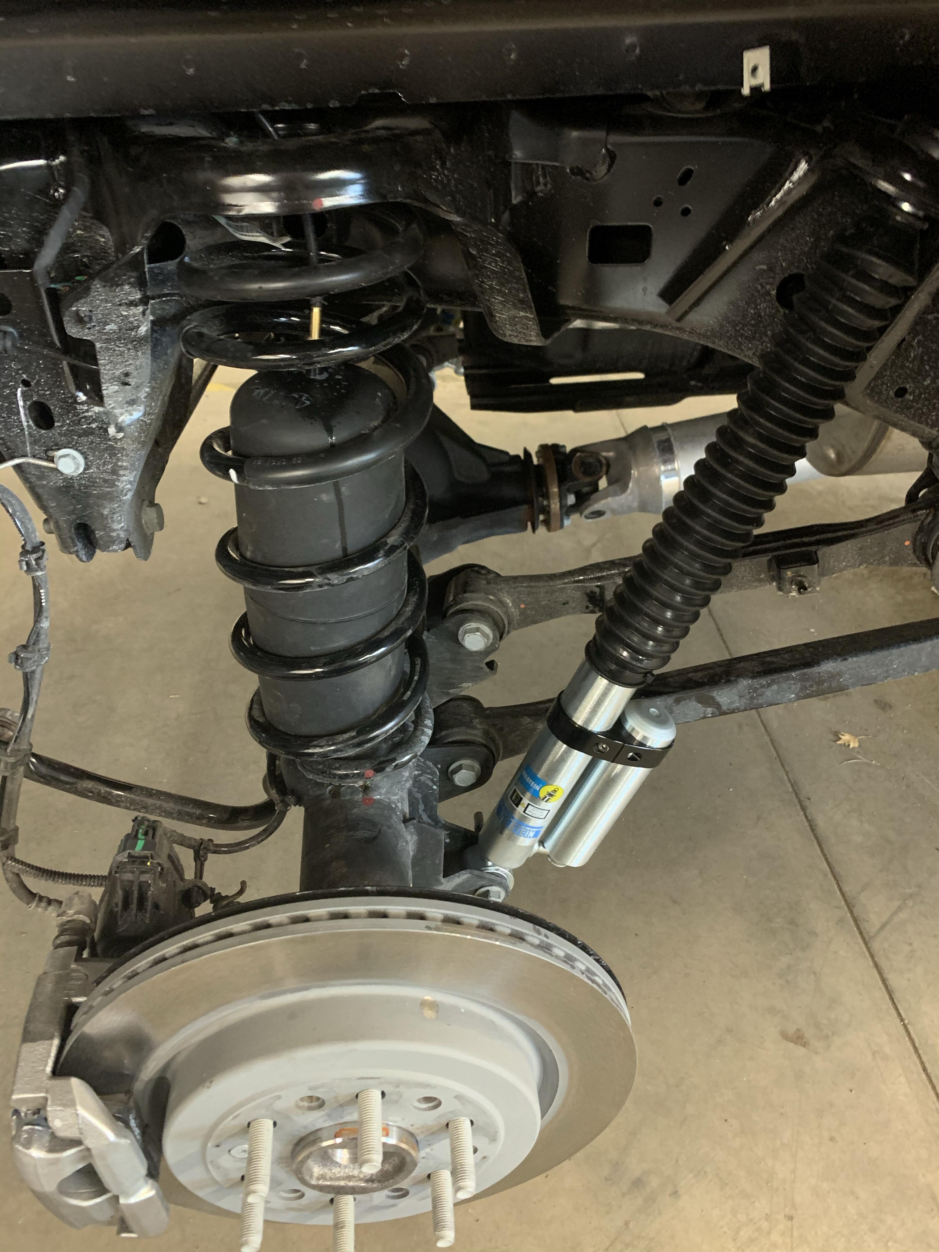

Started installing the Bilstein 6112 and 5160’s. 720 Km.
Fronts are done, LR still needs to be installed.

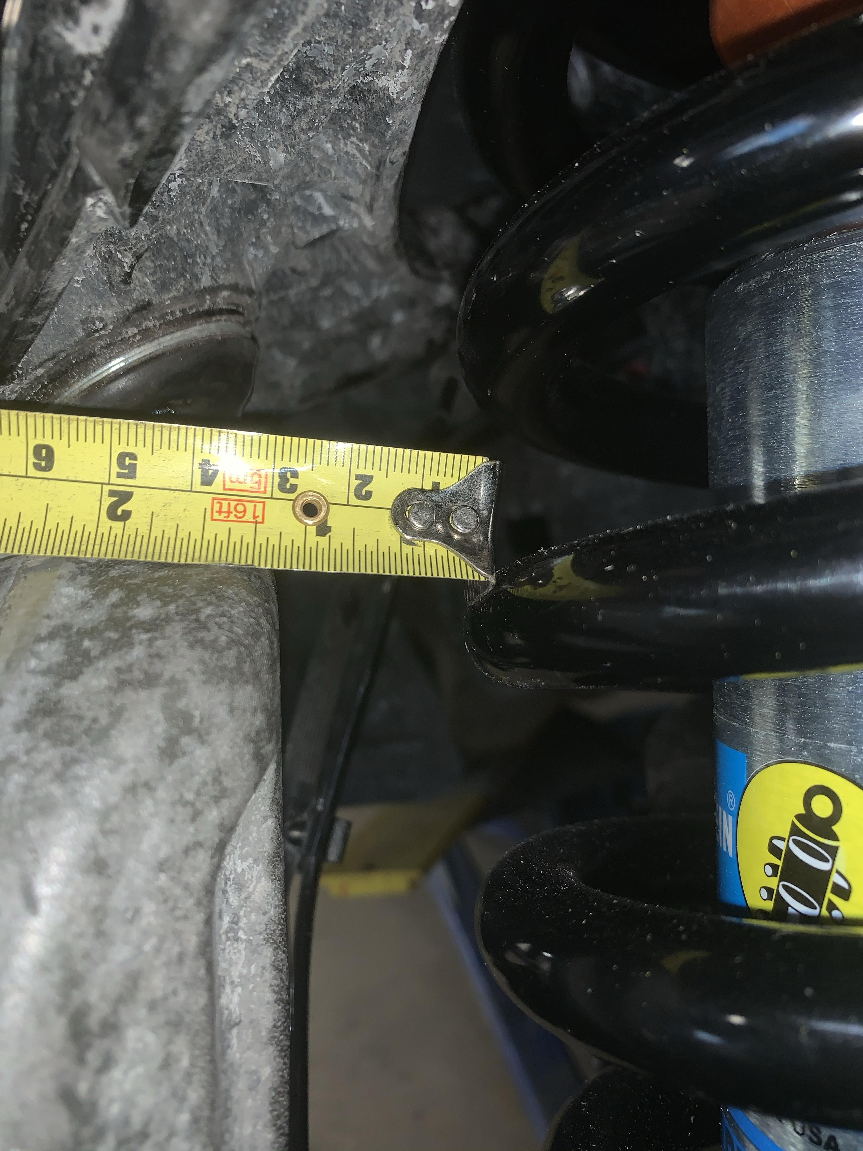

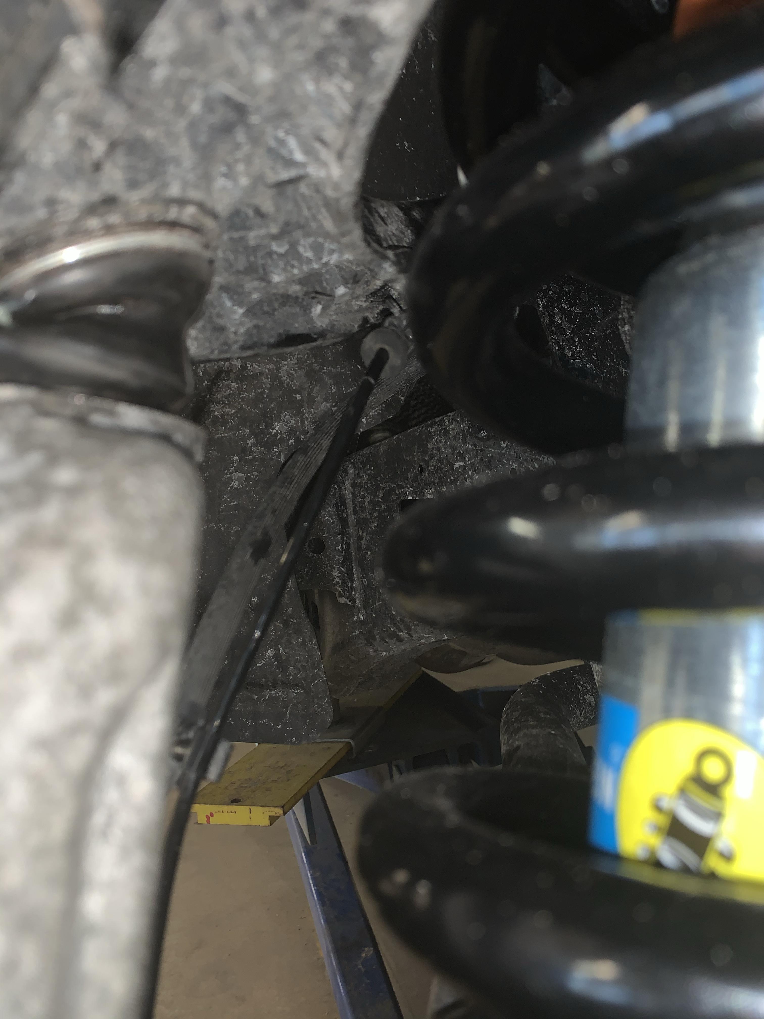

How close is the control arm to the spring?
I’ll take a closer look tomorrow and get a measurement and photo but I’m sure there was decent clearance... I’m also going to play with the ABS line a little more as it seems to be a little tighter than I would prefer
The extra bracket they supplied to relocate the ABS line didn't help much?? I was wondering about that. It doesn't move it very much when relocated.
Used clip 7, lift was as spec in the install manual. Still have 1/2” or so of rake.
Very please with the ride, slightly stuffed up front but very good (of course I have not been on a gravel road or anything yet.
Airlift installed.
