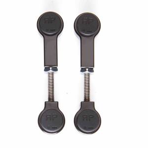

I put the daystar leaving kit along with the links on my 2021 Ram 1500 limited W/air ride. Sitting at “normal” ride mode my front fenders are 40inch from the ground with 35s. With only the 35s I sat at 37in. I adjusted the links a little bit to level the truck out. My whole truck sits at 40in from the ground to the center of the fender. I can still use off road 1 and 2. Not a bad kit and pretty easy to install.

I paid about 400$ for the spacers, front and rear links. I didn’t even add the rear links. So i dont know if You need them. If you want to maintain all functions of the air ride I don’t see how you could use them. They trick the computer into thinking your truck is sitting lower so it adds air to the strut to raise it. You will lose off road settings if you do that because you will cause a over inflate/high pressure warning in the bag.

I have a 2020 limited with air ride, can I just level the truck with just the spacers ?? Or I still need the links for that, I just wanna level it I don't want to lift it.
db252
Dec 20, 2020
170
181
Nashville, TN
You’ll still need the front links. The stock links are non adjustable and adding the spacers require you to change the link length so the truck believes it’s at the same height making all settings function normally.
