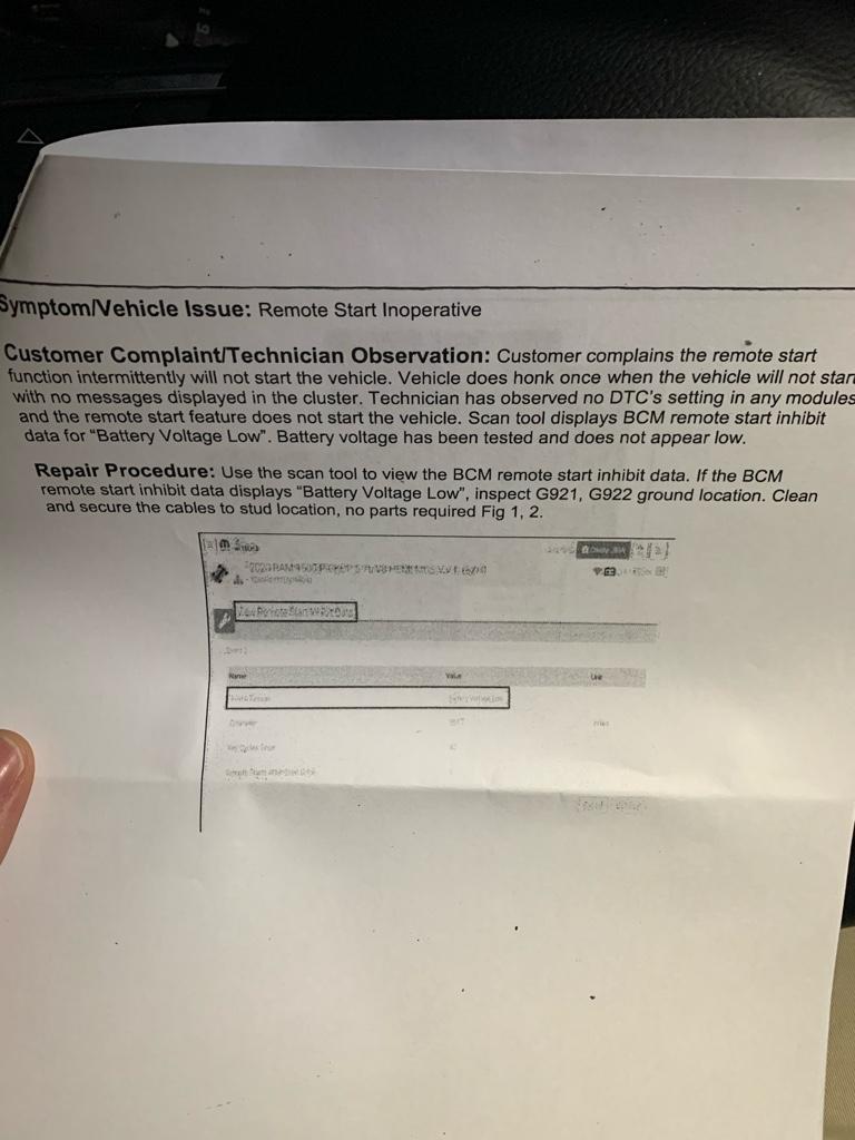

Well I got it back from the dealer this afternoon and so far so good, only time will tell though but I’m hopeful. They found a Star case S2008000105 that covered symptoms like mine and instructed them to inspect grounds G921 and G922. Clean them and secure the cables to the stud location. So for those who suggested grounding... it would appear you may have been right. Service tech gave me a copy of the info in the Star case so I will attach it below for anyone else dealing with the same issue in the future. Hopefully I never have to reply to this thread again.
