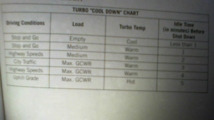

Did you get it hot? Diesels (really any engine) aren't supposed to be shut off immediately if you've been putting them under a lot of load, and there are obviously certain cycles where it needs to do a DPF regen, etc. Are you sure it didn't put a message on the screen? Here's the cool down chart for reference - I'm wondering if the ECU was just waiting for the engine to cool down.
