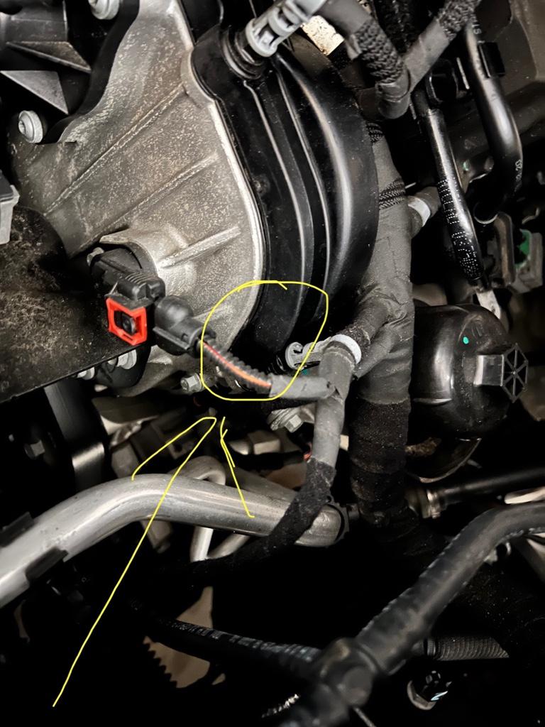

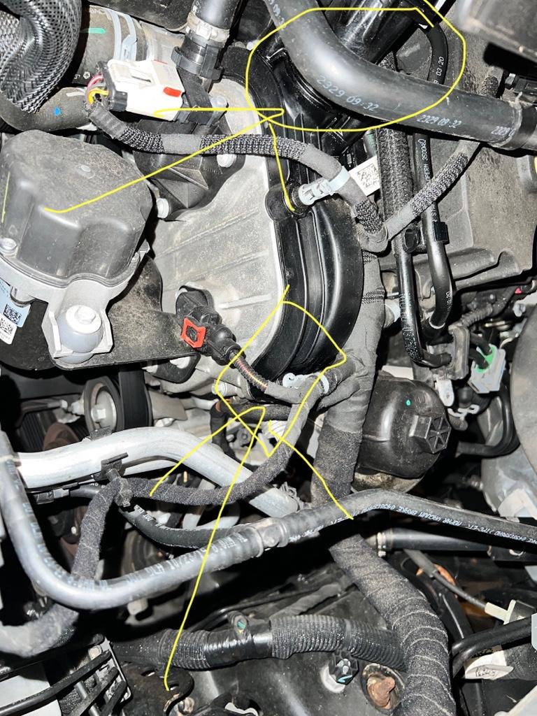

I noticed oil around oil-filler cap/tube even though it was snug tight. Further saw a small area on engine cover - took to dealer and they “wiped it with a rag” - and advised to come back at next oil chabge - which I do at dealers every 7500 miles. No towing - easy highway miles. Really baby the truck - garaged at home and at work.
Truck has 33003 miles. Pictures below - is repair big ? Doe they need to disassemble the engine ?
Any thoughts or suggestions ? I am nearing my 3/36K warranty but this should be covered under power train as well. 2020 Ecodiesel Longhorn.

In a lot of cases they won't warranty it unless it's actually dripping. In both cases (2020 Ram and 2021 Jeep) mine actually made drips off of the oil pan bolts as the oil ran down the engine.
Yes it's a big job. They've got to take off the engine cover, foam blocks, injector rail/lines, injectors, valve covers, etc. just to get down to where they can start working on the cover. Sometimes they run into issues like injectors that are frozen up in the head, etc. It's a real PITA that VM can't figure out how to seal up an engine from the factory. Typical Euro garbage quality.
