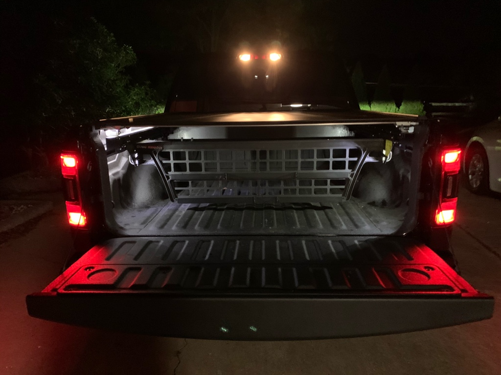

You have to T tap the lines behind the light module on the right side of the bed and find a place to mount an automotive relay. Then you attach the wires so that the relay switches to the on position when the lights turn on. Then simply run your wiring up through the rear of the bed to a hole and attach to the lights of your choice. It is really nice to be able to see better under the tonneau cover and it also turns on and off when you lock/unlock with the OEM lights or when you ores the button in the bed.

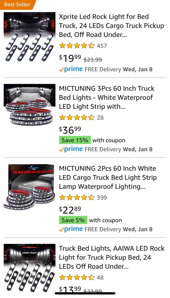

A lesson learned: the regular outdoor LED strip lights will work but running them in series with one another (under the drivers, front and passengers side bed rails) proved difficult. The points where you solder and connect them become brittle and break. Because of this only my additional drivers side bed lights still work. I am thinking about changing it out for some like these:
