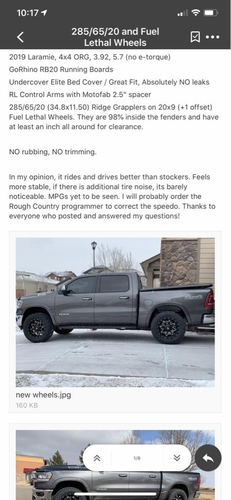

I’m planning on doing this setup. 285/65/20 nitto grapplers
That’s a sweet set up !! I love the one inch just past the fenders . Is yours air ride also? That’s my whole thing is having all the variables . That set up is perfect I think
