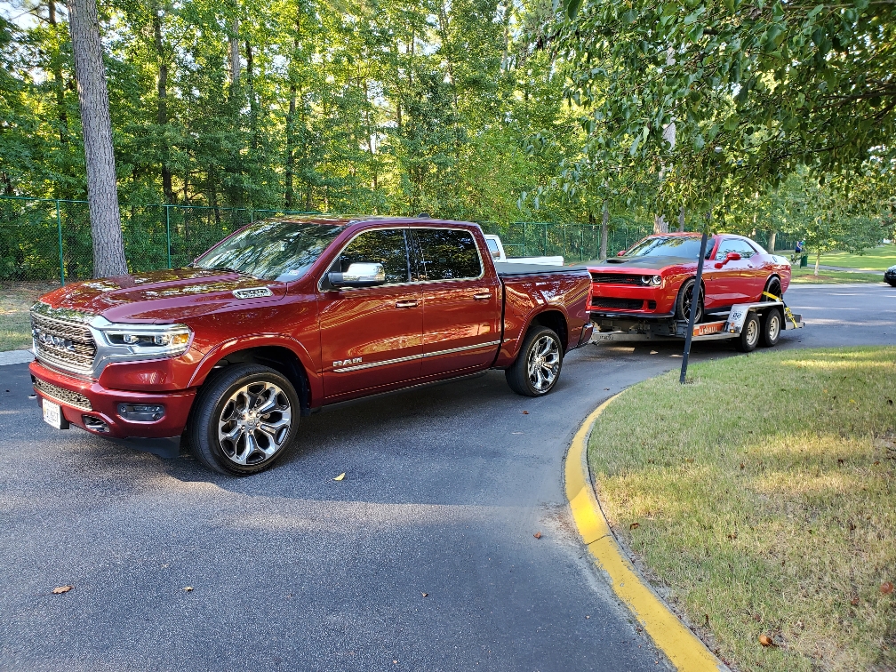

Interested towed my car and a trailer weight combined about 6500 lbs my truck in 8th gear I was say 95% of my whole trip i was really surprised. 2019 LIMITED 5.7 NonEtorque 392 gears.
Big difference in drag between a travel trailer and a car on a trailer
Sent from my Moto Z (2) using Tapatalk
Gotca I didn't even thing about that the amount of drag with a travel trailer.
