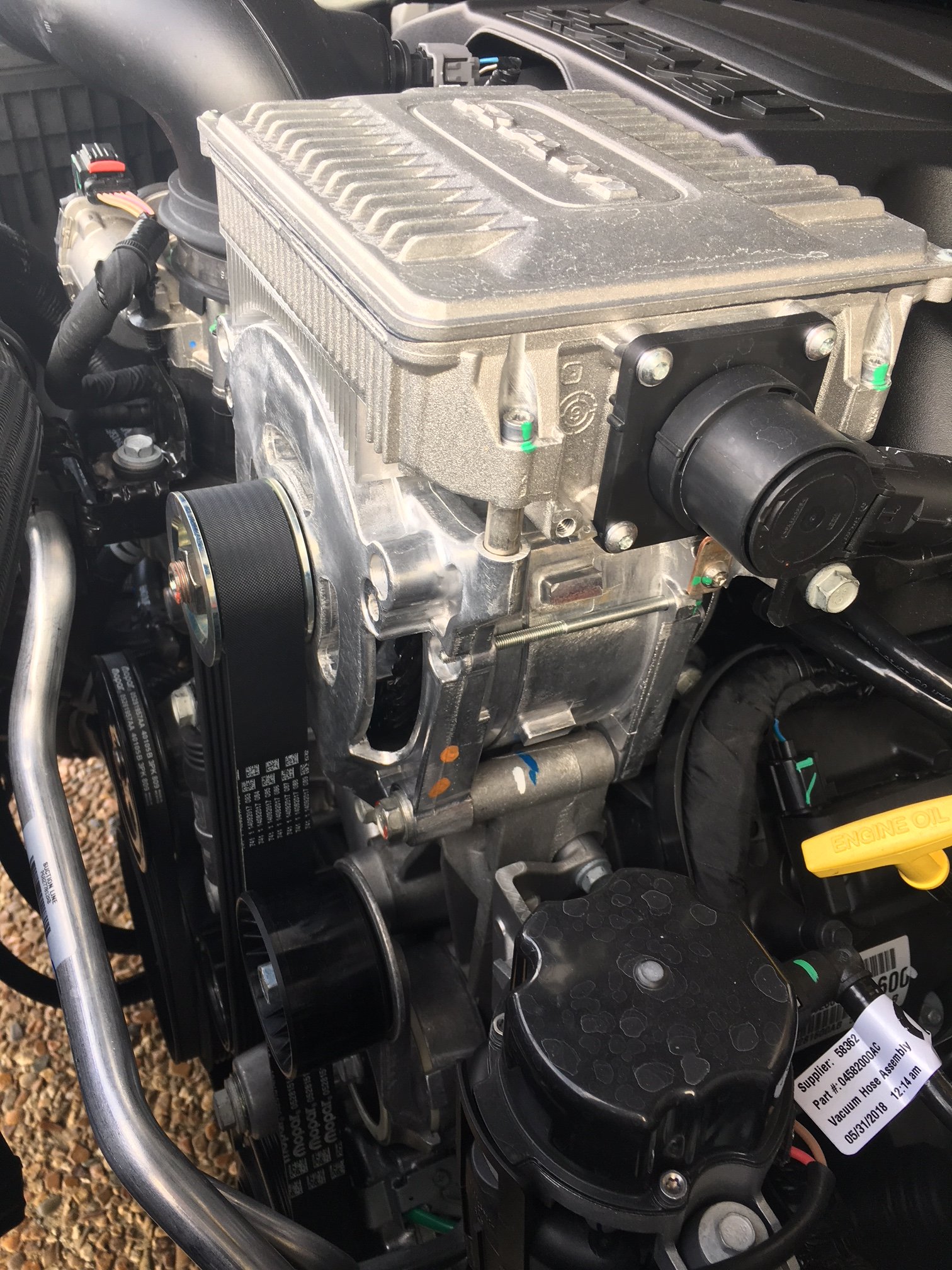

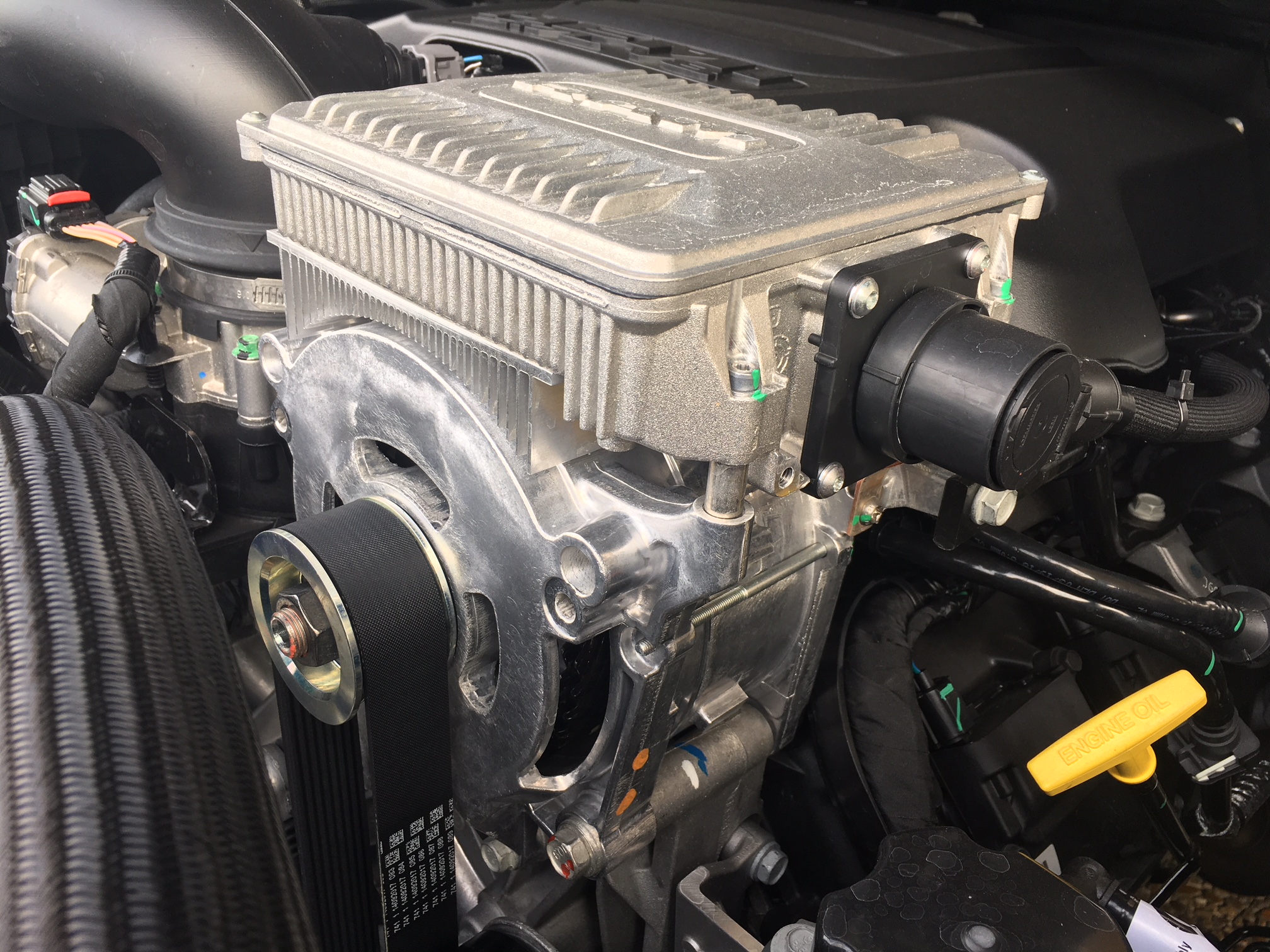

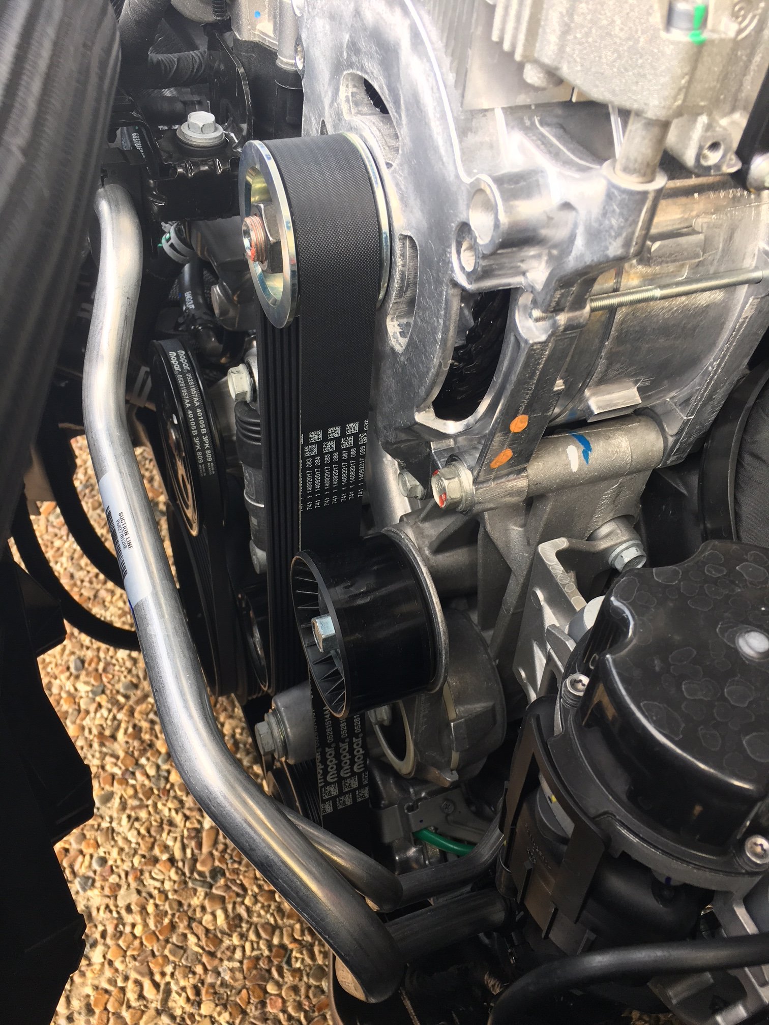

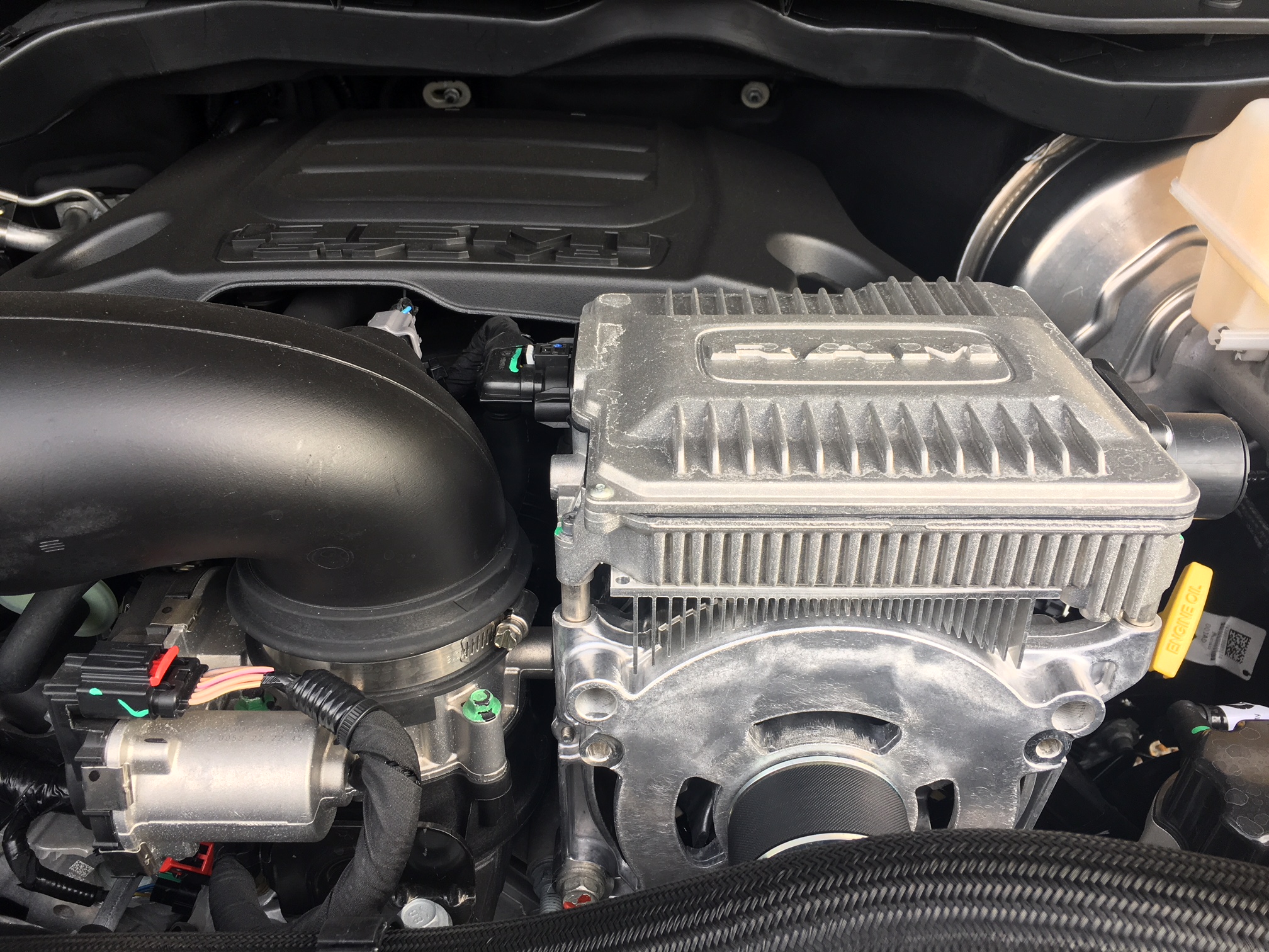

I believe these photos give us the best look yet at the serpentine belt and tensioner geometry. We also reached under the rear seatbacks to determine where the battery compartment is, but it is a tight fit and I didn’t go as far as to remove the rear seats to reach it (although we thought about it).
